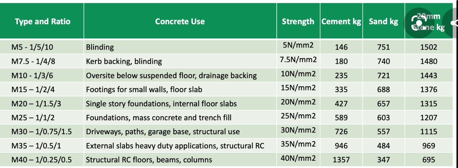

I was initially going to go with a 1:4 mix of ballast:cement, but judging by your replies so far it seems like an average would be around 1:6 ratio.
I did see quite a lot of charts on google saying basically a 1:1 ratio of ballast:cement to make it like a M40 mix which is basically C40 I think, which led to a bit of confusion...
I attached a picture for the type of chart I mean.
So with regards to the actual type of "high strength" cement I am using I guess I should just treat it like normal cement with normal cement ratios?

Thanks for your reply Mikey, well after hearing this I am glad I didn't fork out an extra £250 for the pre mixed C40!
