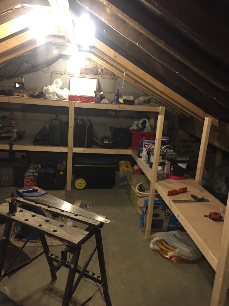

Hi there. Make your own racking. shelving system. 12mm plywood sheet. If you get at B and Q or some wood yard they will cut for free. Cut each piece into 2400mm by 400mm or 600mm Buy 38 x 68 cls timber and use to make the racking. You can adapt the shelf height at 2.4m legths or 1.2m lengths to make things simple. This is a shot of the racking i am building in the loft. I used 12mm MDF as it inside.

You're going short in the middle.
You can fit a much bigger shelving unit on that gable

He hasn't finished it yet so maybe he is.
And you could be more supportive and say it looks a good job rather than pulling the job apart

68mm is obtained by 18mm plywood + 50mm baton (2×2), required for good ventilation. (18+50=68)
1x2 is ok but in case of dampness they are simply not enough.

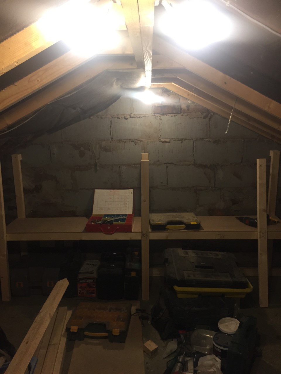

Above the top shelf in the triangle going to put up those louvre panels with the boxes. Started the right side shelves. Under top shelf will be hanging some Blum kitchen drawers on 4 x 2 rails.

Its working out cheaper and btter useage of the space i got. Plus all shelves etc tailored to my kit.
I see a workbench and a handsaw...
Are you cutting everything by hand?
If so, credit to you.
