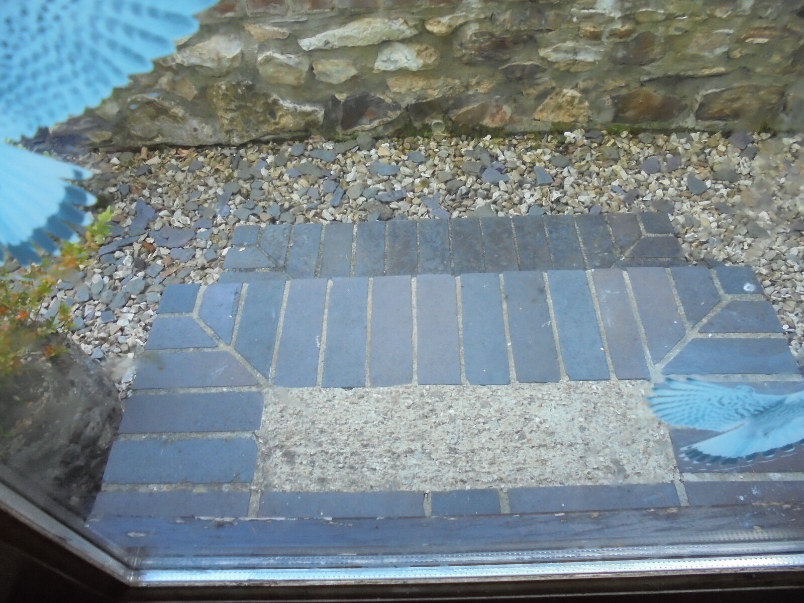

Hi All,
I'm looking to build a brick step using blue engineering bricks on edge as the tread. I'm wondering if this is the best solution though as I'm thinking they may get slippery in the winter. Also, not sure if it will look good or not! A slab for the tread has been ruled out as an option. Happy to recieve any thoughts on this

I did our step with blues on the outside and concrete in the centre for a bit of grip.
if you are concerned about Blues being slippery in winter, using them as edging will not solve the problem.
I do find engineering bricks a strong and attractive edging for pations and paths. I don't know if slipperyness is a problem. I suppose steps need the most caution. There are other dense paving bricks that are not as smooth. A slight fall should reduce the risk of water lying on the surface.

The edging and concrete in the centre works well with mine. Getting the correct fall helps as well. People normally put their feet more towards the centre of the step
What about combining them engineering block around the sides and block paving in the middle?
Many thanks for all the input...I'll go back to them and mention my concerns and offer some alternatives :)
