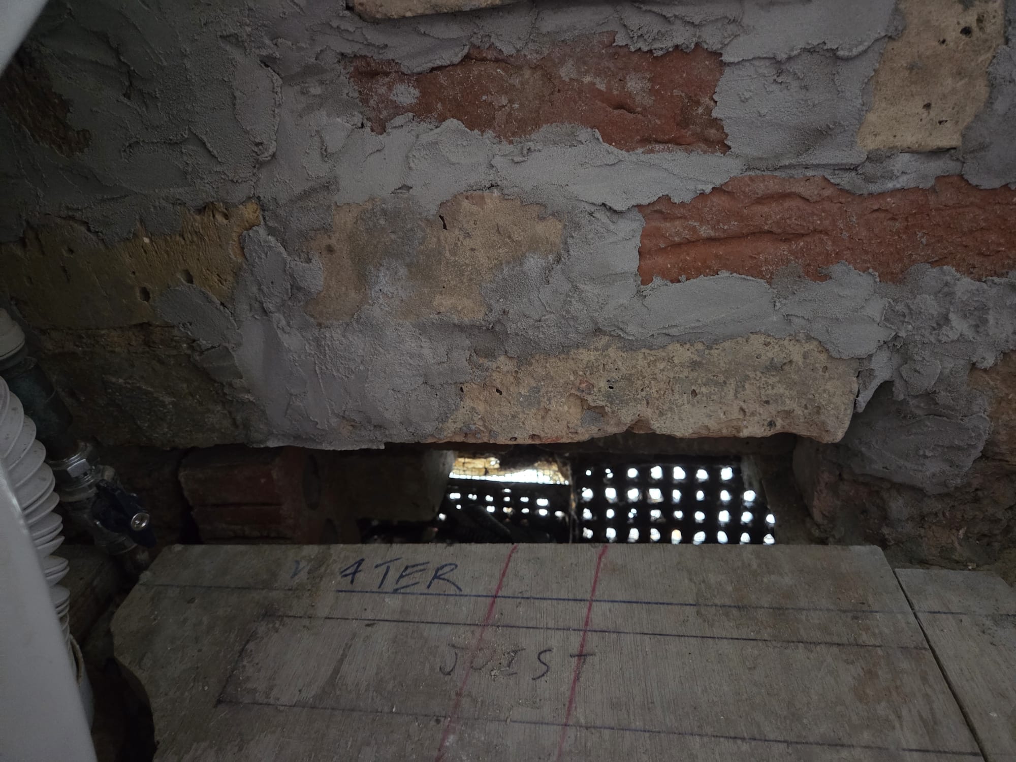

I have stripped the plaster from the external wall of my bathroom, and I am preparing it for tiling (using multiboard). This is on a 1930s standard brick wall with crumbly lime mortar in some spots.
There is a 42cm wide x 32cm high gap at the bottom of the brick wall. I believe it was intended for underfloor ventilation, as there's a nearby vent, and for running electrical cables. While cleaning the wall, some bricks above the gap came loose as the mortar was barely holding them in place. I used fresh mortar to secure them, but I'm still concerned they could come loose again and affect the wall structure, which could in turn cause the tiles to crack.
Any ideas on what I could use to make it hold up under the weight? Would a galvanised steel angle work to spread the weight and provide support? Or am I just overthinking this, and fresh mortar is good enough, given that it held up for a few decades before I stripped the wall?
