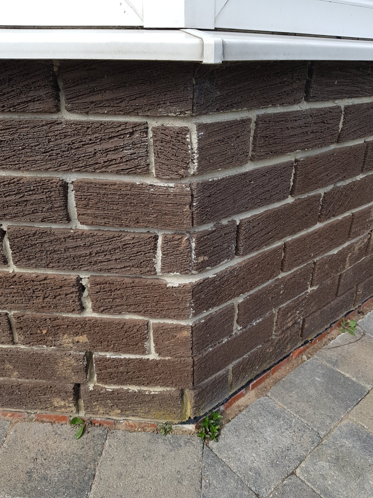

Hi everyone,
Please could you look at the brickwork on our conservatory and tell me if this is correct.
We are hoping to move and our buyers are getting a survey done on the property and I don't want any nasty surprises of anything getting flagged up.
Do you think this looks ok?
Thanks, Joanne

Thanks for your reply. The patio literally cost a small fortune. Would the paving slabs closest to the wall need to be removed and gravel put there instead?
looks fine to me.
It seems ot have engineering bricks below dpc.
distance from dpc down to external ground level should be 150mm ie 2 bricks in theory.
In practice as long as you havent got any damp issue, its not a problem.
The cavity should extend 3 bricks below dpc and if detailed correctly, the external brickwork above dpc should be isolated from the internal skin. -which should prevent damp issues anyway even if there is a lot of rain splashing above dpc.

It looks crap and also needs a bit of pointing, but probably nothing for a buyer to be concerned about.
I'm curious why you would single this relatively insignificant thing out of all the potential issues that a property may have.
We have literally done everything to the house since buying it with registered builders/tradesmen so I have confidence in that. We just have not touched the conservatory. That was there when we moved in. I think my inexperience is probably thinking this is a bigger job than what it actually is. I don't really know what a surveyor will look for. Just trying to rectify anything for the buyers too.
It could be made to look a bit better by raking out the joints and repointing. You could also blank out the bottom cross joint with dyed mortar and put a fake one in the correct place. Could also blank out the mitre joint.

If that's the worst there is I wouldn't bother doing a thing. The costs of doing anything to it won't be recouped in any sale price - neither will it affect the sale price in the first place.
