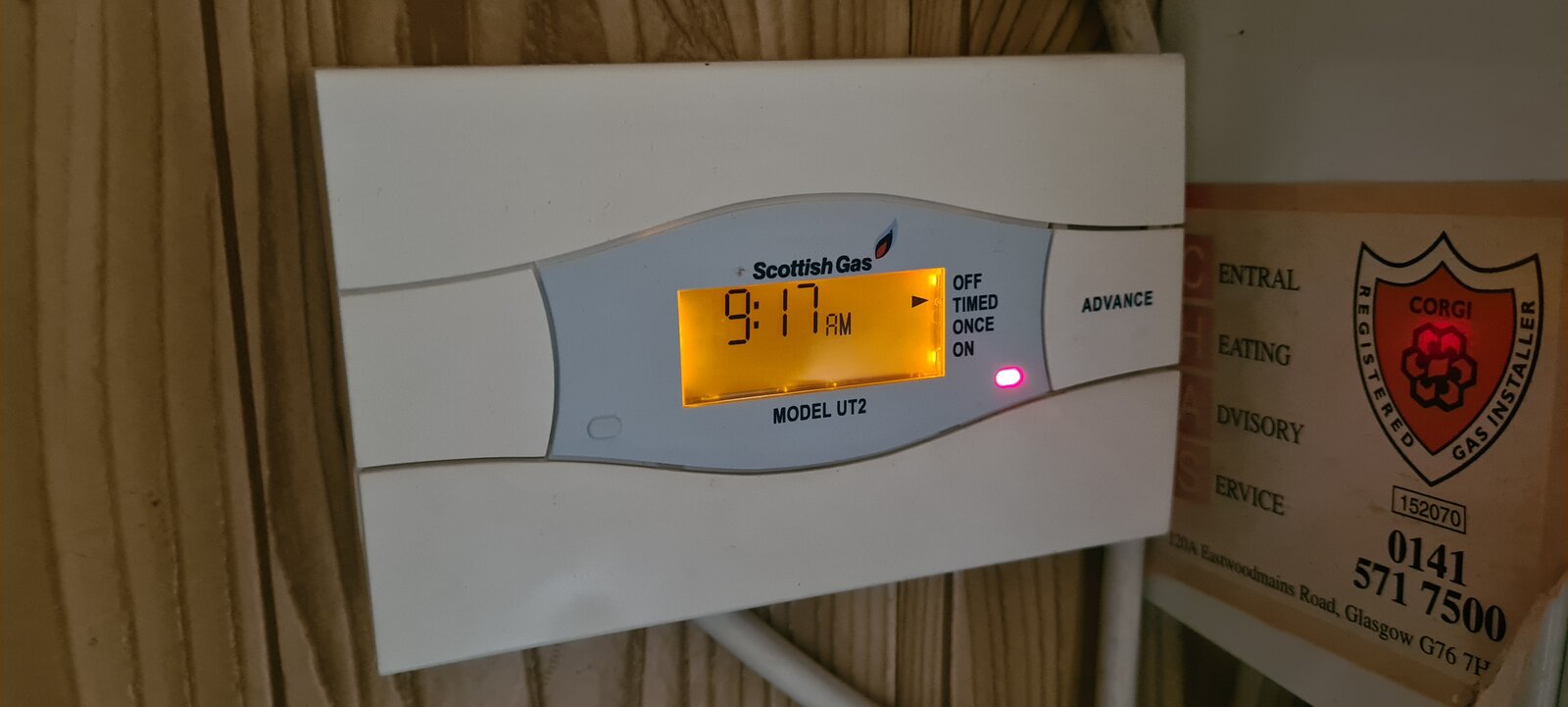

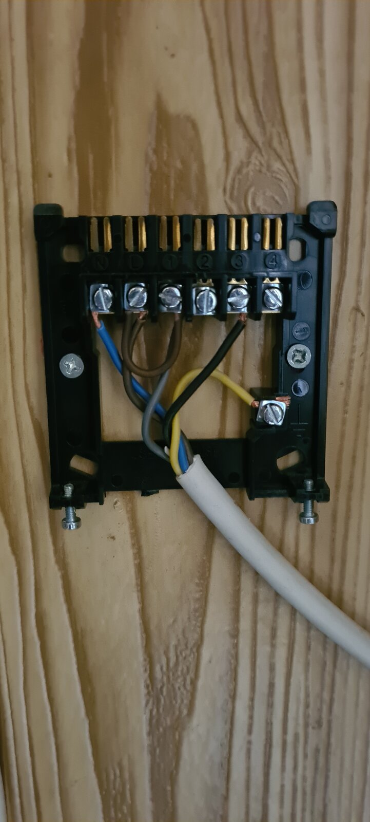

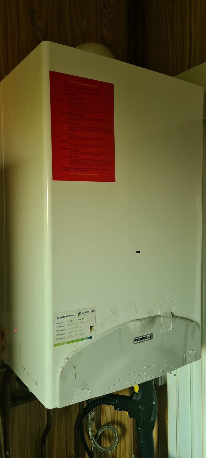

Hi folks,
The property we moved into has a British Gas UT2 Control Panel, no separate thermostat and a Ferroli combi boiler.
I'm looking to install something with a bit more than 3 daily programs. Any recommendations?
Can I fit a Nest Heat link?

Hi,
That looks just like the Modena 80e I have.
And yes, I attached the heat link directly to the boiler, terminals 4 and 5 in the electrical box.
See page 20 & 21 in the attached.
The boiler cover is not part of the room sealing of the system.
