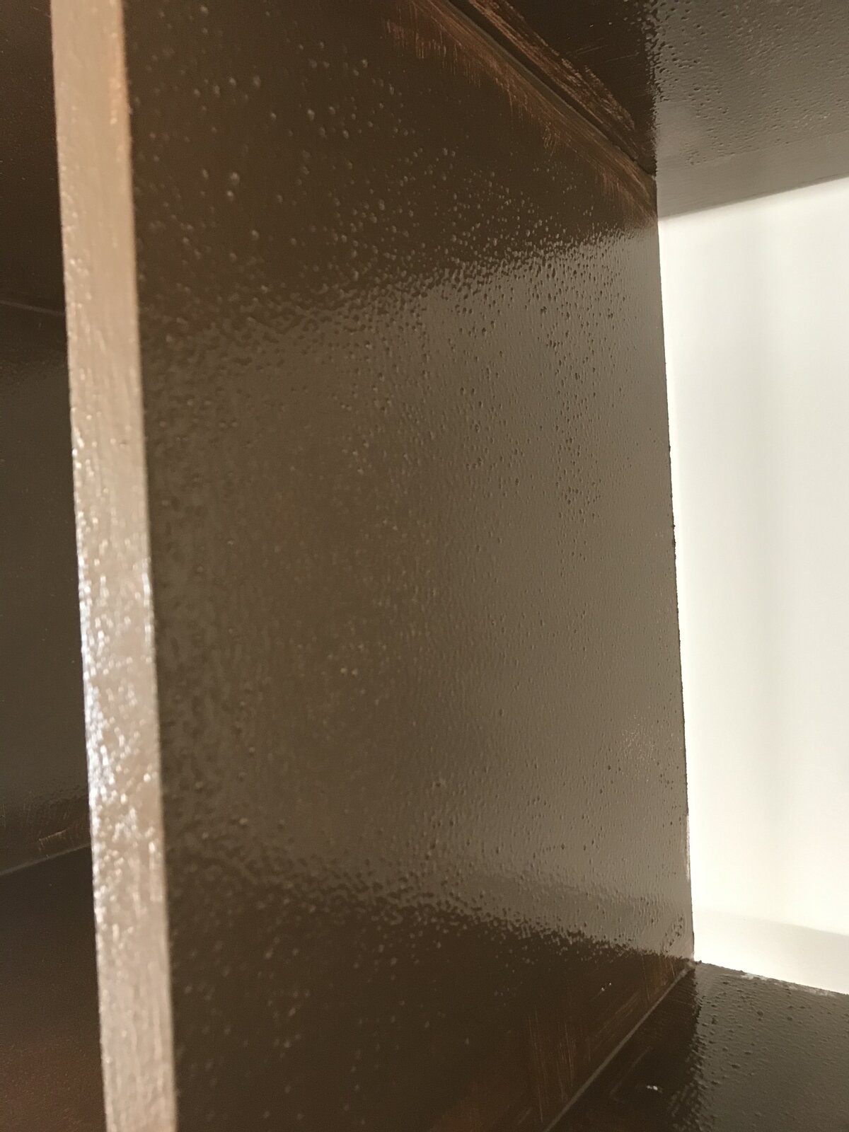

I am applying a top coat to my MDF bookcase. This has had 2 coats of MDF primer.
I have a Valspar Satin mixed colour for my top coat. When I apply this with a foam roller (exact approach I used for 2 coats of the primer), I am getting lots of small bubbles.
Applying with brush doesn’t cause this issue.
I don’t want to go any further until I know what’s going on.
Can you please advise as I am now downing tools
Can someone advise on this please? I am reluctant to brush as it will take long and compromise the finish.
The foam roller is the cause of the problem. As you roll it over the surface it "injects" bubbles in to the paint. If you were painting coloured water the bubbles would burst instantly and not be noticeable.

Those rollers made a huge difference. Night and day!
No bubbles and an awesome finish. Really appreciate the advice

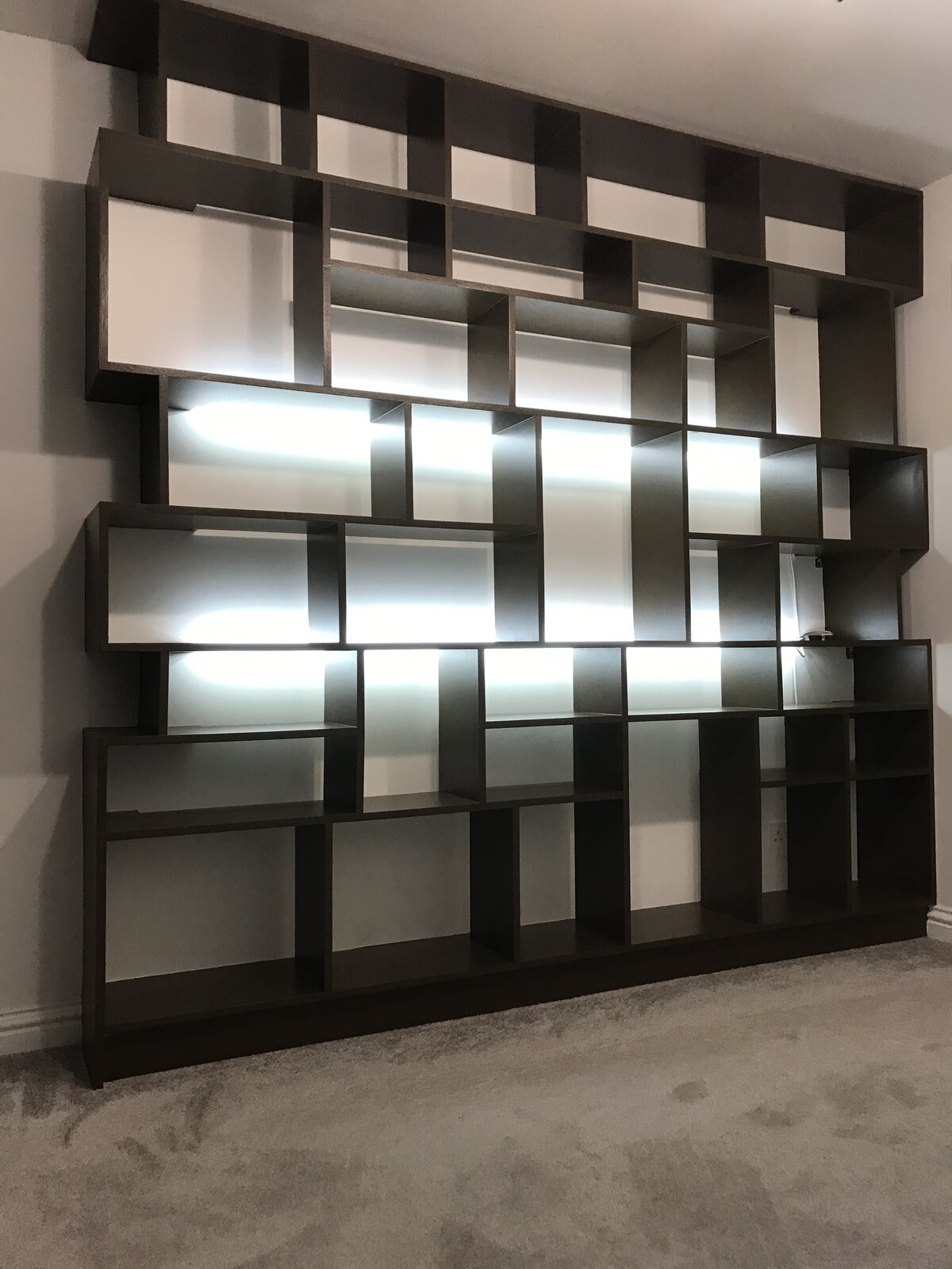

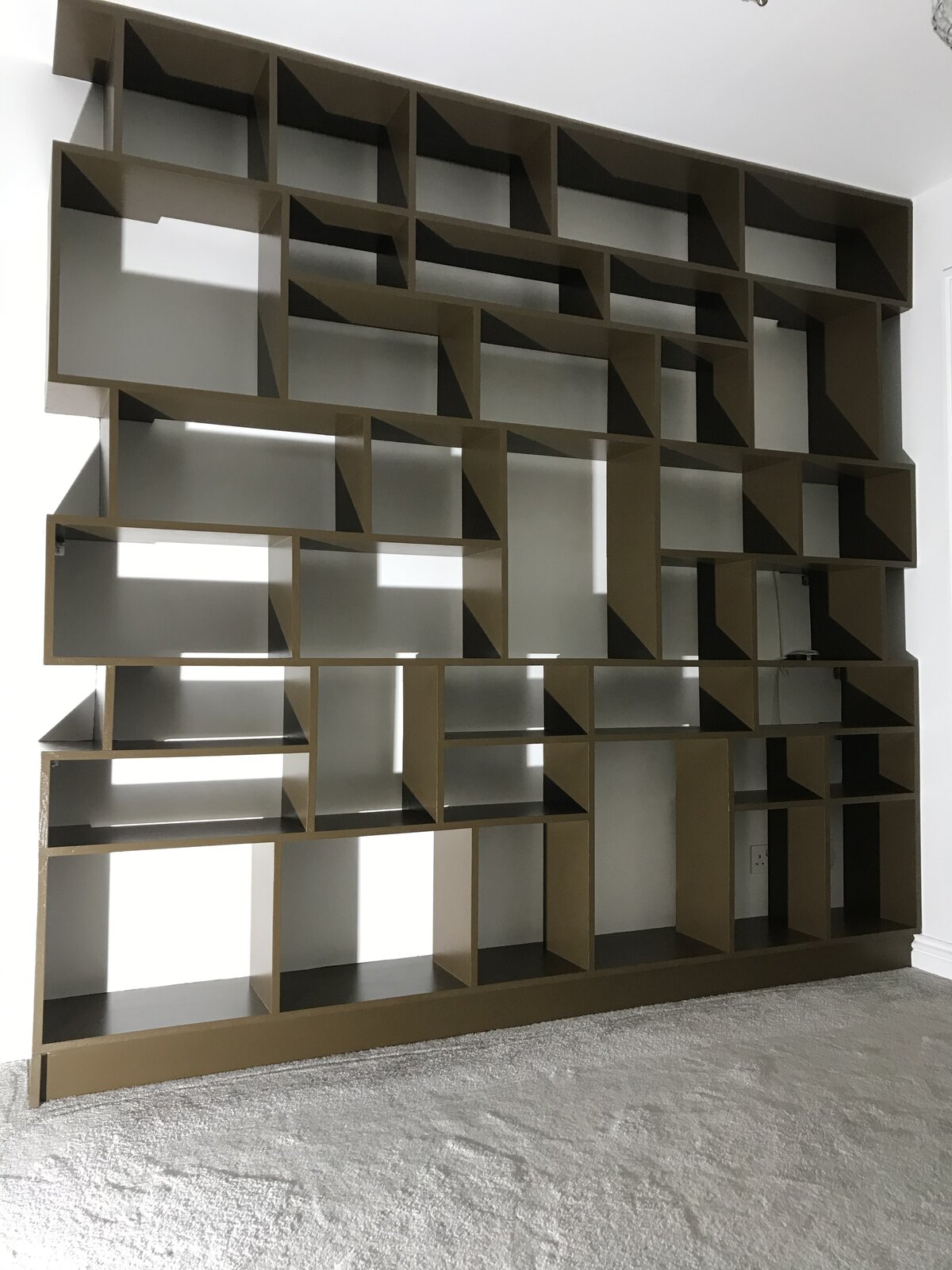

UPDATE: Thanks for your help with this guys. Finished up this evening and really happy with the finish. The suggested roller made an enormous difference.
