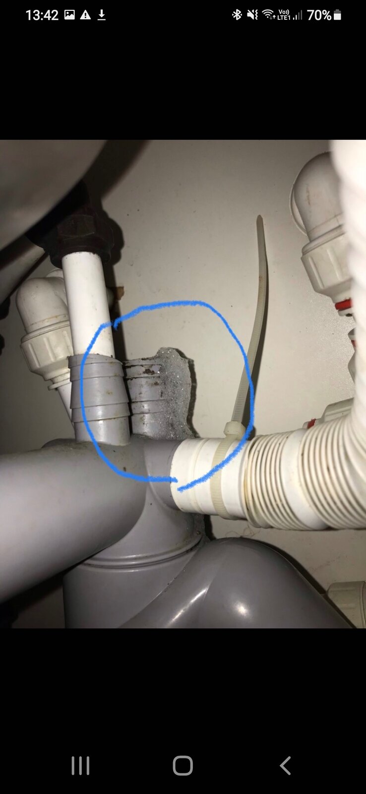

Hi, I have bubbles coming from my sink waste, it looks like there nay be a while where a washing machine waste would normally go?
There's also a slight gap round a tube that goes in to another hole next to it.
I guess I can fill that with plumber mait?
Not sure what to do with the other though apart from a rubber bung of some sort to block it up?
What's best please?
That's a right horror, isn't it.....a McAlpine waste is so much better quality.
Anyway, I guess the left pipe is your boiler condensate, and your bubbles are from a dishwasher / washing machine connection. Seal them up with a bung and silicone.
