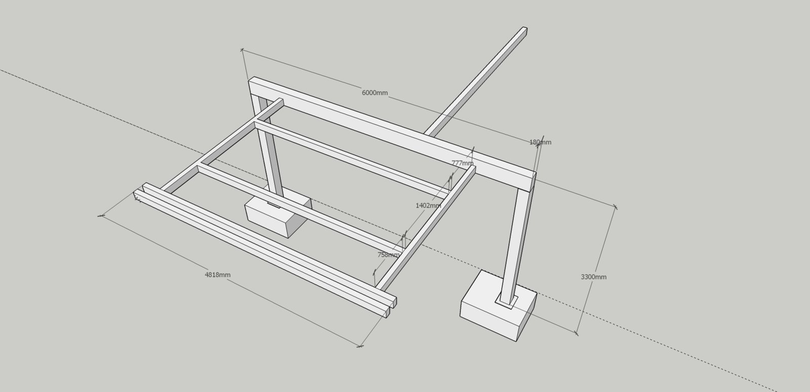

I’ve currently been let down by a steel supplier after they have quoted for steels and are no longer honouring their price and delaying the delivery of the steels
The builders unfortunately are unable to continue building the inner leaf of the extension as they need to tie the blocks onto the steels.
Does anyone know if they can put the blockwork up first and then retrospectively tie the blocks to the steel once the steels arrive later?
SE didn’t provide a drawing that shows how the Steel is tied into the blocks. He mentioned it’s up to the builder.
Builder says he was going to bolt a wall starter to the steel and build off that.

Sorry, I don’t understand? If wall starter kit goes in, is the blockwork not tied in?
A wall starter would normally fix a new wall coming off an existing wall at 90 degrees.
So they should be frame ties off the column, how can they be fitted to the wall before the column? Sounds like your engineer is as daft as your builder.

So, your suggesting that frame ties should be used instead of a wall starter kit?
There are many different tie systems designed to retain masonry to steelwork that could be utilised but the steel needs to go in first as its the mortar that provides the tolerance between the masonry and the steel.
Wall starters are designed to provide some connection but it's a flexible connection so that the extension joined to the main building can move up and down on it's new foundations. Starters provide little restraint horizontally.
The stantion can go in afterwards if the wall can slot in to the web and be bolted through the flange. Otherwise it needs some horizontal strapping. But this will rely on the builders building the wall dead plumb, and I don't think they are capable of that.

Not ideal but how about building the inner skin but leaving it toothed out where it meets the steel. Then when the steel eventually goes in finish the blockwork.
It will be a PITA but better than stopping work for a couple of weeks until the steel arrives. Obviously if the steel is only going to be a couple of days late then probably not worth the hassle.

What we were thinking is build the inner leaf, and when the steels go in, fill the gap between steel and blockwork with mortar then bolt the steels into the blocks and use SBD to glue it in.
Are they special steels you are ordering, or steels with some special fabrication work?
I can get standard structual steel like UB, UC, equal angle, SHS etc in around 3 days. For EG, yesterday I ordered 2no equal angle 150 x150 x15 which are being delivered this afternoon.
B1 - 300x90x41 twin beam - 6m
B2 - 178x102x19 UB @ 2.9m
C1 - 203x203x46 UC @ 2960mm overall including bearing plate and capping plate.
B3 - 150x90x24 Twin PFC 100mm cavity. @ 4.7m
B4 - 2 of 152x89x16 @ 302mm
B5 - 2 of 152x89x16 @ 3.9m
I managed to find a place who says they can do it for Tuesday, but I’ve been let down once already....
