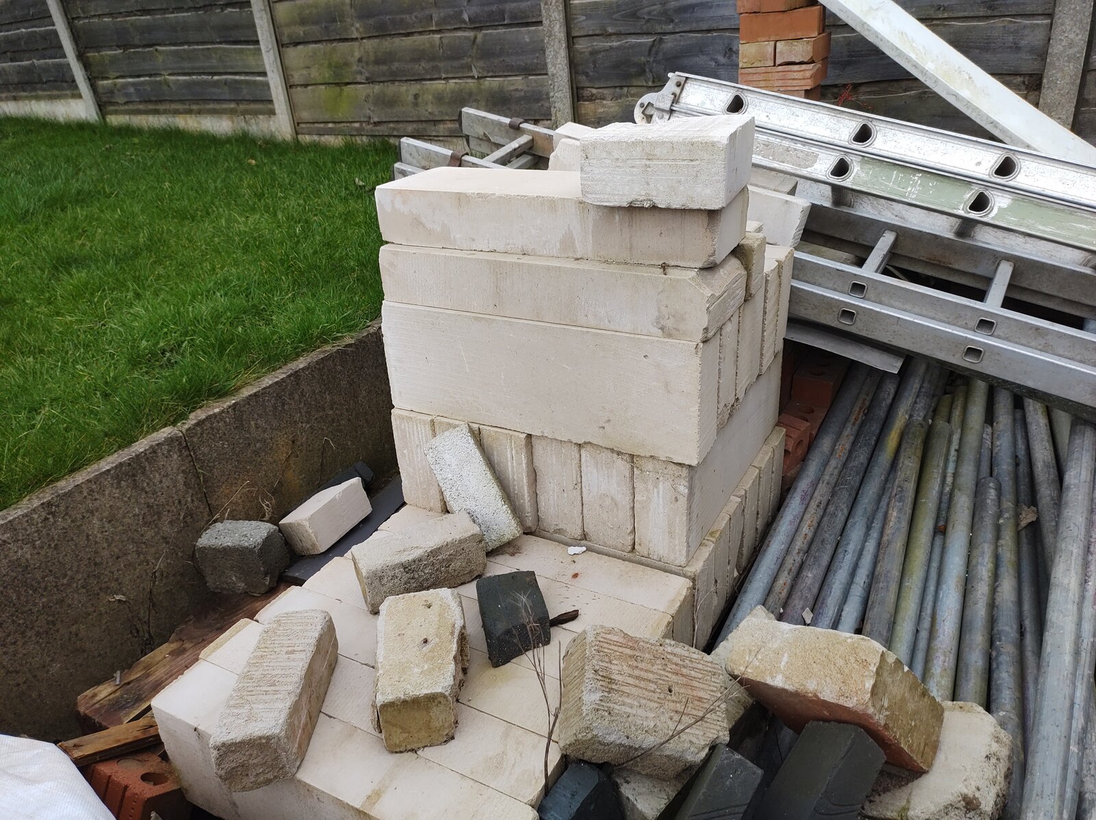

Correct if you turn the 9 upside down.
Very true. My excuse is I'm using those extra long ones at the moment:
