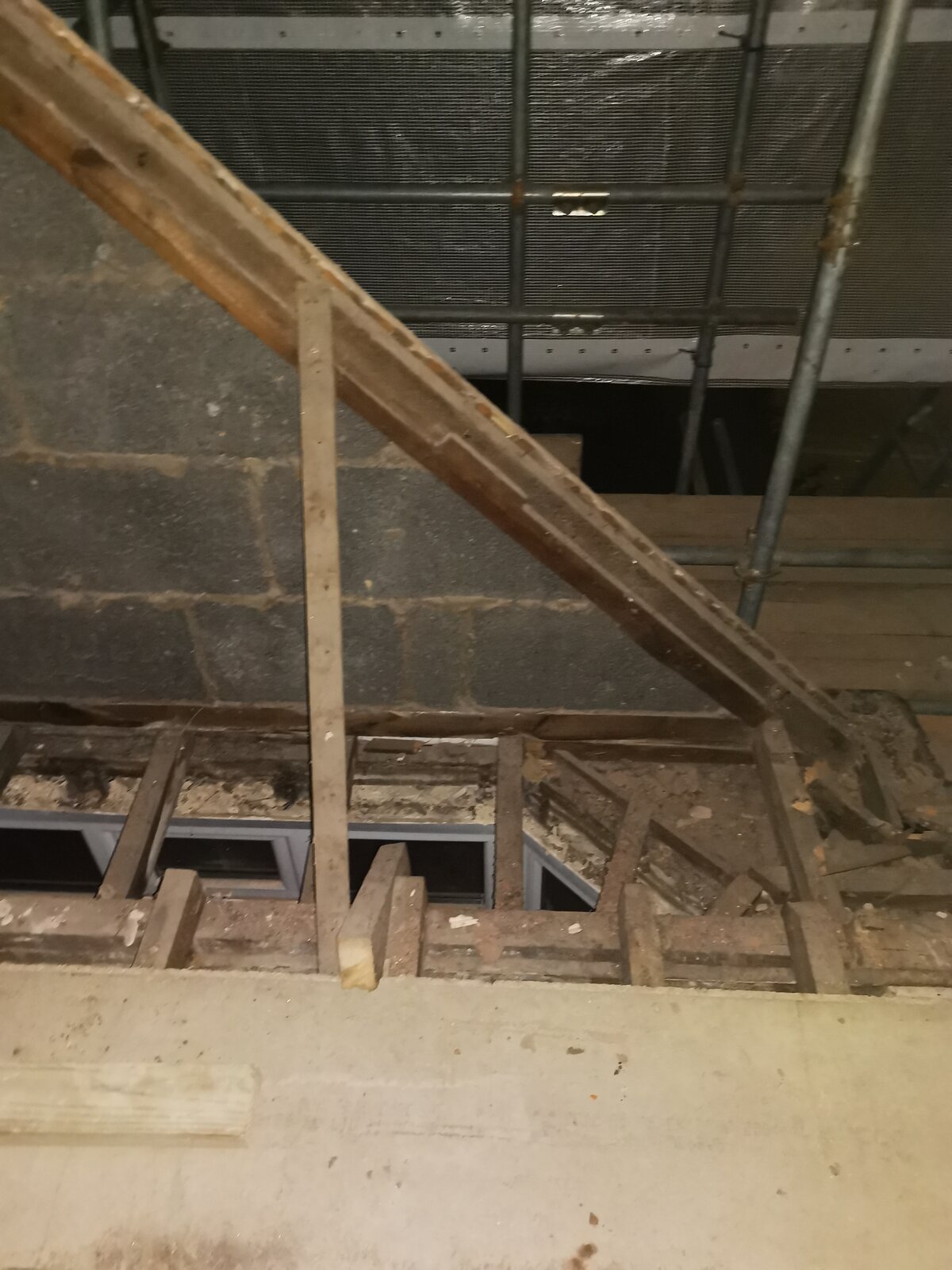

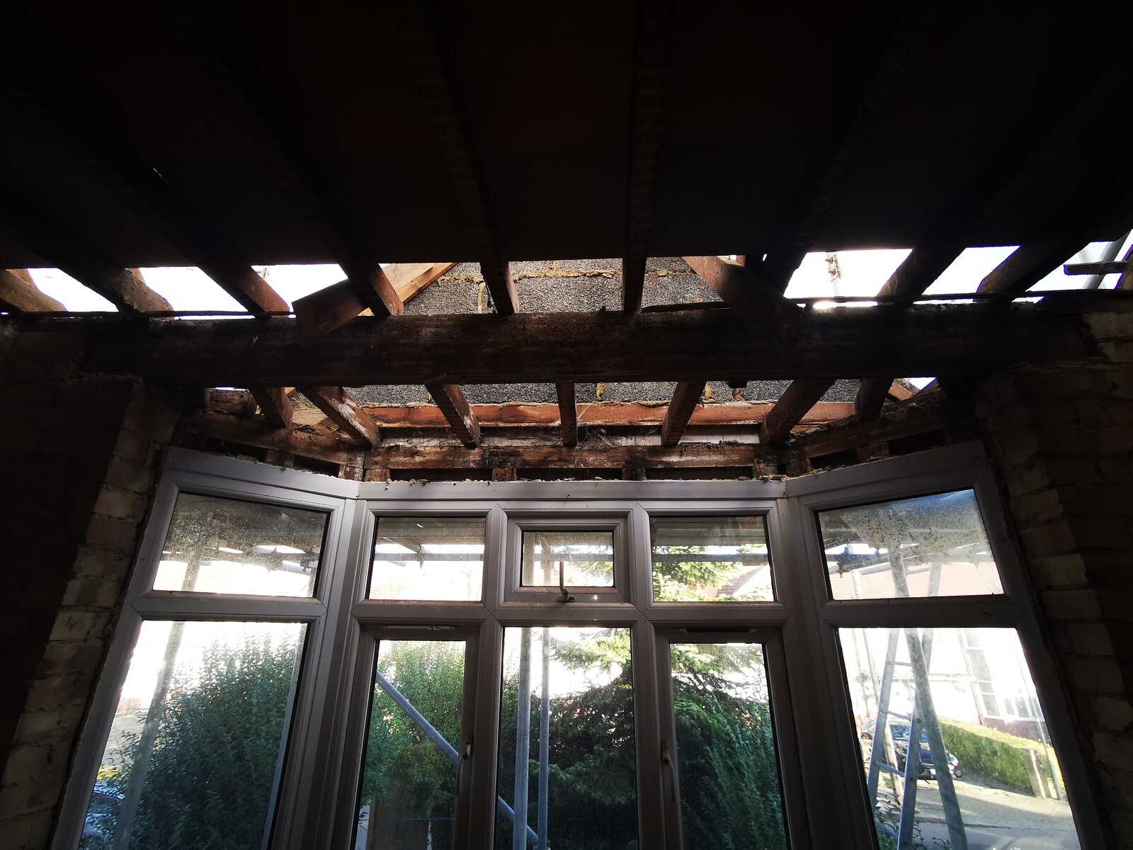

1. Lintels and existing timbers for roof arch are in bad condition. Contractually agreed to a dormer loft conversion with all construction material included.
Would this normally be expected for the contractor to cover and replace or can this be passed onto the client? The quote I'm getting from the contractor is extortionate!

If the builder was unaware of the rotted timbers then, in my opinion (and I am not a builder), he would be within his rights to re-cost the job.
However, being an 'experienced' builder he should have stated in his contract that, if defects were later found that would have a material impact on the construction then further costs would be advised before continuing with the contracted work. Additional costs to be agreed by both parties before said work commences.
What does the wording in your contract actually say?

The problem I have is they have the upper hand as payments are far in advance of work completed. 3 payments left for a project about 50% at best left. Saying warranty will not apply if I get a third party to do those bits. 1 stud wall for 4k? Replacing 4 window lintels in first floor for 4k? Replacing old ceiling joists for 4k? feel like they're taking advantage. But BCO said they do need replacing to me, but he seems very junior and seems to be trying to cover himself at the worry of going against what the builders point out...

Yes I signed a contract for a hip to gable dormer loft conversion and an extension with plastering and new plasterboard of the 1st floor ceilings.
I've been told the poor state of the roof arch timbers and lintels is not something that was included as its impossible to know without taking everything off..

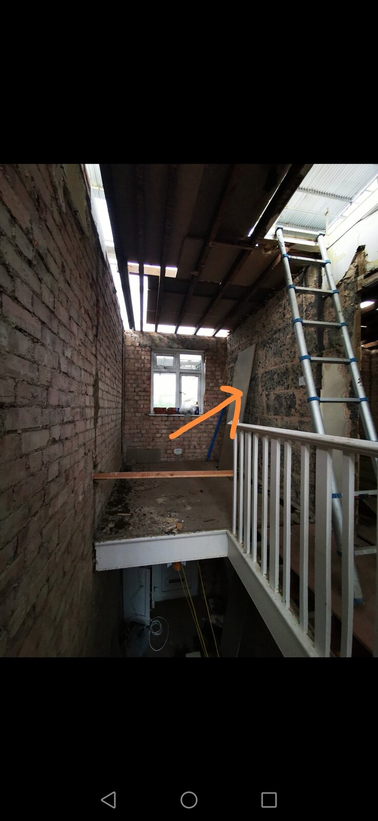

This wall is now unstable as a result of knocking the other wall to accomdate the stairs going to loft.
There's no question about it. It's old breeze block and now rocks if you push it .
But £4,000 for a stud wall replacement??

I'm tempted to push that breeze block, take it all away and DIY it myself! They're trying to catch me out with the warranty for the whole works but I'm arguing it should just apply to this aspect only. That seems fair, no?

1. Existing 1st floor ceiling joists
2. Unstable breeze block wall
3. Lintels on windows
Is he within his remit to reply that it is mandatory to replace and if so: does he need to provide some evidence for that?
