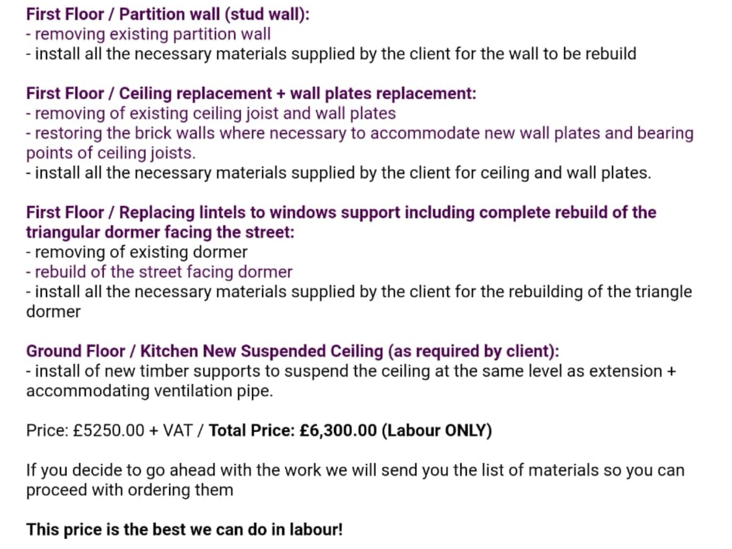

Thanks Woody,
Thankfully got a good outcome and BCO agreed that only stud wall is necessary.
I've since gone back to construction company and asked for final price for labour.
Thoughts on this? Fair or excessive
