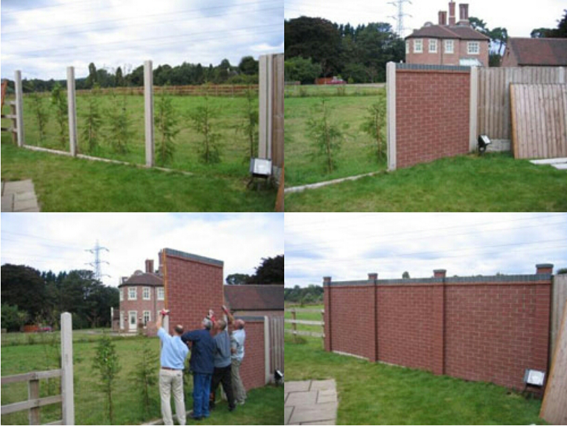

We have an old wooden fence looking a bit sorry for itself
I'd like to replace with a brick wall, 200h x 1140l x 21w (cm) between two houses on boundary.
Its quite long, and wicks reckons 1300 bricks, so may be quite costly :-(
Never done this before, is it something a new starter should attempt?
What base will I need? Will I need supports?
Has anyone ever used a Bricky wall building tool?
Unless the wall is very well sheltered it will need to be thicker at the base than 21cm. You shouldn't really go more than 1.5m at 21cm wide.
I just want to say its not as easy as it looks and you really should consider paying someone to lay them.
ive seen the bricky thing on tv, they look slow to use and im not convinced its as easy as they make it look either,
never used one though, but why would I when I am a brickie lol
Go back to Wickes and ask them if their tills underestimate prices too.
You'll need twice as many bricks for a wall that thick. Plus another 200-300 in the ground, plus concrete, plus sand and cement. So perhaps 3x as costly as you thought.
And you'll need four piers for strength, or steel reinforcement. Plus something to stand on for once you get past chest height. Finally, this will be a party fence wall, so strictly you'll need a Party Wall Agreement in place with the neighbour.
The Bricky is for building BBQs badly and messy only.

there are 120 bricks per m2 in a 9 inch brick wall, so a wall 2 metres high 11.5 metres long would be 2760 bricks not including bricks for piers. so probably
be looking at around 3000 bricks. foundation i would do a 450mm wide 225mm depth and 11.5 metre long trench needing 1.164 m3 in concrete.
plus sand, cement etc.
for wickes to say 1300 bricks needed i think what they have done is calculated for a 4 inch thick wall which would be 60 bricks per m2 which would give you 1380 bricks needed.
easi wall looks good, will investigate. i've been quoted upto 8K +vat!!
