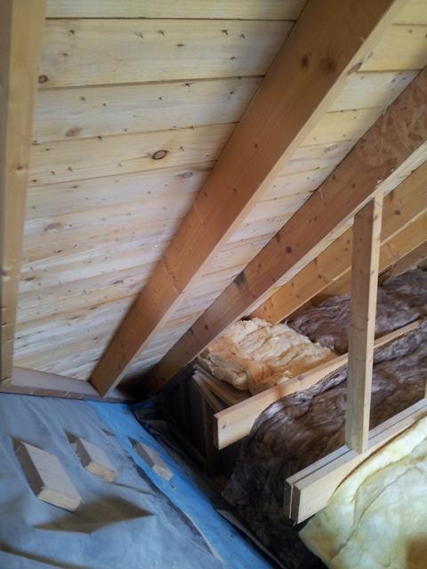

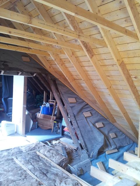

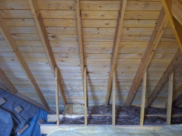

Okay, I've just had a proper look in the loft, and it seems the rafters we have actually in place are measuring 45x160@600ctrs, where the drawings says 50x200@400ctrs.
If you let us know the length of the rafter between supports, and the length on plan (or the roof pitch) we can give you an idea as to whether they will be acceptible...although it doesn't sound good...
The ridge is slightly nearest the back of the house than the front so the longest span is at to the front.
45 degree pitch with what looks like about 13-14ft horizontally from ridge to front wall. Can't actually see where rafters bear on wallhead as there is an inlay on the front. (ie building is 1&3/4 storey at the front.)
though it looks like it would be well strong enough to take the loads on it, whether it meets regulation loads I'm really not sure.
If it doesn't meet regs then it doesn't meet regs and if it needs fixed then it needs fixed. I'm just struggling to work out how to bring in additional rafters at this stage without major disruption. (we have just finished decorating the room directly below.) our budget for this extension is pretty much wiped out now, though we might be able to scrape together another 1-2k if need be, but that would have to get us back to the fully decorated state we are in Just now!
If it makes any difference, there are 50x100 vertical posts rising from floor joists meeting Rafter at around 8ft horizontally from ridge. So the 14ft Rafter span is not totally void of support.
14ft on horizontal is definitely too long for an unsupported length. However, if the joists are able to take the additional load from the rafters then you might get away with it. Depends on the size of the joists. Are they at 600mm centres as well, or are the posts supported on a sole plate of some description?
Give me the joist sizes, spans, and centres and I'll give you an idea.

Looks like the vertical ties bear down onto a double 50x200 joist. The span of this is approx 5.5m (excuse me mixing my metric and imperial!). They nail onto the SIDE of the rafter though, but I guess theres nothing stopping me putting in other vertical ties which brace directly underneath the rafter.
The joists pass their load onto the old granite wall of the house, and the timber structure supporting the new extension at the other end.

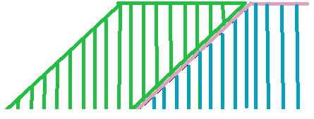

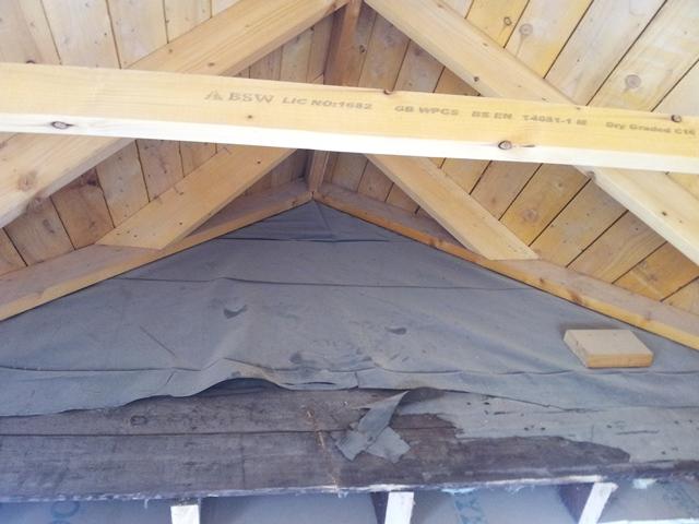

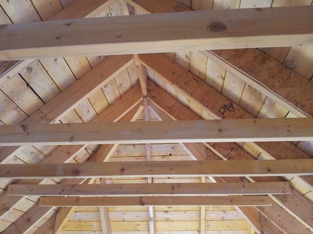

Just had a thought though. Most of these rafters are jack-rafters, so their span is going to be a fair bit less than 14ft. As you can see on the photo's, the roof is an extended hip, laid on top of an old hip, so there are jack rafters going from new hip to wall, a couple of full rafters, and then there are other rafters going from the lay rafter (on the old hip) UPWARDS to the new ridge. I guess bringing in additional of these upwards rafters should be easy enough as access should be no problem.
Hopefully the photo's will explain a little more.
Number of rafters above not accurate - but you get the idea.
also looks like one of those jack rafters (above) is a double. ie 2@45x160mm for some reason.
I think maybe I should measure each rafter individually and consider it's span and bearing points individually, rather than treating the whole roof the same. Guess it's out with the tape again in the morning then!
