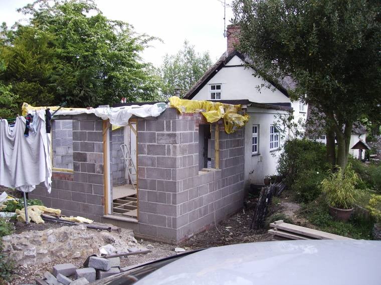

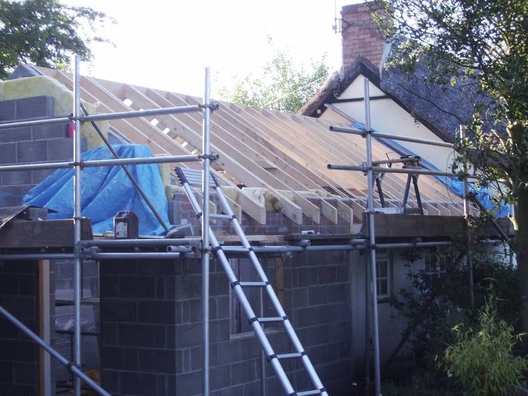

You would have been OK this summer. I took a chance when extending a flat roof extension and topping the lot with a pitched roof, but it only meant cutting the edges of the deck so I could get the rafters in. Once I had a few in I could tarp it.

Once the inner leaf is a block course or so above the flat roof, you can use a decent tarpaulin or DPM fitted around the four walls and angled to an opening left in the wall.
You would use a sheet big enough so that it is one piece when formed going through the wall and draped into a temporary rainwater hopper and down pipe, so that the outfall does not saturate the wall below.
