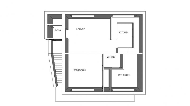

someone mentioned the toilet straight off the kitchen.. i take it that this is a no-no.. what's the rule regarding this then..
next question would be bout the floor..
what's the max span I can do block and beam flooring at?

No problem having a bog off a kitchen, you can span about 9m span at a push with B&B so I wouldn't worry about that.
Keep your walls to 300mm wide and for Gods sake start using Sketchup, free for the basic version, a peace of p*ss to use and a lot more fun!

now, another stupid question..

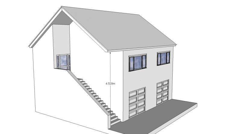

can you have a front door opening onto the top of a set of external steps? or do I need some sort of landing outside the door?
Edit: thinking about it more, its a bit of a moot point really as a new dwelling ought to have a level entrance with no steps unless ground conditions are so extreme that it is not possible, if stairs are unavoidable then the landing should be minimum 900mm.
rather unavoidable as this is a flat above a double garage.. :)
a re-think on the design from page 1..
external steps so it would be self contained without giving them access to my nice cars ( it's for visitors to my lottery house, or maybe staff..:) )
anyone got ( or a like to ) a guide for room sizes..
like minimum / confortable size for a single bedroom or family bathroom etc?
it's designed for a sloped site too.. ( back to front ) so the garage bit could be built part into a hill and the windows at the rear, one could be swapped for a set of doors and open onto the garden or a raised deck area..

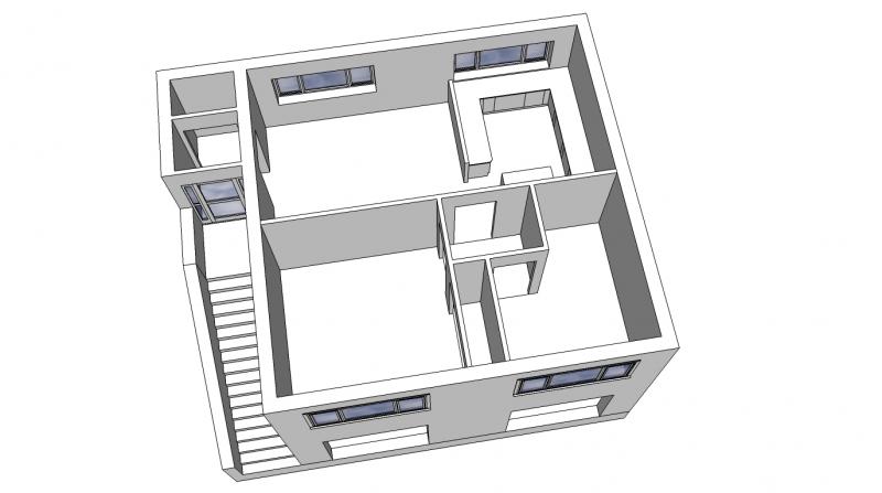

Access needs to be provided from the bedrooms into a protected compartment to allow escape in the event of a fire ie your bedrooms and living room need to be accessed off of a hallway which leads directly to the front door. he way you've drawn it the only way to escape from a fire should one occur in the kitchen or living room is through a window which on its own is not enough to satisfy the regs. That room in the bottom right, is that a bedroom or a bathroom? In any case you seem to have a lobby between it & the bedroom in the bottom left and the living room which is also a no-no.
PS if that is a bedroom in the bottom right where's the bathroom?
why is the lobby a no no? it's called a hallway and is in every single house I've ever been in. mine just happens to be square ish..
the egress windows are on the accessible side of the property and should there be a fire in the bedroom and lounge ( maybe from a setee catching fire and taking the bedroom wall with it ) then egress is into the lobby ( with door seperating it from kitchen / lounge area and into the bathroom where there will also be an egress window
there will be a fire detection and supression system fitted if it ever gets built ( ie sprinklers )
the front door does open onto a lobby then into the lounge..
the cupboard off the front door lobby will house a washer & dryer, and possibly the boiler ( solar / ground or air source heat pump, not gas.. )
how about if I make the front bedroom window open onto a balcony? that's fresh air :)
Ahh my bad I think you can get away without a protected escape route.
