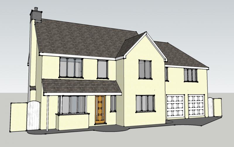

I like designing houses from time to time for fun ( hey we all have strange hobbies )..
what is the maximum thickness of outer wall that you can / should build?
is 600mm to deep? will the windows look funny?
is there any benefit to wider cavities with more insulation?
a little flat / double garage that I played around with..
View media item 10367 View media item 10368

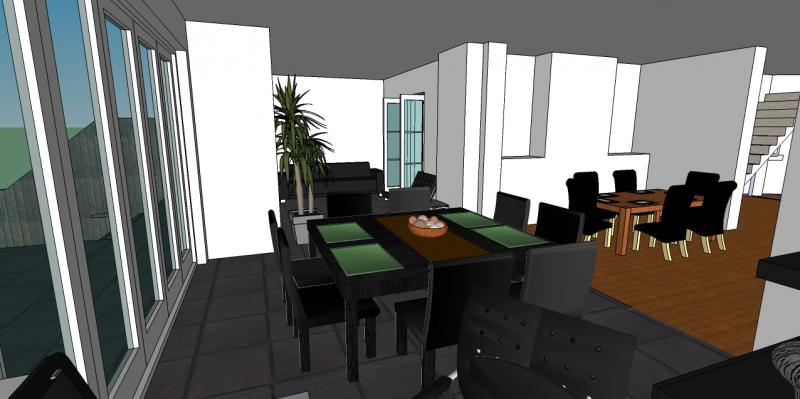

Hmmm , Bathroom straight off kitchen/dining room. only one door in between.
You may have a lot to learn there.

600mm is a lot wider than standard typical external walls*. Things to consider are window and door reveals and that cavities filled with insulation are subject to laws of diminishing returns!!!!
*Although it's not unknown to get solid stone 2 foot thick walls on old properties in the lakes and the like.

someone mentioned the toilet straight off the kitchen.. i take it that this is a no-no.. what's the rule regarding this then..

I'm re-planning the above as something to do to learn sketchup.
looking at the above picture, is it on to have the door at the bottom of the stairs like that?
what I mean is do i need a return on the outside corner or is it ok to stop the wall like that?
There used to be a building reg I think, that prohibited having only one door between a toilet and kitchen area. There had to be two. Hence my neighbours have the bathroom off the kitchen, and within the bathroom is another door to the toiler.
However, now AFAIK, the building regs state one door is ok as long as the toilet room contains a wash hand basin (there may also be requirements for ventilation etc but this was the main change)
There's no technical reason why you can't do that but it wouldn't appeal to a lot of people.
I don't understand the 600mm thick wall question. What would be the purpose of that? If it's for additional thermal efficiency then it doesn't fit with the overall concept. Small flats above a garage is going to be low cost low value. The design should therefore be based on the minimum required to meet minimum standards. Otherwise you end up with a unit that nobody will pay the money for.
these will never be built, just trying to get them out of my head and onto papare to clear some space :)
they're my "what would I do if I won the double rollover lottery" fantasies..
so in effect, money is no object so I'm not aiming for minimum acceptible spec..
the 600mm wall was my thinking of 200mm outer leaf ( rendered block / stone clad etc.. ), 200mm cavity consisting 100mm air gap +100mm insulation to innner leaf, then 200mm for inner leaf ( block wall, 2x2 battens internal with plasterboardover, leaving a void for electrics + pipework )..
