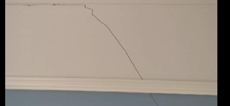

We finally found a house we both liked that ticks most all boxes and our asking price offer has been accepted, but it has loads of cracks in the plaster in different rooms and next door has cracks in the exterior.

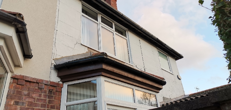

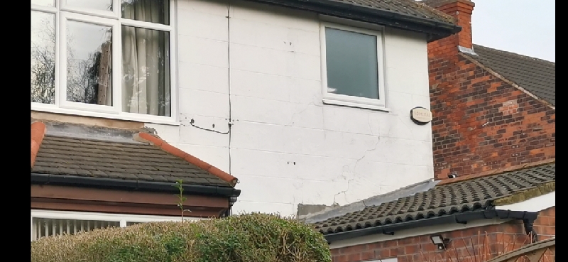

The house we are buying has had a retrograde exterior render board attached to the upper section hiding any potential defects, so I can't see if cracks on the inside are outside too. It appears the vendor planned to live there for a long time and has really invested a lot in it.

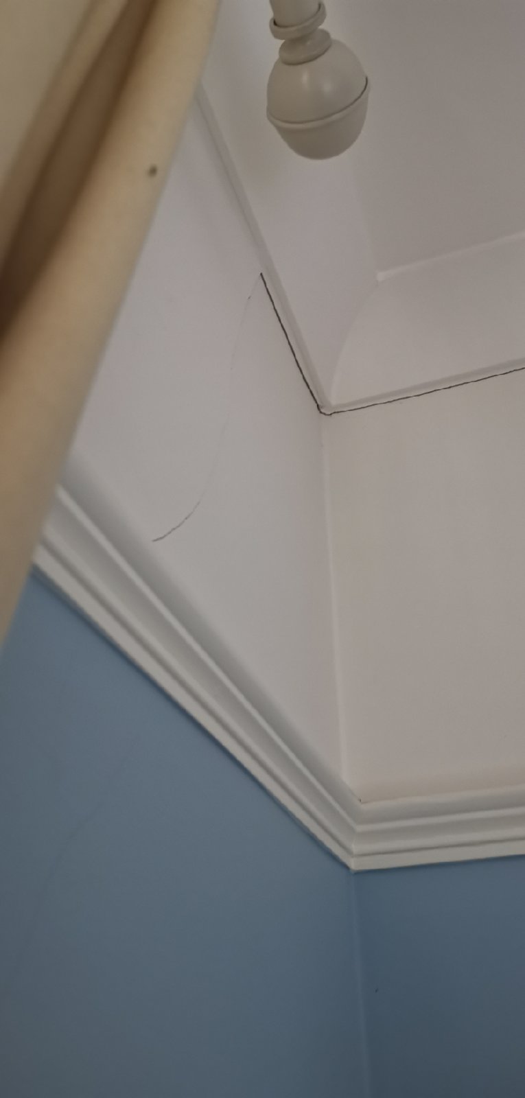

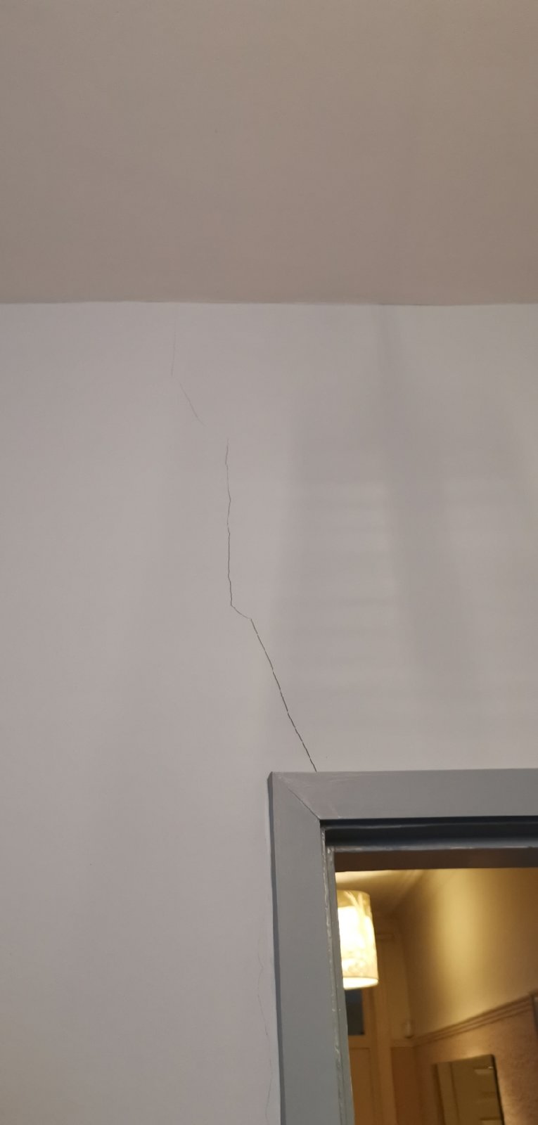

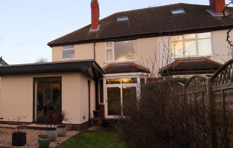

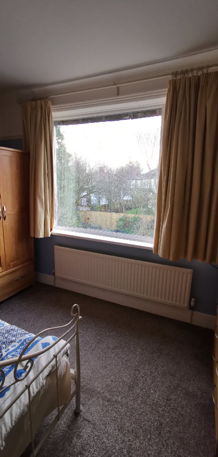

I'm posting some pics I've taken of the cracks. The worst are in the back master bedroom on the interior landing wall. There are also some in the new kitchen extension below. I hear extensions can take a few years to settle in. I have possession of architectural drawings showing pillons where driven in 800mm below ground level for the extension and the windows in the room are very large. Could this put strain on the wall causing cracks like in the photos?

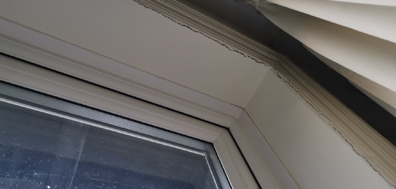

From the cracking type (the large diagonal cracking), that's typical of foundation movement (or issues with lintels and beams if that is what's below the cracking in picture nr 7), the cause of which would need to be determined and rectified before dealing with the repair. That's not to say its a bad buy, but the house would need to be cheap enough to allow for the repair costs. Also, insurers tend not to like properties with foundation issues or repairs.
A structural engineer would be the one to inspect this, but he will only comment on the cracking and structural issues, where as a building surveyor would comment on things like damp, roof problems and the general condition but not the cause of cracks like this - except the defective render. In either case, if you want costs then you would need to instruct that at the time of survey and pay a bit more for that.
No-one will do any invasive surveys (lift floorboards etc) as its not your house and if the surveyor is not working for the homeowner he has no right to go tearing the house up.
Just been reading another thread in Windows not being properly supported after changing to uPVC. I've uploaded a couple of pics of window at back of house that is adjacent to the wall with cracks in. Could this be the potential problem and need a replacement lintel or helix system installing?

That extension looks quite new & there's a rather large diagonal crack in the wall above where (presumably) the extension is knocked through into the main house. Have you had sight of the Vendor Information Questionnaire yet? And you might want to enquire from the local council whether they did the building regs on the job & how much for a copy (that'll give you data on the beam used & hopefully the foundations underneath).

Just make sure that the building surveyor who will do the building survey is actually qualified and comptetent to comment on the cracking.
Most surveyors wont be, and RICS rules will prevent comment on things outside the surveyor's competance. So you may end up with a note that cracks are present, but no comment on the cause or work required to rectify, and they typically refer you to a structural engineer - for another fee of course.
