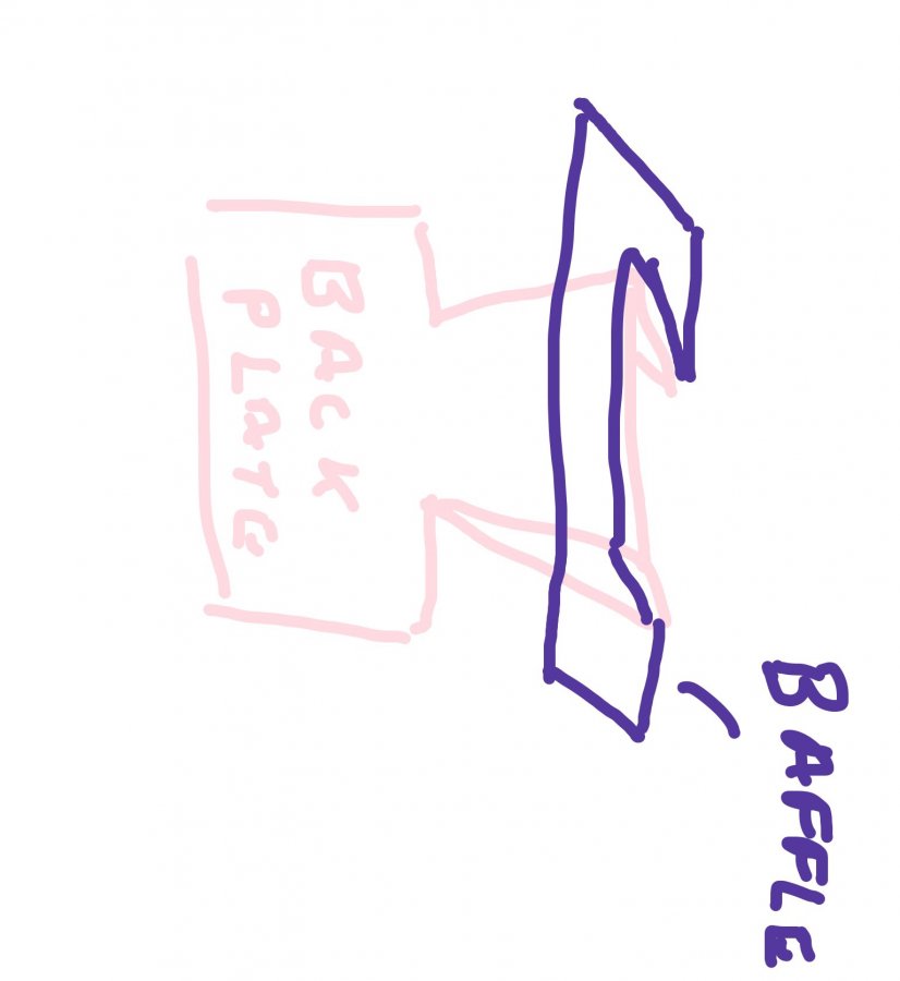

Your missing the top baffle plate which sits on top of the back plate .it has an oblong cut out that engages in the top of backplate so the gasses are guided to the rear flue pipe when that is used instead of the one in the top .
Intersting point here LIS; would the stove draw better if the top exit was used rather than the rear.
Yes much better especially if one has a poor draw but if rear outlet is used the stove may give more heat as the gasses are held in for longer?
