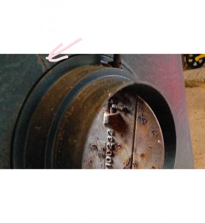

Back of the #3, no crack I think just a rust stain from the flu.
Ray K
what about this one?
litl
It probably is a thermal crack, and believe it or not it doesn't have to go right through the metal.....cast iron can be malleable to a degree.
That's why the top 'lid' of the stove needs to be allowed to float, i.e not bolted down too tightly.
I've seen this before, and there has been no smoke leakage to the outside but I'd always sure a CO detector was used in the room.
John :)
No, I honestly don't think so......cracks can appear in cast iron later if it's allowed to cool to quickly, and a stove environment is pretty hostile - being heated and cooled many times in it's life. I've seen this before, much worse than yours - and there was no escape of fume. Epoxy putties are available for severe cracks, and yours seems negligible.
John :)
If what we can see there is the full extent of the crack (if indeed it is one) I'd forget all about it.
The white stuff is likely to be high temperature silicone sealer.
John :)
A rope seal is typically around 8mm in diameter - and it needs a corresponding groove for the rope to sit in. I can't see a large groove in your flue outlet which is maybe why they expect you to rely on fireclay cement or high temperature silicone.
John :)
