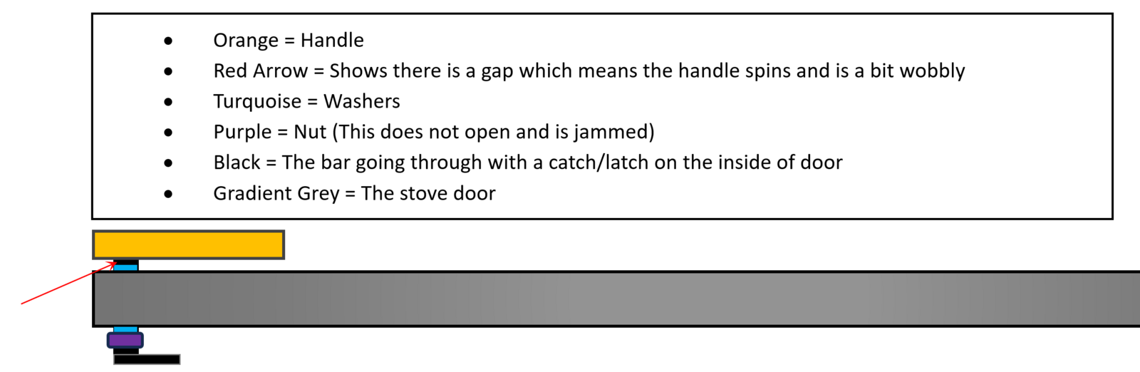

There's no screw, but there's a nut on the inside of the door handle that's not opening or tightening and the handle is also loosely spinning around as there is a couple of millimetres gap. I've done the following diagram in Microsoft Word to hopefully help you understand the layout and style:-
Excellent diagram thanks!

When you crank the exterior handle......can you see the inner bar moving, or has the handle detached from the bar that connects them somehow?
John
John
Yes, I can see the bar moving along with the catch/latch

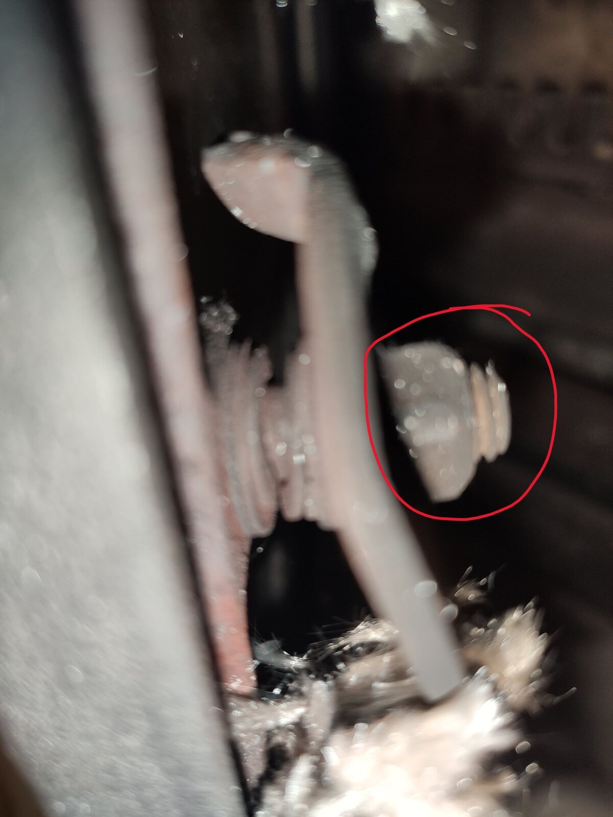

Hi @SFK - Thanks very much for the info and links. I did suspect that it's some issue with the washer or spring, but the problem is that I can't even take off the handle as the nut (circled in red) is jammed.
I do feel that the plate is bent - but not sure.
If you cannot get the nut off with a long spanner, then it might have to be a hack saw and a new handle.
A pole on the handle - to stop that turning, a socket and ratchet or spanner, again with a pole if necessary, it will undo with enough force. Might be safer for you with two people, one on each pole to prevent any pressure being exerted on the glass.
