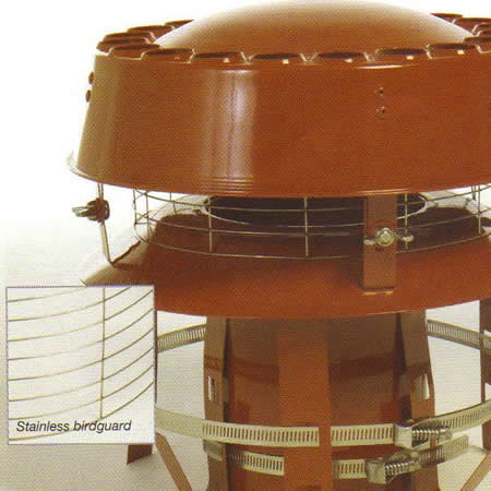

Are you game to sweep from the top? (at least you'll be able to pop the cowl back on :p ) Hopefully it is a cowl suitable for solid fuel?
John :)
i could give it a sweep from the top, might as well if i go up there to refit the cowl.
on that note the cowl is one of these

The cowl looks ok - mine has a bigger mesh area - but as it's not on now anyway that doesn't matter.
