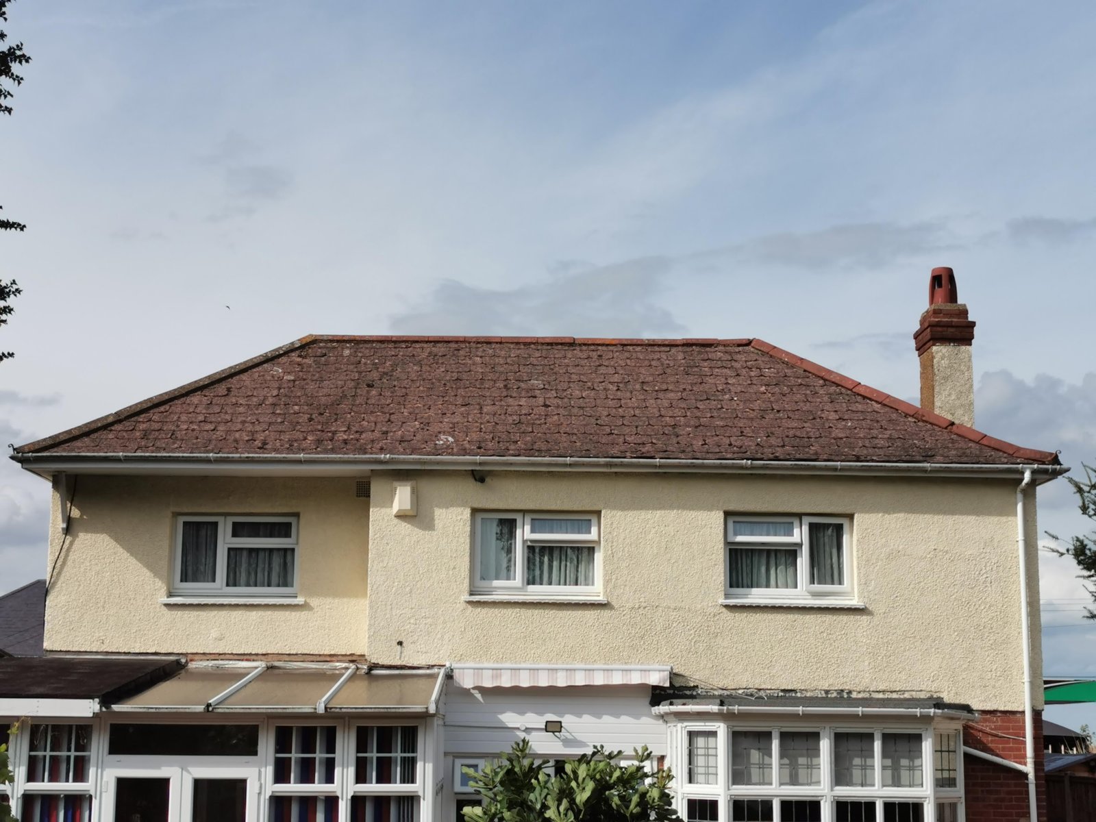

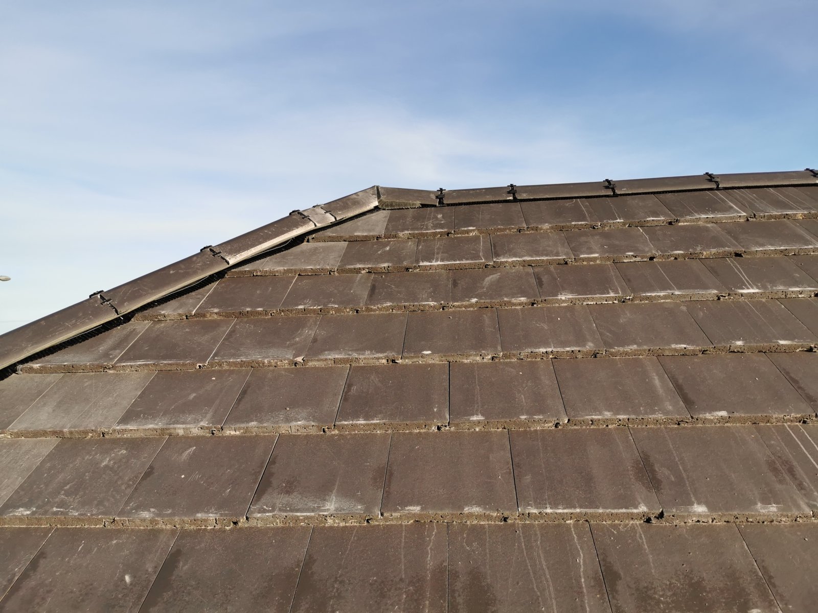

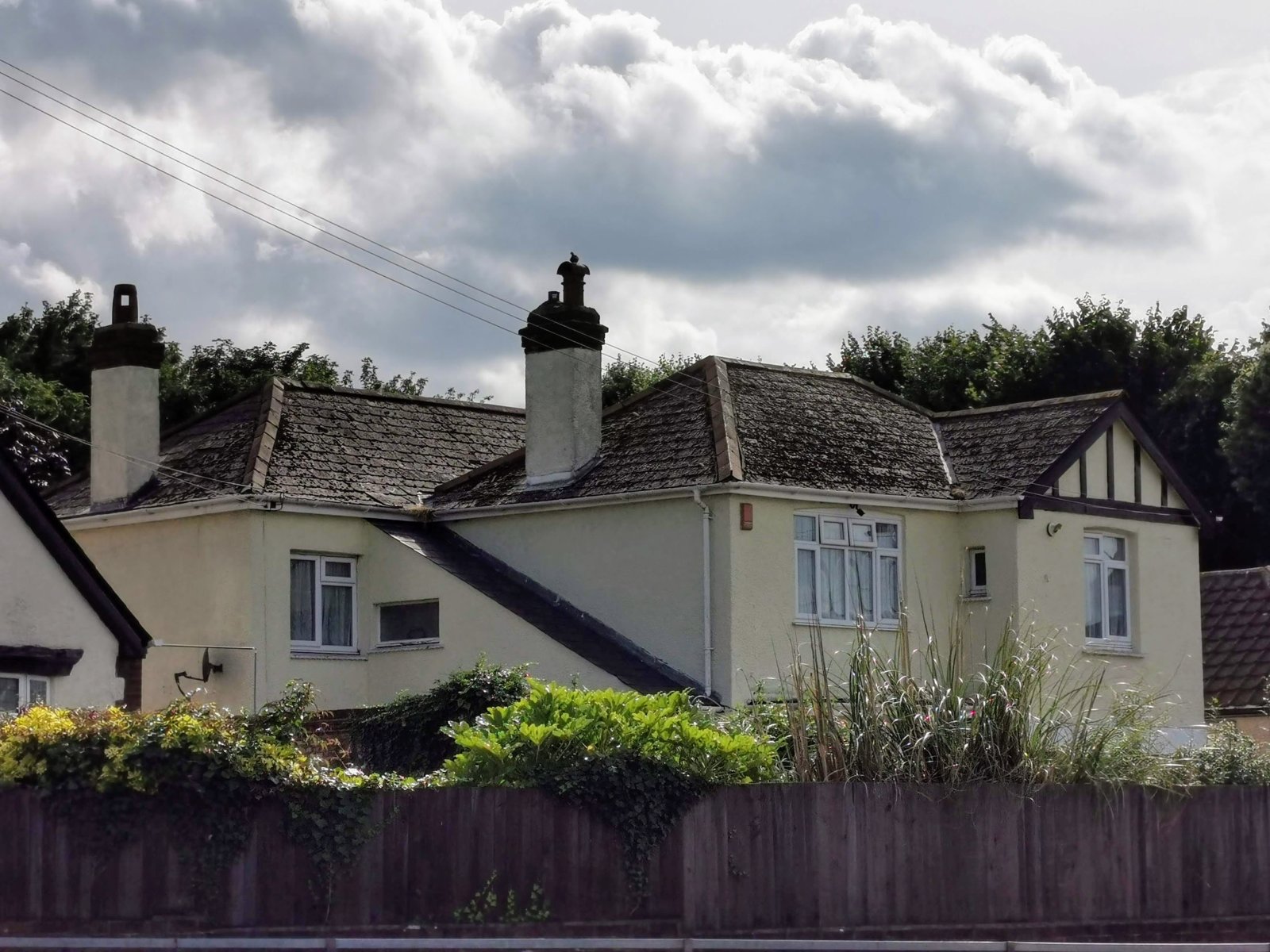

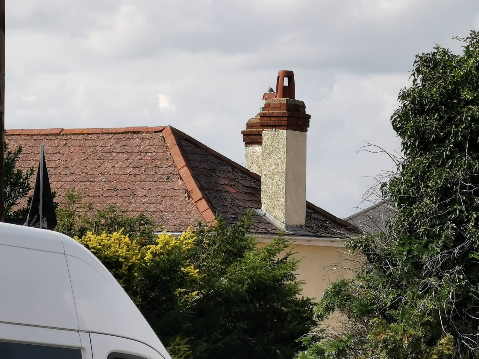

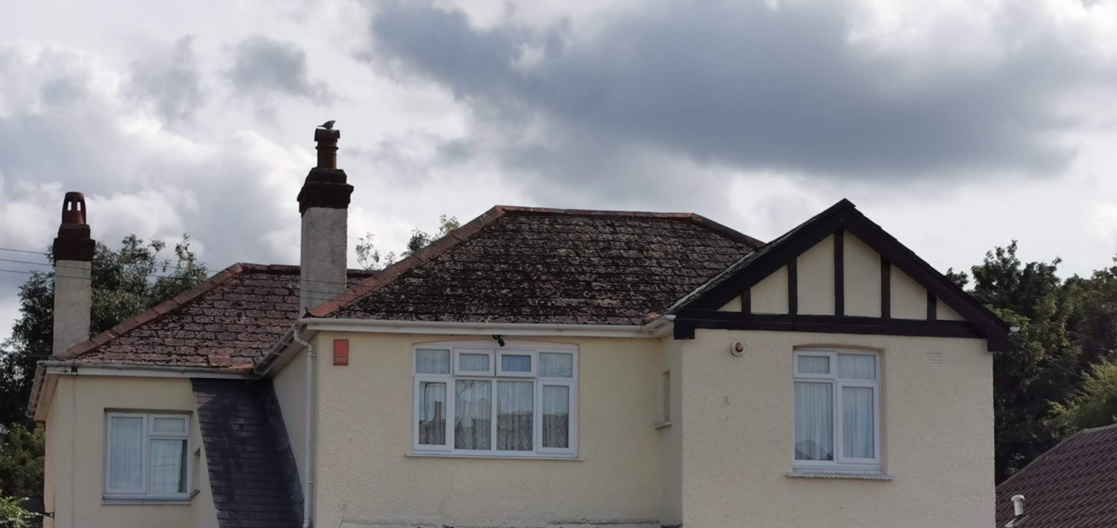

Just for fun, here's some photos of the roof.

Roof doesn't look that bad from a distance, if it's not leaking, plenty of time to plan the perfect roof.
If you have an idea of what you fancy, go along to a decent roofing merchant and ask where they have supplied those tiles/slates to.. They will give you the street Better than any display
I've found a local family roofing merchants. Ill either pop down or drop them a ring.
The roof is shedding tiles, nice vertical slits of light from where they've dropped off. And the ridge tiles are crumbling and slipping. It might last a bit more time, or if it weren't asbestos it could be patched up for less than a full roof but I think it's pretty much end of life now.
rare for asbestos to slip .. the ones i can see in the pictures are probably been stripped out in the past to allow repairs to the box gutter / valley
after which they were poorly re fitted..just guessing
that aside its past its sale by date
