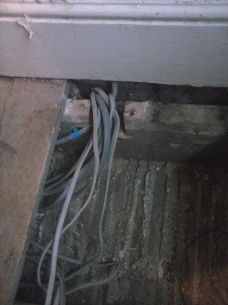

This is the 'pinch-point' I'm trying to avoid any pore sparks having to try and feed a cable through once the floor is laid.

I do intend to, very carefully enlarge the notch cut-out and ease the congestion.
