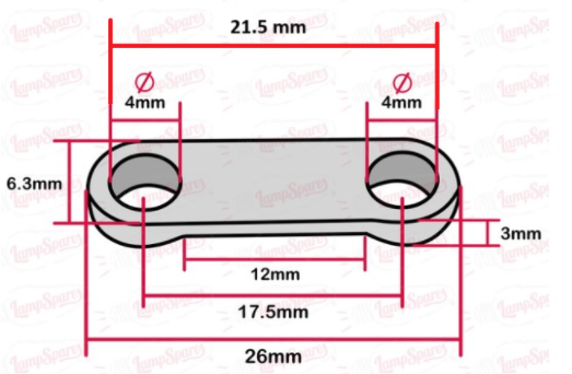

Good afternoon,
Is strain relief required on a fused connection unit switch? I would like to think it is, but if it's wired as a back entry for example, it's not used? Could t seem to find anything in the regs, but not 100% where to look
If it is required, do you know where I can obtain spares? I've been looking online but they seem too small or a different type. I phoned Crabtree but they don't sell them and they're pulling out of the Domestic market soon anyway.
Thanks in advance

The flex that rubs from the spur/fcu to the boiler so 3/5 core flex
Ok. so it comes out the front - so will need some sort of restraint.
The flex is the spur; not the FCU despite people calling them that.
Only if I'm changing one or if I manage to get a void property where it's having an upgrade
They are (usually) only a piece of plastic with two holes.
I thought it might. Sometimes they're wired (surface mounted) through the cut out - would this be ok to just be clipped, same as a JB?
I knew that, something I learnt from being on a forum, possibly this one
Afaik all of ours are. Are you saying I could manufacture something myself?

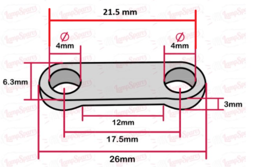

Found these, however I measure the fcu switch strain relief holes to be 20mm center and they're about 17.5mm :unsure:
I'm doing my best. Pretend you are Isambard Brunel. :)
