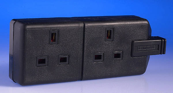

But the information we are missing is what type of trailing "two-gang trailing socket", is the OP talking about.
Is it one of these, with 2.5mm cable and suitable grommets:
Or is it one of these, that definitely wouldn't cope with a sustained 26A load!
