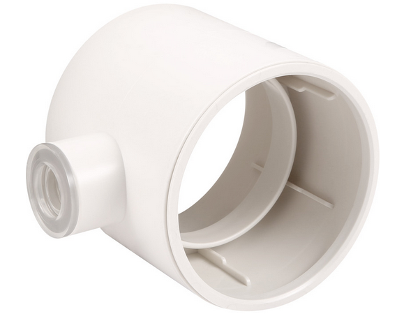

Condensate in ceiling fan ducting ... should you expect a rain fall of condensate - or is it insignificant in the South of the UK, the fans are on the ceiling, with the ducting going into an immediate elbow adaptor, as such there was no room for one of these:
I cannot find anything smaller or lower profile, one that could be retrofitted, does one exist ?
I am concerned condensate will drip onto the fans electrics ...

I am concerned condensate will drip onto the fans electrics ... the void space above is too restricted to fit the above trap ... does a lower profile trap exist, guess I could cut down and reduce the height of the above, the ducting is insulated in the void, but is a horizintal run of 5mts, letting the over run timer run for a good while I gather helps, other options are to resite the fan at the other end of the duct - or as an inline fan.

It seems USA is an odd one out, and they have different limits for words low voltage and extra low voltage so some items are incorrectly labelled. I also had a problem with condensate in long pipe, but time the fan is running is the main thing, was set to around 3 minutes after light switch turned off, no legal need for fan, so no need for long run on, however using the 15 minutes as in building regulations and problem solved.
Guess the restricted space inside the duct must dry out quite quickly - once the shower steam has dissappaited, I was going to set the over run timer to 20 minutes anyway, bathroom fans bnever seem quite pu to the job, always wondered why bathroom fans are so meek, yet kitchen fans made ware with such gusto ? I would have thought a showers worth of steam be greater and have more need than a pans worth of boiling peas.
