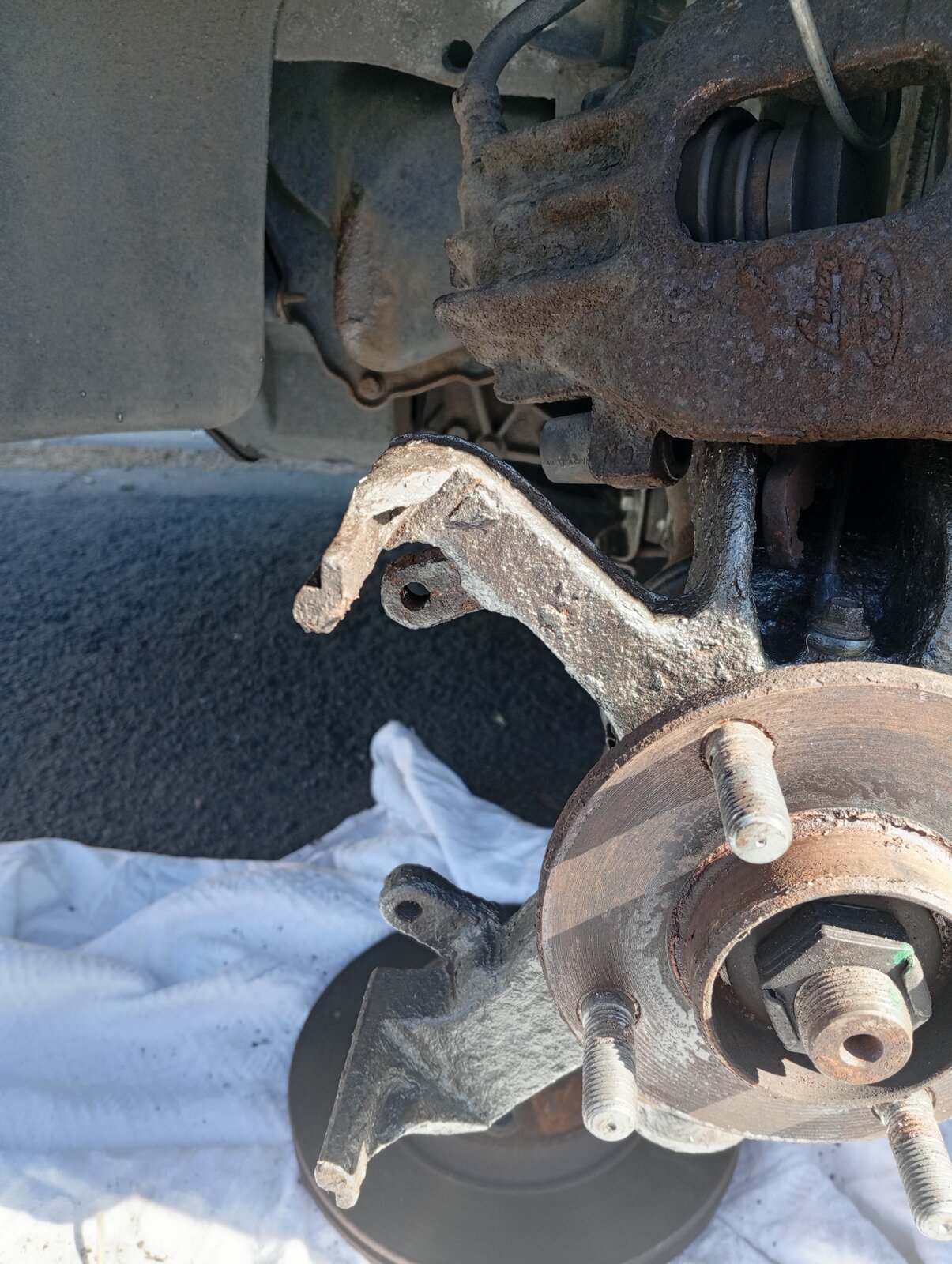

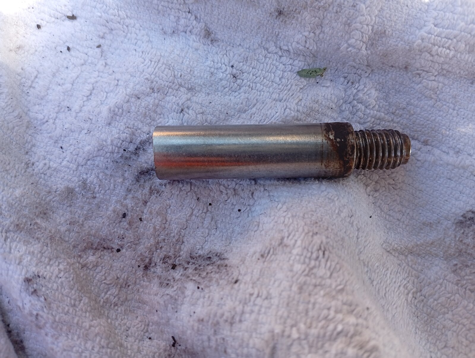

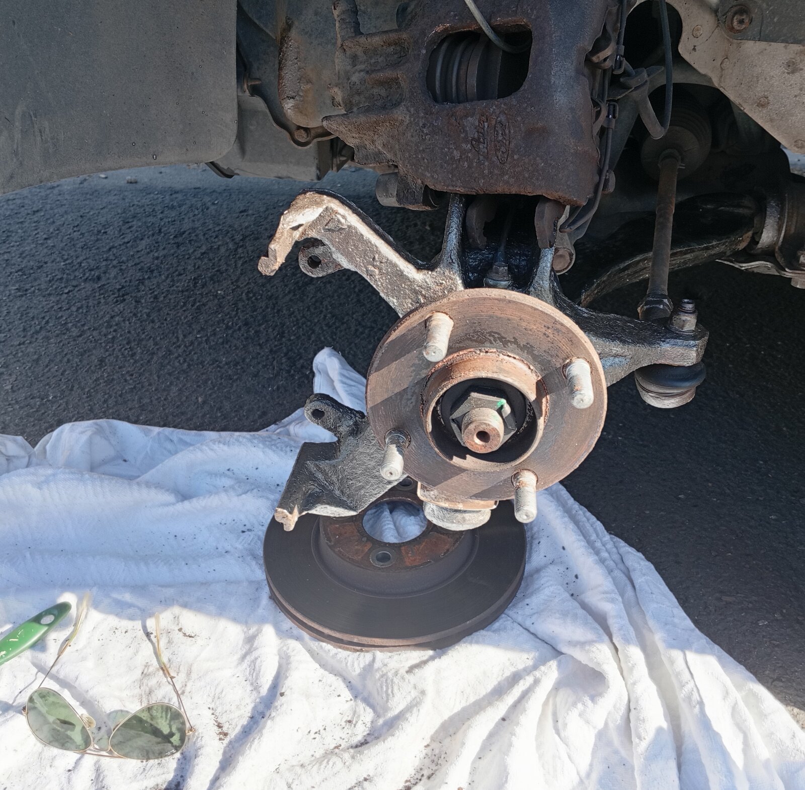

Hi everyone, I was going to change pads on my focus 2004 and when I unbolted the bottom guide pin of the caliper it felt like it was loose.
Once the caliper was out of the way I tried the bolt and in fact, it just turned around endlessly.
It's the actual mounting hole that's stripped, the bolt is ok.
Looking for a solution I saw on other forums people recommending helicoil or a repair kit like this one
Or, I was thinking of a guide pin of same size but with an M10 thread instead of M9 and tap the hole to that size (can I keep it dead straight?)
What do you think is the best solution?
Changing the whole hub is out of the question, it would mean scrap the car.
