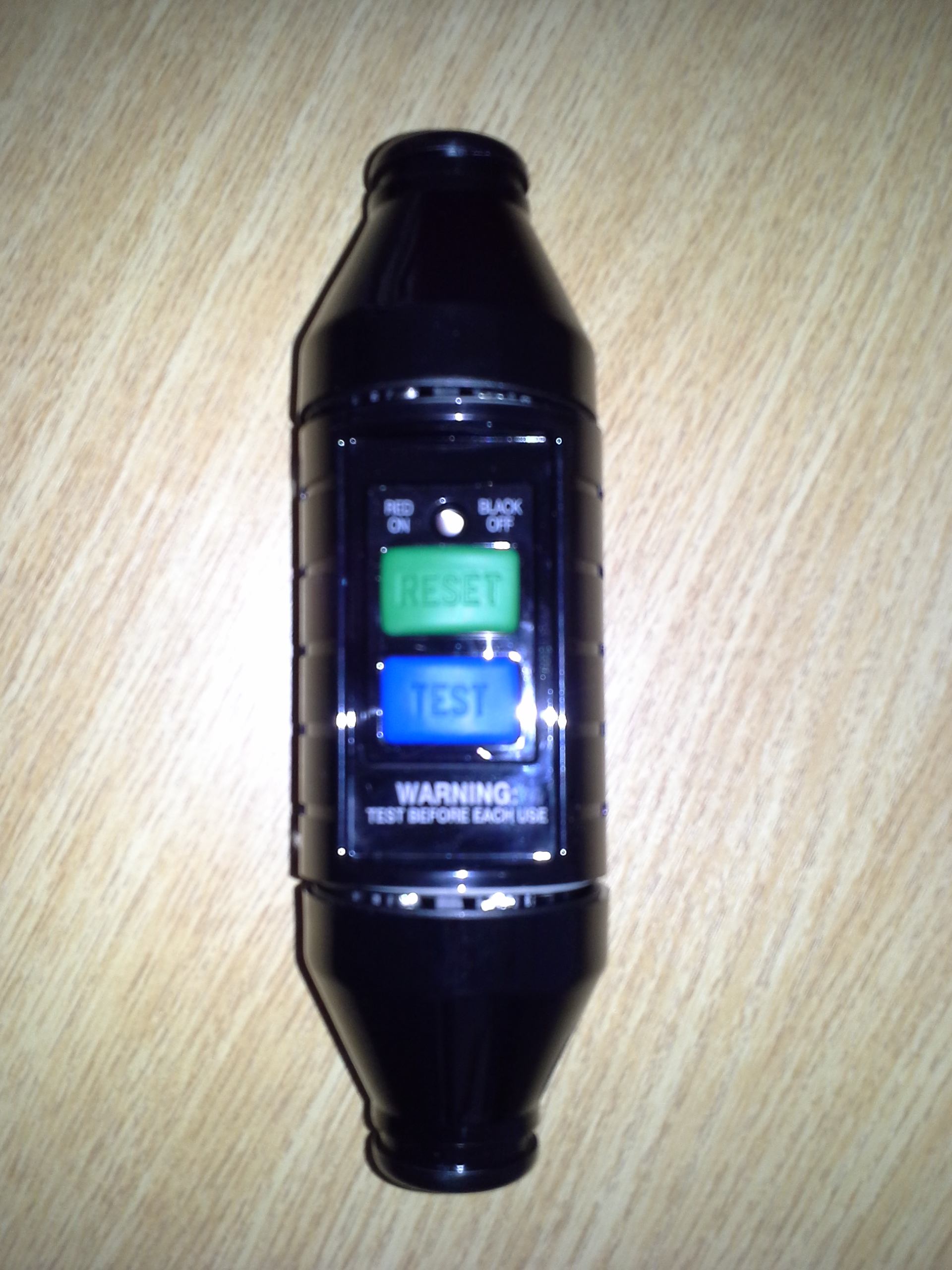

To the spur unit (13A fused) in this box i will connecting a length of Arctic cable which connects to a 30ma IP56 13A rated inline RCD which then connects to a 16A 3 pin IP44 commando plug.

1) Does using 2.5mm cable reduce the speed at which the RCD activates to a level i should be concerned about(due to the increased resistivity of the cable)? I ask because i would like a longer cable than 35m but don't want to reduce the safety of the setup for the sake of an additional 15m.
2) My knowledge says the RCD unit should be connected as close to the supply as possible so that it cuts power to the entire length of the cable (which on a campsite is at risk of being damaged) Is this correct?
No.
And in any event, 50m of 2.5mm² has a lower resistance than 35m of 1.5mm². You really should have known that.
It will only cut the power downstream, so the further up the cable it is the more it will protect. And the further away it is the less it will be under your "supervision".

1. If you are that paranoid, i am suprised that you do not have your own RCD, rather than trust the one installed on the site…..
and
2. Make sure you completely unwind that 50metres of cable. It will heat up and can melt if you keep it coiled (depending on the load, of course)
I do have my own RCD "30ma IP56 13A rated inline RCD" its mentioned on the 4th paragraph as i do not trust the site ones :)

I would need to replace the cable, lower the breaker values and cable in a voltage/current monitor to that for me to be happy with it. Also that arrangement they have there doesn't protect the long cable with the RCD. If a dog chews into the cable he is toast!

I wasn't sure on how the RCD reaction time is affected by resistivity differences and cable lengths hence my reason for asking.
Indeed, and I accept that, but your concern was that a 50m 2.5mm² cable would be "worse" than a 35m 1.5mm² one. It's not - it has a lower resistance, which should not have come as a surprise, as the csa is 67% larger but the length is only 43% longer.
