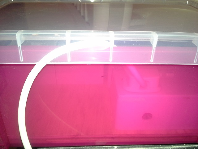

I will ditch the MCBs. I will keep the spur though as it is conveanient as a switch and connection point for the cable.
With regards to the size of the box, i wanted it to be big enough so that there would be space for some of the adaptors/cables
that i would need to take with me when i went camping.

Will the equipment be in that plastic box when in use, ? If yes then considered condensation on the inside of the plastic box.

I have considered condensation although the box isnt close to being air tight. Where the lid meets the box there are horizontal tabs which touch the rim instead of surface to surface. Infact that space is perfect for having cables come out of the box, even with the lid firmly on.
Ignore the hole in the patress box, will replace that (it isnt cabled up yet).
