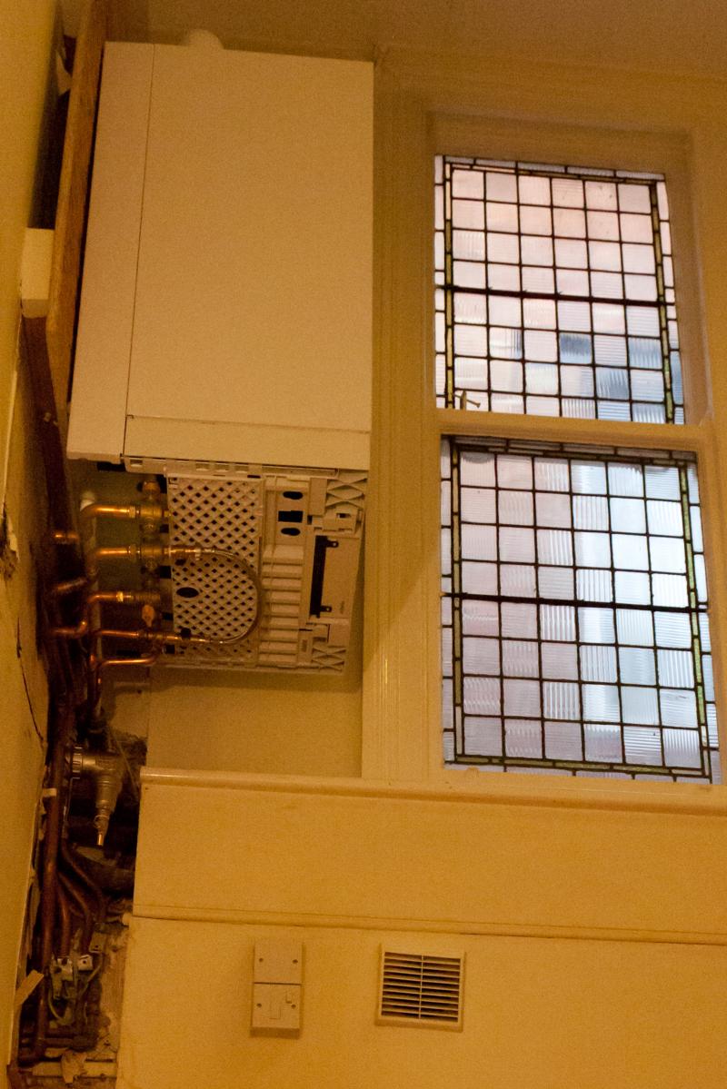

Can a boiler flue have 2 90o bends & run downwards?

Why is the backing board higher than boiler and maybe I'm wrong but is the spur upside down?
Surely coring new hole is easiest way to fix, although it certainly doesn't look like 1m from window as prev said.

Simply a flue for a condensing boiler must slope UPWARDS away from the boiler!
The flue must terminate outside at least 300 from any window reveal ( unless a flue diverter has been fitted. ).

Yeah there was, but it was smaller & higher. I heard her tell the engineer when he suggested it goes higher 'No, it needs to be at a height I can reach.' It's definitely a safety issue.
im a little bit confused as to whats blocking what and how
It doesn't show in the photo but the boiler is low and jutting out 65% into the stairwell. Anyone tall will bang their head on it & it will be impossible to move heavy domestic furniture past it.
Surely coring new hole is easiest way to fix, although it certainly doesn't look like 1m from window as prev said.[/quote]
The backing board is where the old boiler was. She has had it brought lower & this boiler is wider than her old one. It juts out into the stairwell 65%. Anyone tall will bang their head & moving large domestic furniture past it will be impossible. The 1 meter was distance from wall to window, the flue is about half a meter. We asked to have the hole moved higher but she refused.

She is the freeholder - thats why she thinks she can do whatever she wants & finds it objectionable that we question it. I heard her tell the engineer when he suggested it be higher 'No, it needs to be at a height I can reach.' She use a step stool to reach the controls.

She is the freeholder - thats why she thinks she can do whatever she wants. So the flue needs to be 300cm or inches from the window reveal? Just measured it - the flue is 40cm from the window frame. Good to know it must slope upwards too.
so are you a tenant or a leaseholder? I think as someone suggested earlier it could contravene fire regs. A visit from building control may be interesting...
