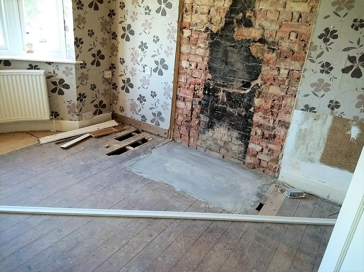

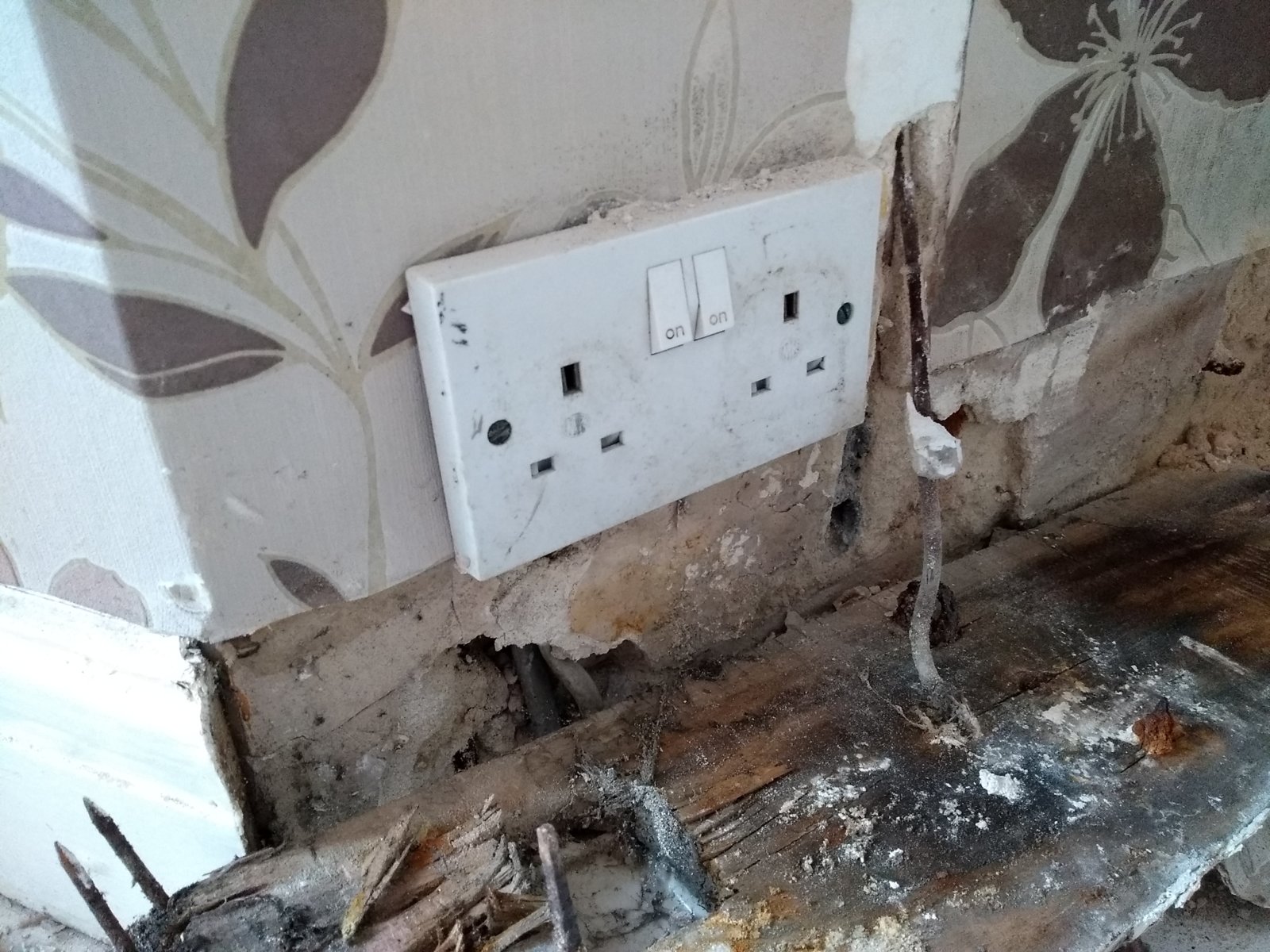

Cables run under suspended floor. I plan to glue insulation to the walls, ready to be plastered over by a pro. If I turn off the sockets at the consumer unit, it is perfectly safe to remove these wall sockets (still keeping them in their cases) and place them in new positions? There's 3 in this pic, one is already on the floor as it was on the side of the chimney breast. I'll be ripping out most of those floorboards so will have good access. If the cables are similar to the room next door, then there is plenty of extra length to allow them to be moved a fair bit.

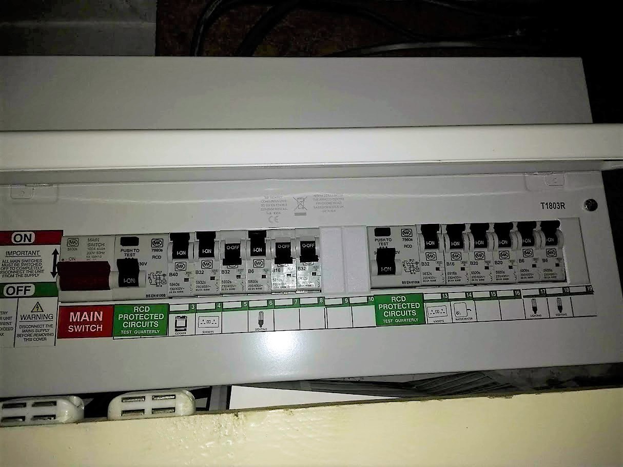

Safe isolation (making sure the circuit actually is OFF) DO NOT rely on what is written on the fuseboard. There are a number of MCBs there that do not have labels, where do they go?
Best Practice Guide 2 Issue 3 (1.00 MB)
Cable routes must be in the recognised zones
https://www.diynot.com/wiki/Electrics:walls

But presumably is it not currently a bedroom, so the sockets are not currently on the bedroom socket circuit (not that one of those is marked on the CU), so how do you plan on transferring them to a different circuit?

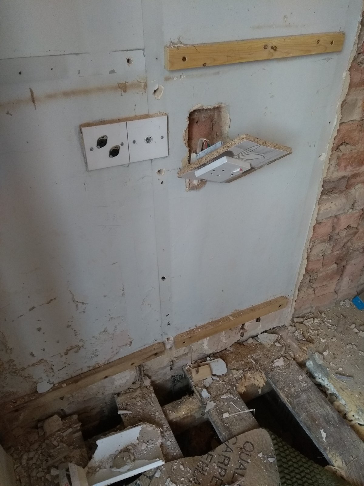

There's only one circuit on that part of the board for sockets. Any way, decided to carefully remove them I'll get the electrician in to put in new boxes when the walls are ready. Got some old tv and i guess radio sockets hiding behind the chipboard wall.

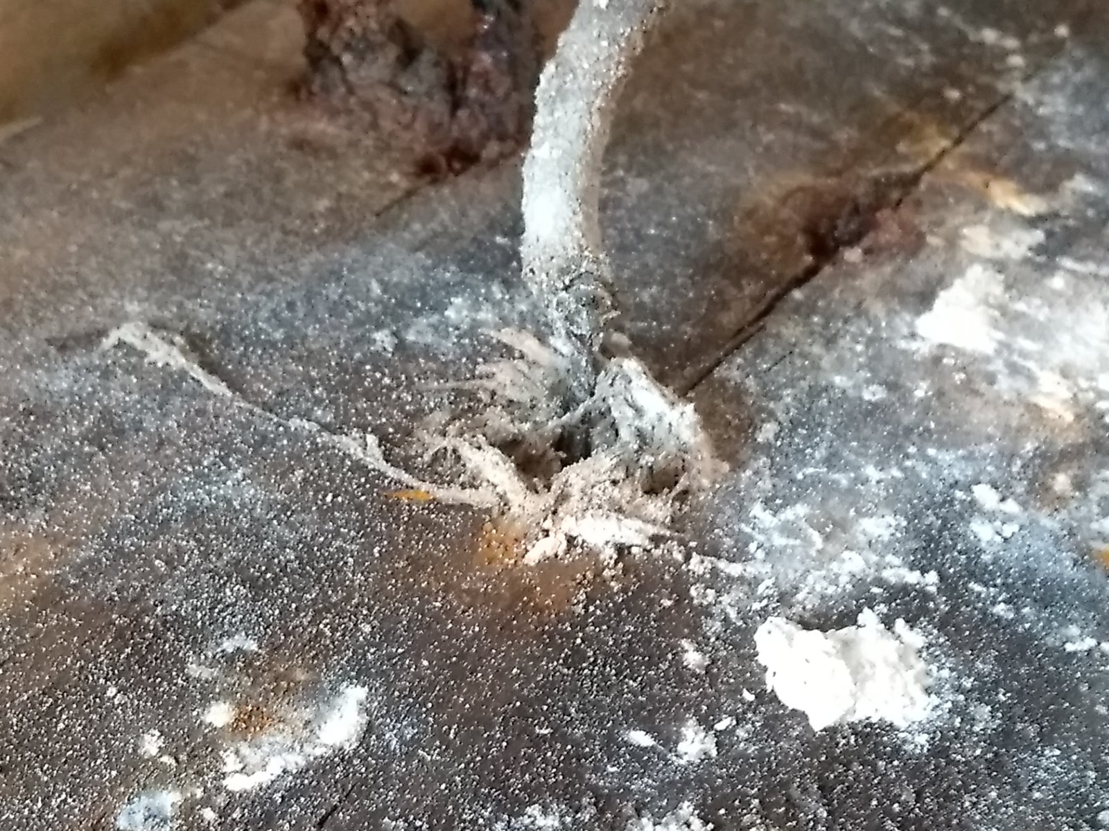

And what is this? Old earth wire?

Looks like a TV or radio aerial and two loudspeaker sockets.
What are loud speaker sockets? I assume these would connect to somewhere else?

Why do you think it might be that?
What would it be earthing? It's not G/Y.
Sure it's not aerial coax?
I don't know what it is. Had something similar in another room and somebody didy maybe earth, but i really don't know.

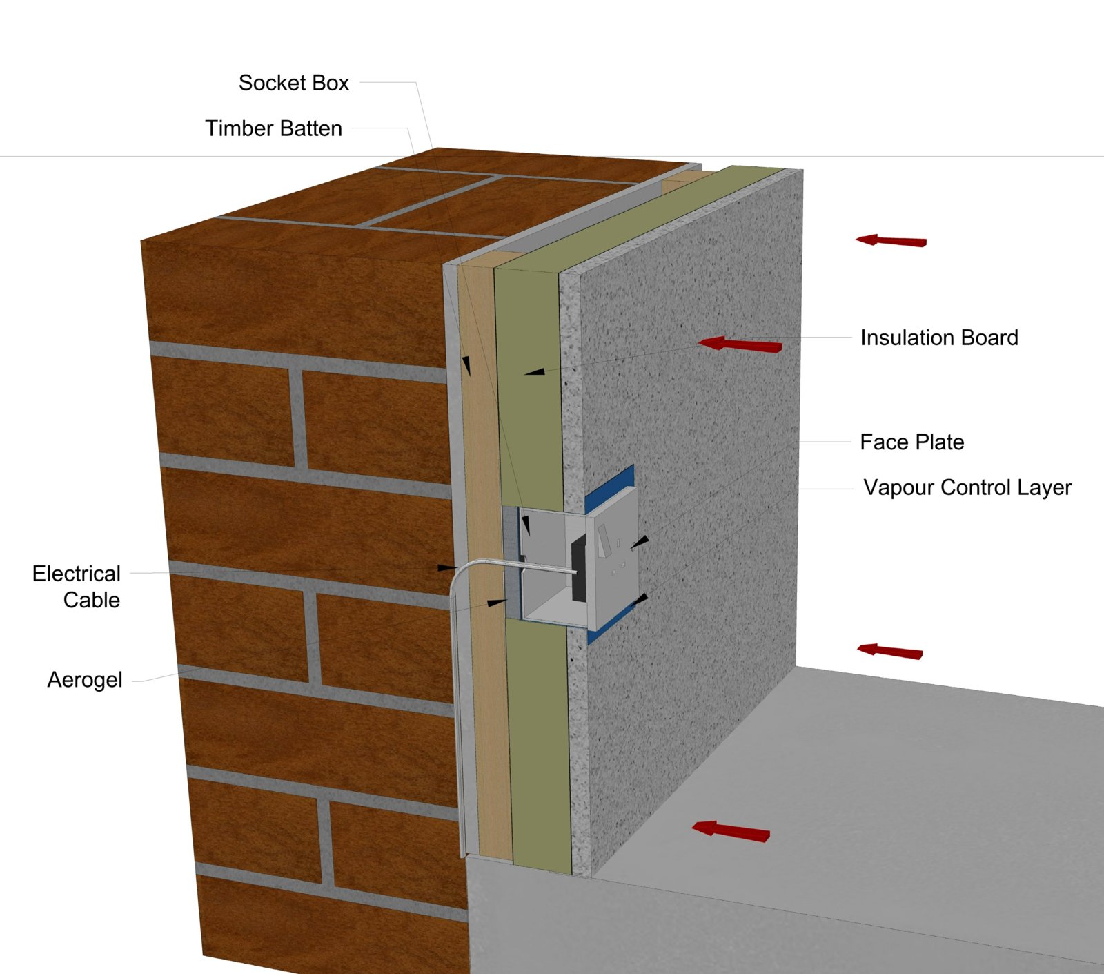

Will be a bit like this:
