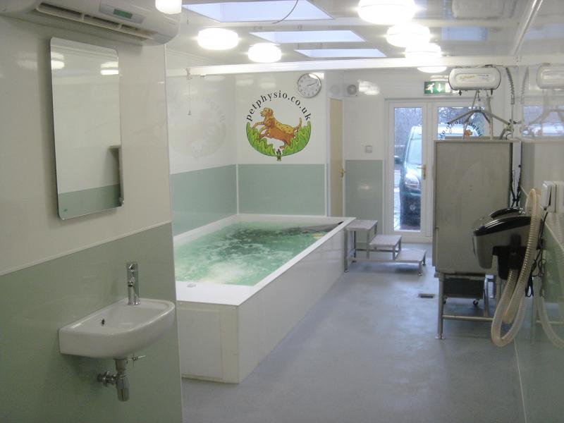

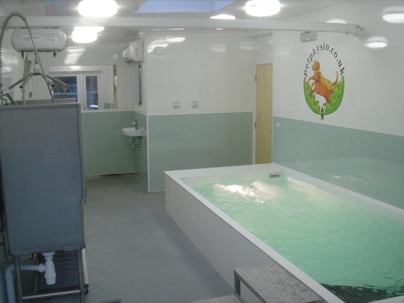

We have wet room at the practice for our dog swimming pool and water treadmill hydrotherapy facility (I'm a vet).
Before the concrete floor was laid, a 4" floor drain was placed and the floor was meant to drain towards it, of course, but doesn't. Unfortunately, the decorative acrylic chip floor was laid before it was realised the levels were a disaster.
In short, part of the floor fills an inch deep, from the splashing and the water would actually flow under a door to an adjacent room before it would flow to the drain. Not suprisingly using a floor squeegie to clear the floor, with each dog is a pain.

In the photos the drain can be seen and the low point of the floor is between the end of the pool and the wall.
I took a lot of photos of the positioning of the pipework in the concrete raft and therefore I think I should be able to drill and install a floor trap in the gap between the pool and wall, close to the wall without wrecking the pipes.

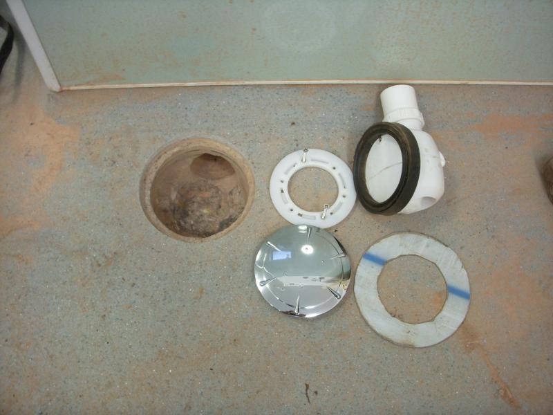

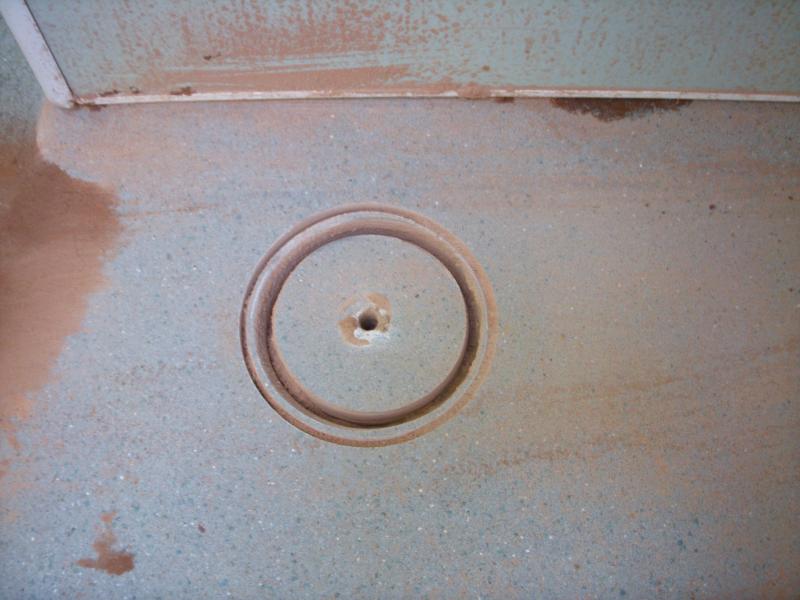

In the end I decided to install a 90mm shower trap into the concrete at the low point in the floor.
I drilled two concentric cores with a shallow 6" cut for the lip and a deeper 5" cut for the trap.
I fabricated a stainless donut.
I was able to connect into a 50mm ABS pipe in the next room which was draining a sink and the condensate from my air conditioning unit. I has already fitted an air admittance valve so I shouldn't have problems with the trap being sucked out.

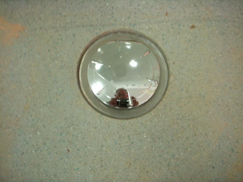

I bedded the trap into waterproof tile cement and sealed the trap and stainless ring top and bottom with premium silicon.
I shall be looking to replace the removable plastic dome which is flush with the floor with a stainless replica. That way it won't get broken.
