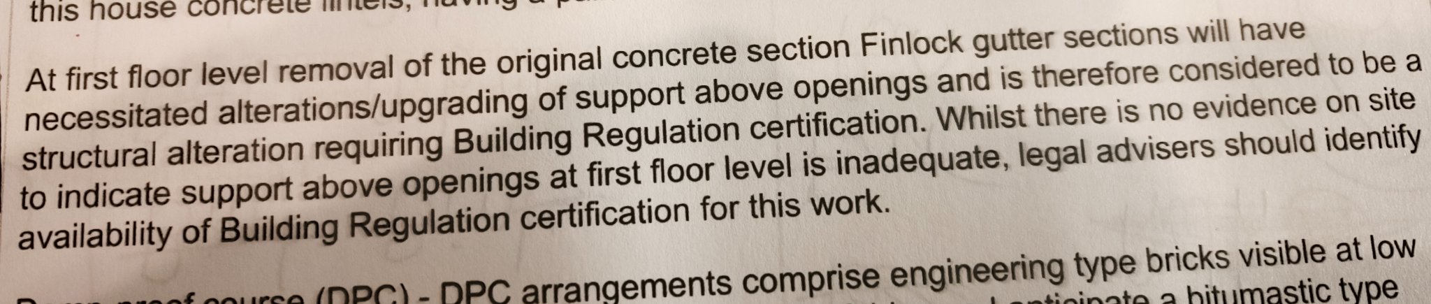

I'm a spark, been in the game 30 years. Know my way pretty well round a house in terms of structure, but don't understand this.
Can anyone help, please?

Eldest lad is in the middle of making an offer on this gaff.
I'll talk to him tonight and pass this on.
More important is seeing for yourself as to whether the work was done OK (if you can), if the rafters are adequately supported as are the window heads then jobs a good'un. When was the work done? Got any photos? Speak to the owner.
Bear in mind the usual surveyors get out clauses and hiding behind all sorts of disclaimers.
It's a Level 3 RICS survey.
My lad viewed the house, but of course he didn't know what he was looking at or for.
The survey has left his mobile number and has said that he can ring him to discuss any issues.

Finlock gutters - nightmare. Usually havy lumps of masonry (or wood) perched right up at the eaves, that can carry the wall plate and consequently the roof.
I walk away from any Finlock jobs.
Yikes, thanks.
Let's hope the paperwork is in order.
Otherwise, it could be a nightmare.
Never come across these before in all that time!
Short, non-AI translation ...
The property had Finlock gutters, which are concrete blocks forming an external gutter and laid across the external wall which the roof timbers sit on.
These have been removed, so it needs to be checked if the roof is still being adequately supported over openings.
This work (the roof support, not the gutter removal) may have needed building regulations approved so check if this has been done.
It is possible to cut the external gutter section off without disturbing the internal section - and the roof support, so does not necessitate building regulations approval. The surveyor should have checked this and commented on what has actually been done internally rather than make a general assumption.
