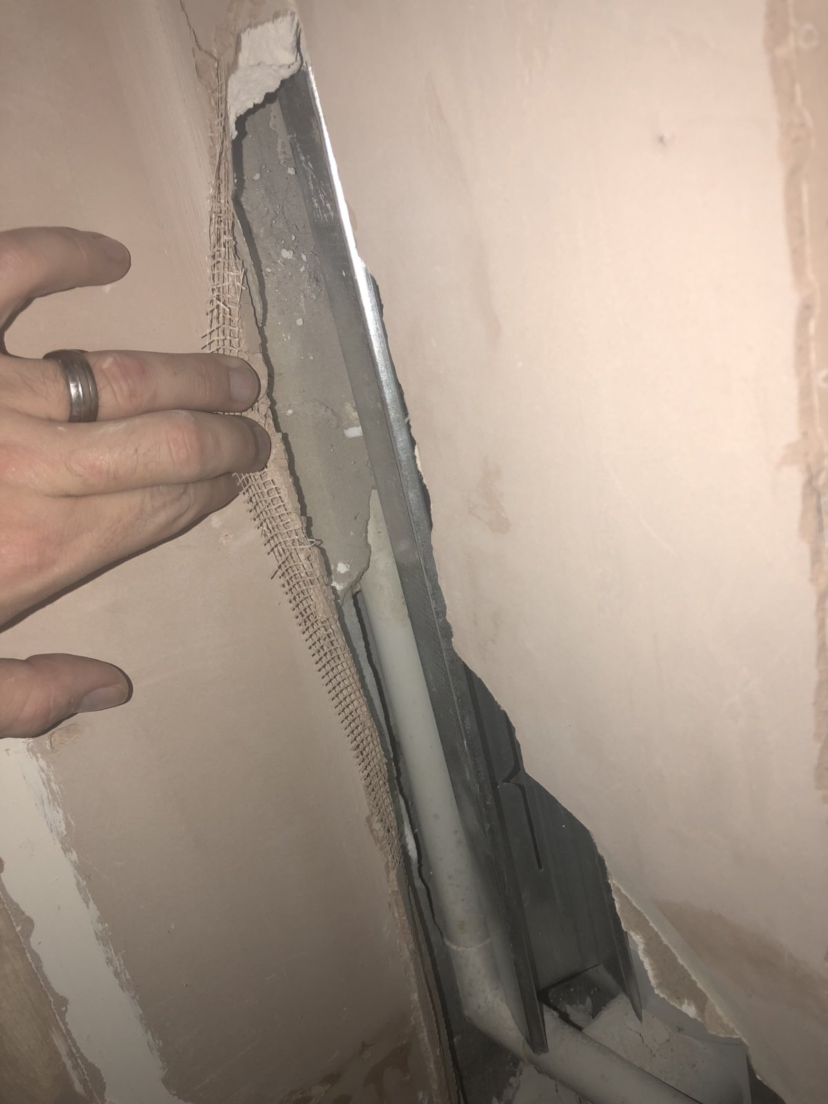

this is the waste from my utility room. Had a sink and washing machine connected.
The main pipe goes into the main soil stack. But the smaller pipe goes up in the same direction as the stack towards my boiler. There is a similar pipe coming out of my boiler which I’m assuming is the pressure relief overflow. I’m guessing the two are connected.
However, because of how this pipe is connected it’s filling up with crap from the washer waste.
Is this normal?
It looks like the condensate pipe and it's very wrong.
It needs a proper connection to waste stack/pipework - technically it's part of the flue system and should be sorted by a GS registered engineer.
It looks more like the condensate pipe from the boiler and is very badly plumbed in if it is. Do you have a condensing boiler ?
Yeah it’s a flue condensing boiler. Potterton performa system HE.
Is there a simple way to check if it is coming from the boiler? Without ripping the wall out?
It’s been like this 11 years. What do I need to do to rectify it?

Directly into stack would be fine ( closer to the boiler would be even better ). We are assuming its the condensate pipework ,it could be an overflow from a wc. I find it hard to believe a gsr would have connected it like that ,but of course its possible.

Well, Ive Ripped some plaster board off and the pipe disappears into the wall. So without taking the wall out I can’t check for certain.

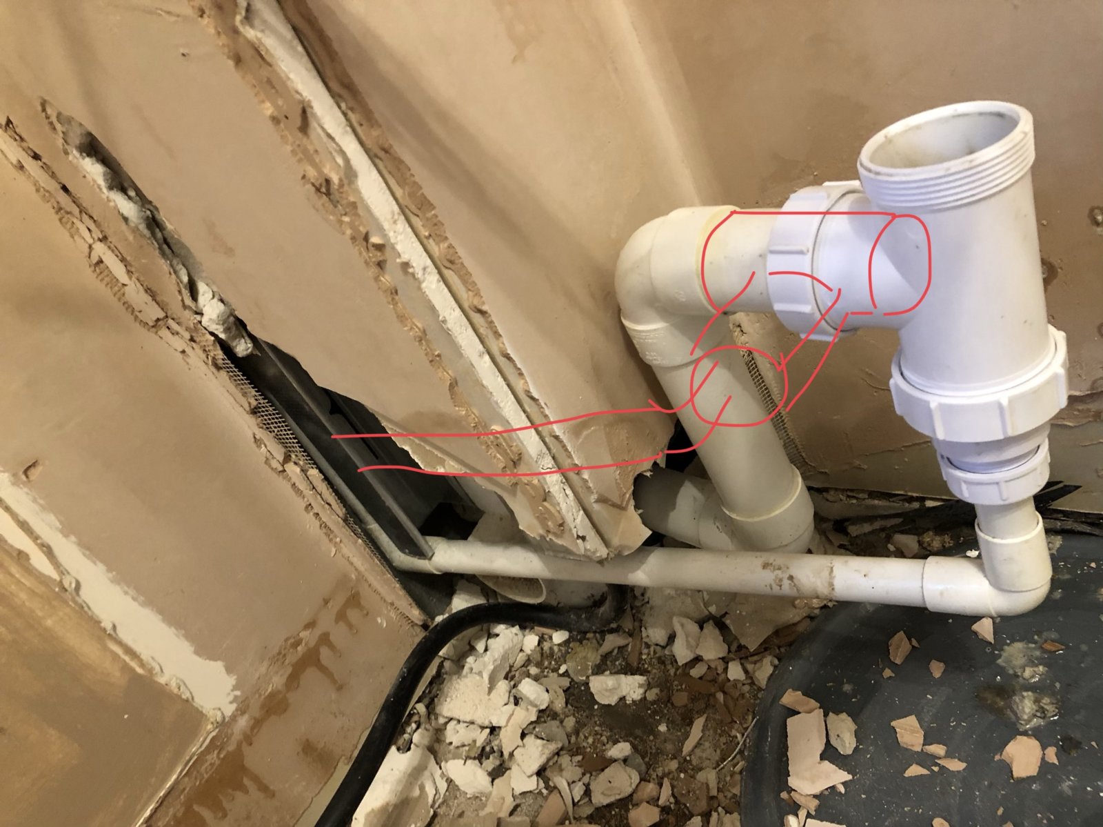

As it’s already going into the stack, can I just connect it straight to the but as high as I can get it?
If so could someone point me in the right direction to the right connector please?

Well thats not gonna be too easy ,pipe behind metalwork , soil stack further back and no easy access. Refer to your first pic....if you can join the condensate pipe into the vertical section of white waste pipe ,high up ,with sink waste etc lower that may be the best bet
Would this work?
Put t junction here and move condensate pipe up a bit?
There’s only going to be a washing machine waste going in here now as the sink has gone.
