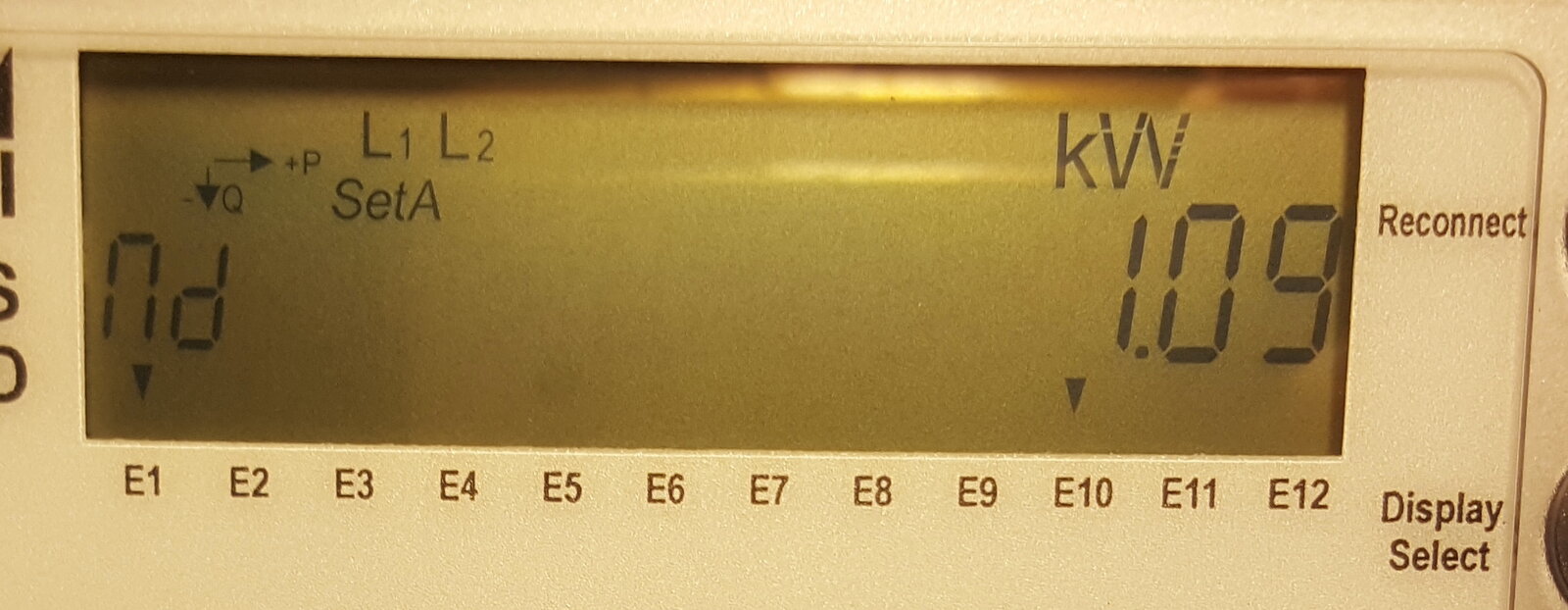

Can anyone tell me what this meter page is showing ?

When I get the meter readings at church, one of the pages is this one. I'd assumed it might be something like current demand - but at the time I took this, the actual load was around 1/4kW (both by a quick "what's on totting up, and by timing the meter pulses) and would not have been higher at any time in the recent past - possibly for days.
I’m no electrician, but what about the meter supplier website (if there is one)?
From the few pixels of text on the left hand side, I guess that the meter is an EDMI Atlas Mk10D
... Some further googling may be required! :)

Does attached help?
"Maximum demand in kW (Highest demand since last rest)"
