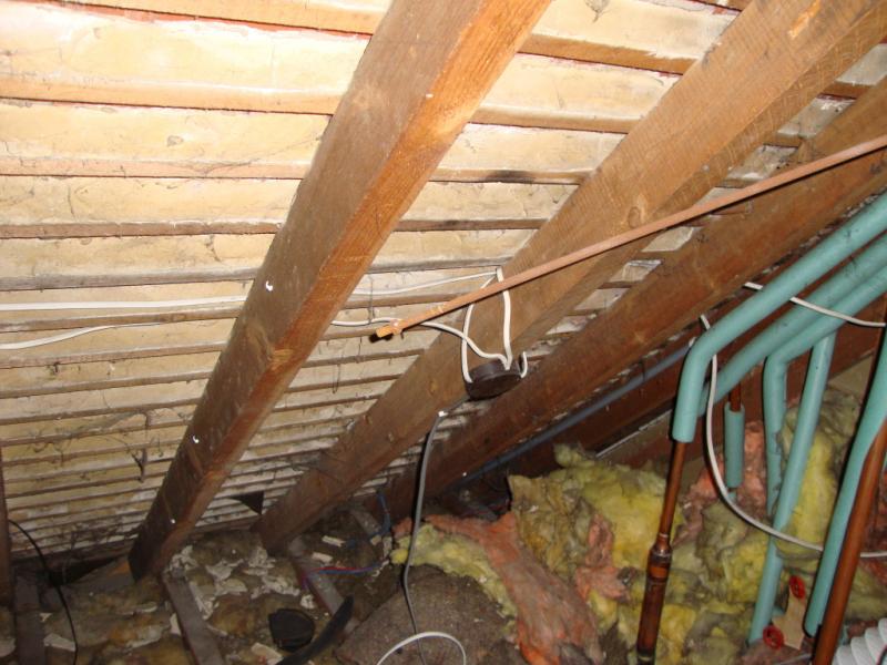

As per RFs pic above, use cable tray rather than wood, that's what it's made for but make sure you use a wide enough tray to accommodate all your cables without having to bunch them together or you'll have another derating factor to worry about instead of your insulation...
You could make a fairly neat job of suspending the tray from the rafters with a little thought, keeping it completely clear of the insulation.
