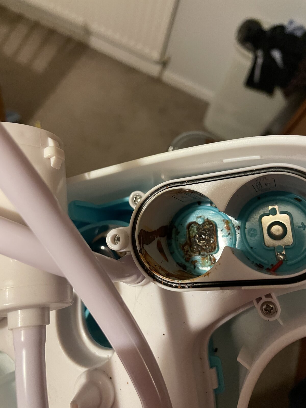

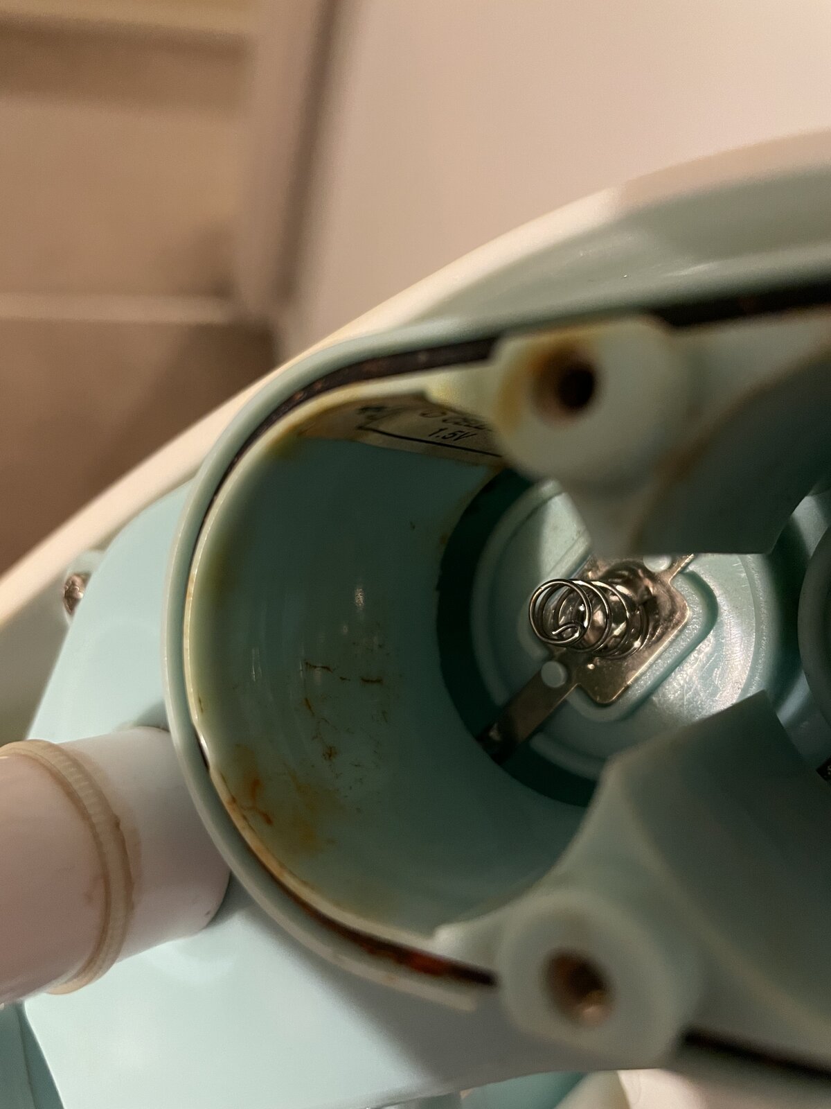

We’ve had a few of these in storage. Opened them up and found severe corrosion. Can they be repaired economically or are they a write off?
I’ve attached one image of a hood one, and one of a corroded one.

my experience is you can clean/scrape/sand the corrosion off and get stuff working again but it's often not as reliable as before.
I've heard some suggest vinigar for neutralising alkaline battery goo, haven't tried it myself though, if you do use it make sure you rinse it off thoughouly afterwards.
I agree with all that.
I suppose that makes chemical sense, but I think that keeping the vinegar away from where it shouldn't be (and where it could do more harm than good) could be a serious challenge. Some of the 'de-rusting gels' might be a better bet, since they are at least not 'liquid'.
Having said that, I've rarely failed with the 'mechanical' methods mentioned above - but, as said, the end-product is not necessarily very reliable.

I took this into a gadget repair shop and they couldn’t fix it, so I might have to try myself. If I just pop off the old corroded could and attach a new one that should work? I guess I’ll need to find a specific type of spring and plate? (These are D battery compartments.)
ok my thoughts yes clean the springs for a good contact
but iff perhaps 4 or 5mm room for the spring then perhaps a full replacement spring or even half a spring just screwed round the spring thats there to intertwine giving several points off contact giving a clean overall connection but off course it wont work if no space
other options tin foil in balls a layer tucked into the spring to give a clean area to pick up electrical contact away from the face but be careful off bridging both + and - on the battery
even brass 'phosphor bronze 'electrical steel wire strands to twist/push fold into the spiral to pass contact to the surface
