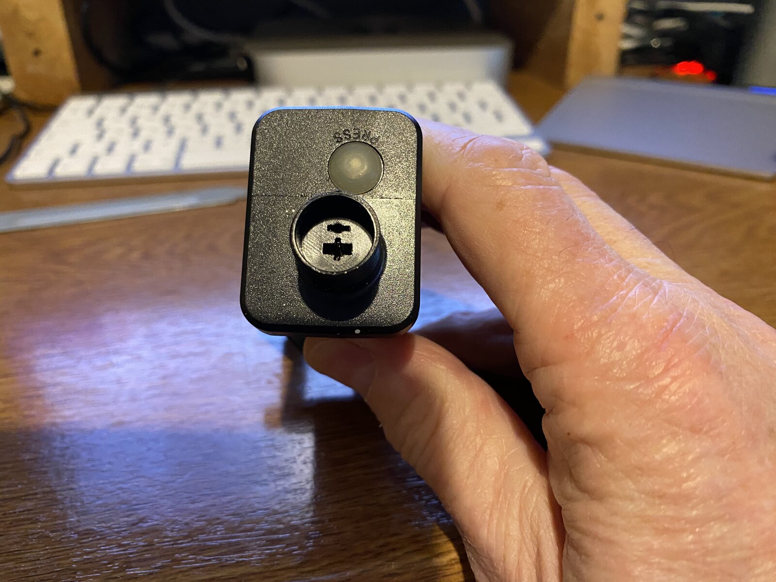

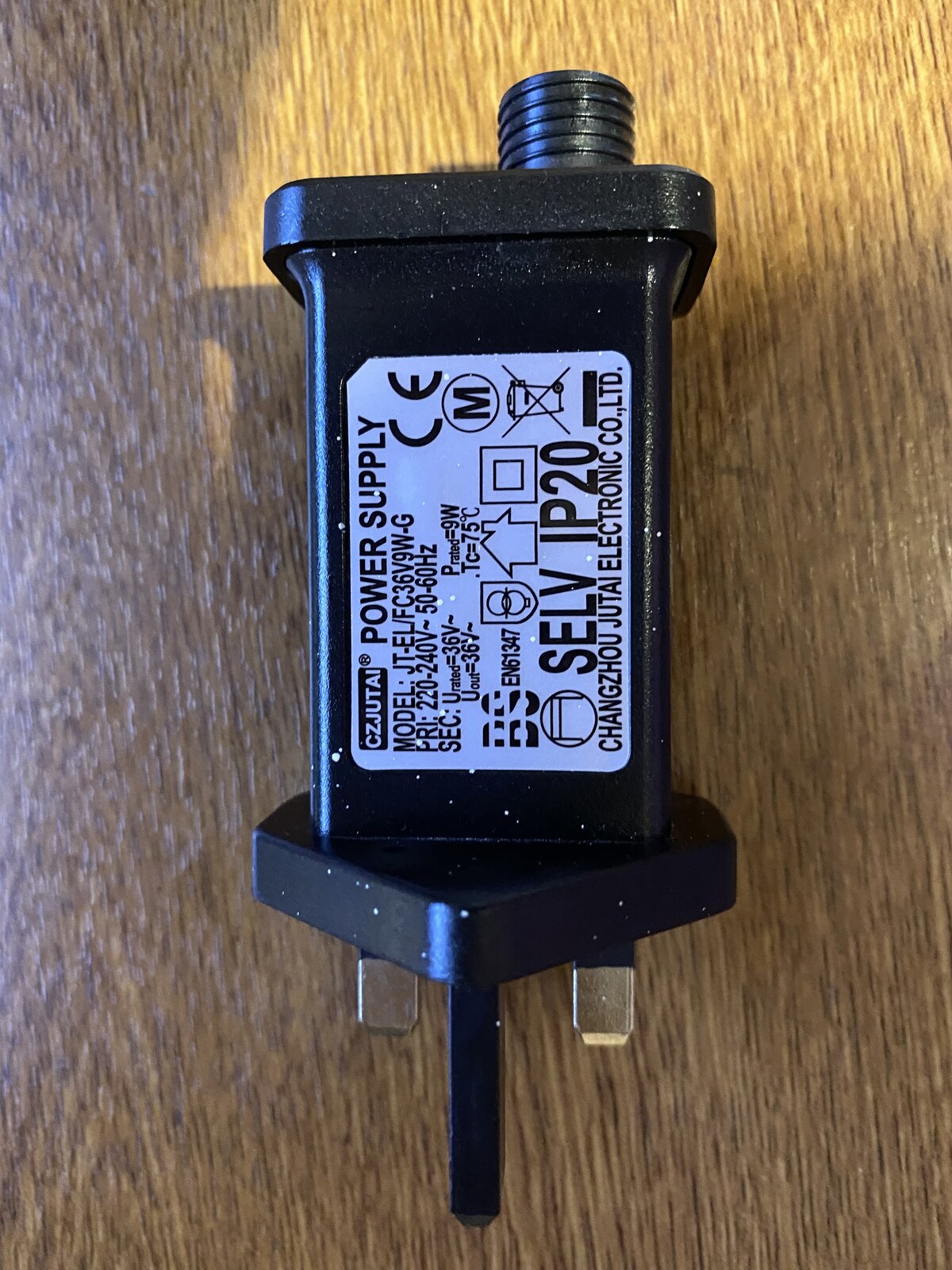

I have got some decorative LED lights on a holly tree in our front garden but the PSU has broken. It is a 36VAC PSU supplied by Noma who make the lights. I really don't want to replace the lights as there are 720 and it was a big job fitting them. These particular lights don't seem to be sold now and PSUs for similar tend to be DC. Can I run these lights from a DC PSU ?
Well if they don't work at present there's no harm in trying. Have you a Photo of the PSU input/output?
See attached
On DC, you will probably find that only half of them work.
