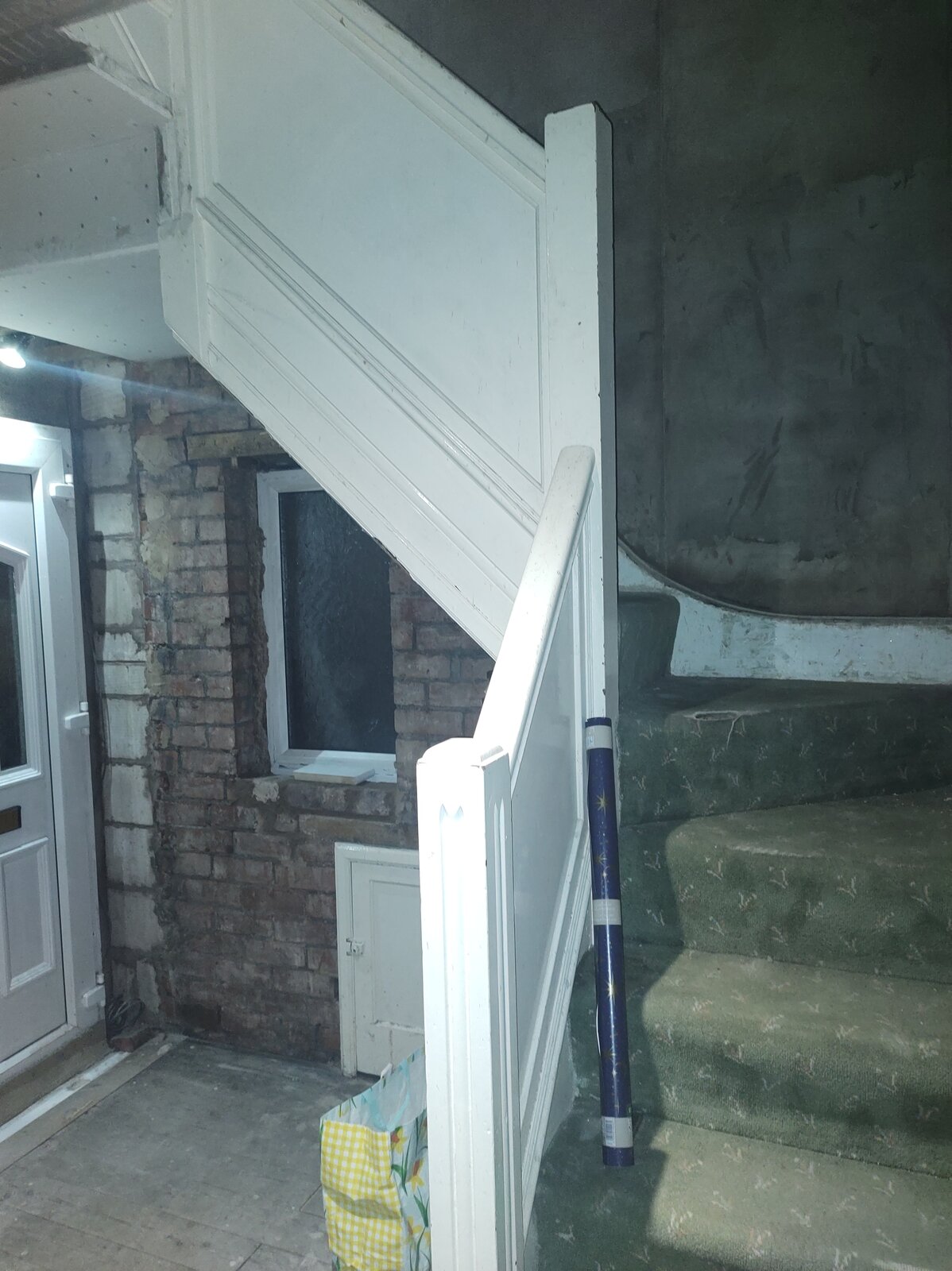

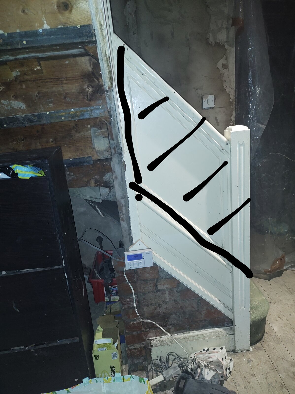

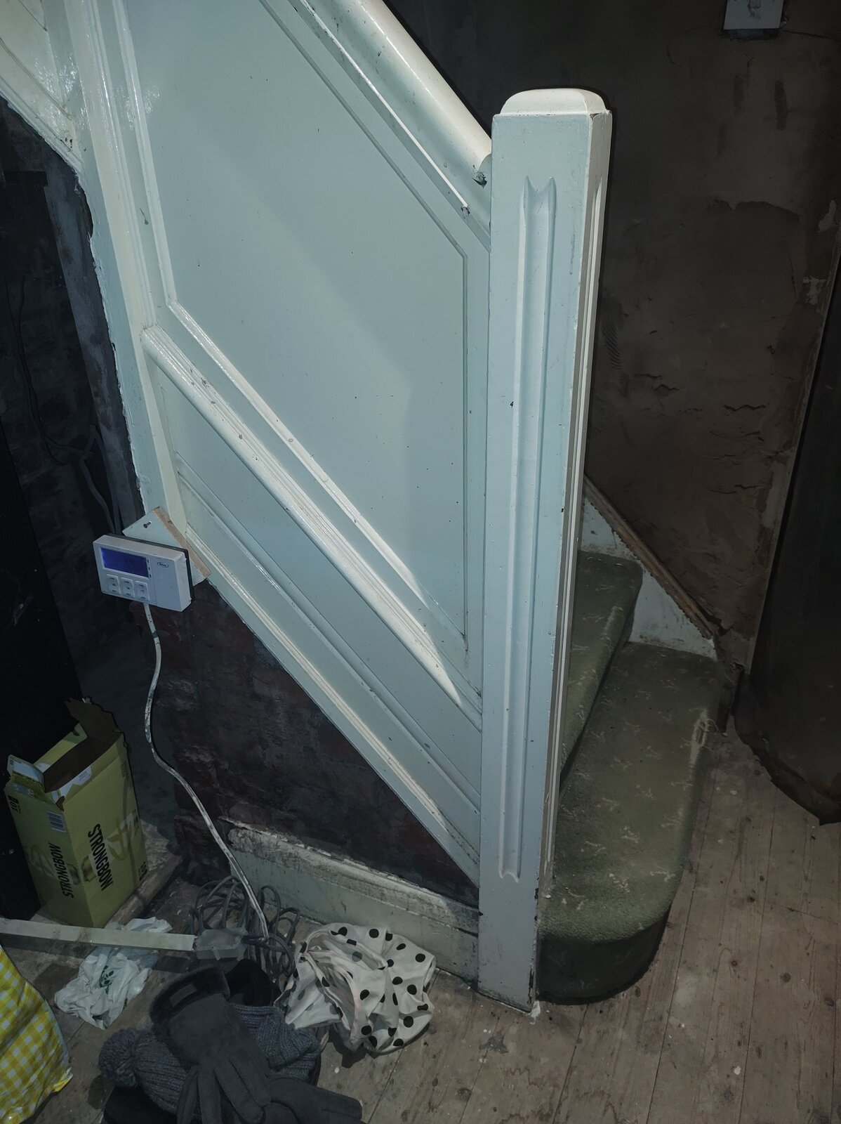

Can I remove bottom newel post and lower balustrade?
22 Nov 2009
4,020
1,143
Oldham
I don't think they're structural?
I know I'll need a bit of handrail on the other wall.
The aim is something like the lower section below, with the retained higher components clad in plasterboard and capped with oak:
