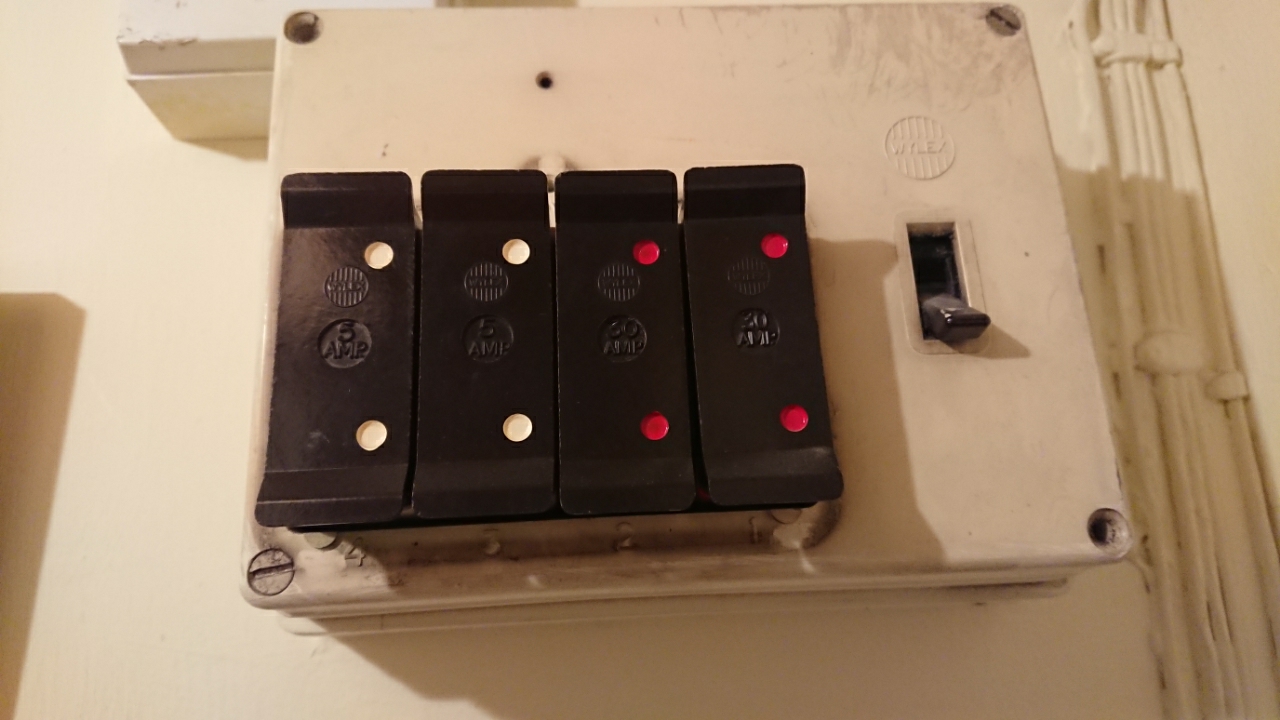

Is it safe to remove individual fuses in my fuse box when I want to isolate the electricity to a certain part of my flat, or should I always turn off the whole supply using the switch on the right?
I'd rather do the former because if I turn off the whole power I have to turn off my computer and reset mains powered timers etc when I turn the power back on. But I'm just wondering if it's safe to pull these fuses out without turning off the electricity first? Picture of my fuse box below.

As above. Pulling the fuse doesn't disconnect the neutral plus you're relying on someones markings.
OK, thanks, seems clear. I gather that there is some risk of getting a shock from the neutral. I have my own markings and it's always been in relation to light fittings that I've turned the power off before, so I could turn the light on before removing the fuse and see that the light was then off in order to be sure. But I'll switch off from now on.

Switch off before removing fuses, and don't insert fuses with it switched on either.
Risks include fusewire protruding from the ends of the carriers which will shock and kill you, carrier breaking as it's removed, fuse blowing as it's inserted and spraying molten copper onto your fingers.
Fusebox is several decades overdue for replacement.

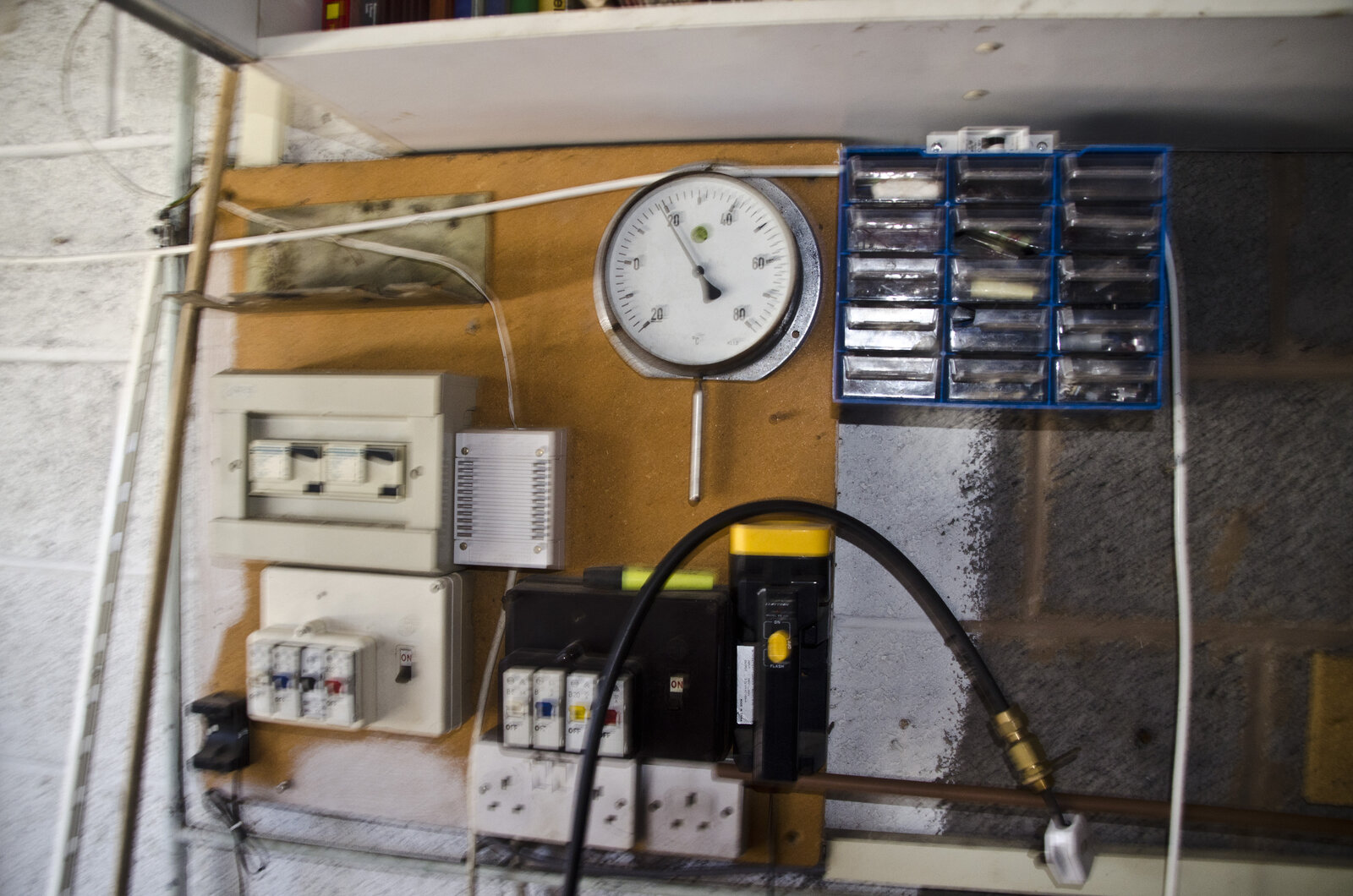

However as DIY we are unlikely to have proving units, and also lacking other test equipment, and with no RCD protection it is rather non forgiving if an error is made, I fitted RCD protection to my old house with that type of fuse box back in early 1990's, this house was done within 6 months of buying. I know there is no law to say must be RCD protected, but if you intend to do any DIY electrics I would say RCD is first job. I still used the old Wylex but as you can see DSC_3921.jpg still fitted RCD protection.

I hope you have the cover for the fuses. I note also two screws are missing from the panel.
It is understandable to want to turn off single circuits. For example, you might want to have the lights on so you can see what you’re doing while working on a socket. You shouldn’t do this, but I bet a lot of people here do it anyway (I know I do - but I have RCDs). The safest way to do this is to switch off the main switch, remove the fuse cover, remove the fuse, replace the cover, turn on. Repeat in reverse when done. Double-check for live wires before touching anything, in case it’s not on the circuit you thought it was. Of course that doesn’t help with your computer powering off.

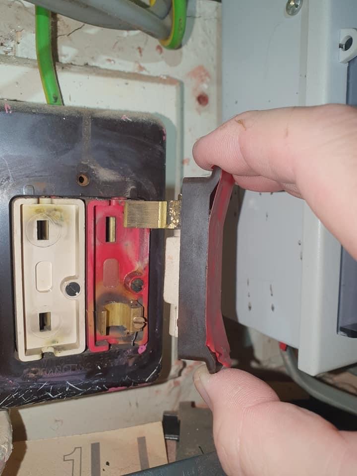

How’s this for a stark reminder of why it’s important to switch off before removing fuses...
(Stolen picture)
The fuse board should have a cover over the fuses (where’s that?).
I seem to remember that the cover is embossed with wording that says to turn off the main switch before removing fuses.
