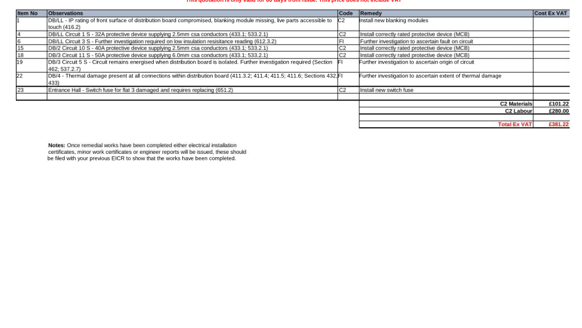

I remember in collage being told as electricians we could in the heath and safety laws override the managing director in isolating dangerous machinery, not that I would ever try it, but there is a sting to the tail with domestic, and many a gas safe engineer has fallen foul of it, in that if we make a property uninhabitable we must locate alternative accommodation, it does not however say who must pay for it. So in heart of winter I can't simply say that heating is dangerous and isolate it, I have to ensure there is some where for the occupants to go.
I would guess with rental property that would mean a liaison with landlord and tenants to work out what needs to be done, one would hope that with something like a smashed socket it would simply be replaced. I know with one firm I was given an electricians mate, purely for safety, so if some thing was found which needed fixing immediately, one could stand guard while other got parts.
The government instructions do not say you must fix it, but do say you must be able it fix it to be class as qualified, as to locking off, locking the doors as you leave is still locking off, so with a unoccupied house, an inspector could lock up on leaving and simply report a code C1, and the 28 days rule is only in place when the property is occupied.
We assume common sense, however that is clearly not the case where some one with reduced mental ability is living at the property, be it a child or adult. So an EICR on commercial property is very different to domestic. And the rules have changed over the years, at one point it was near impossible to get a tenant out of a rented house, but it seems that has changed, but clearly with the floods you see people have to leave for their own safety, but what I am not sure about is who or how people are told to leave, I would guess emergency services, which are the council, but reading the new law it seems council can force repairs, this was a surprise, I could see how council could say your not allowed to rent the property until repaired, but it just seems wrong that they can do the repair and charge the landlord, however it seems they can.
