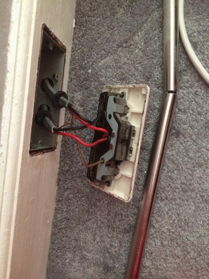

Hi all,
I have a bedroom socket and want to put a socket on other side of wall i.e. out in the hallway.
Can I take a spur off this (see attached)?
Kind regards, Gordon

Yes, in all likelihood.....assuming thats a socket on a ring final circuit, or a radial circuit. You need to confirm that first.
You could make the new socket part of the ring if there's enough slack in one of the cables to get to the new socket.
As Simon says if its the ring then its best to incorporate the new socket into the ring. If there's not enough slack you could extend the cable with something like wago connectors. If you spur from it then you should use a fused spur. Also sleeve those earth wires (untwist too if extending the ring), make sure those rubber grommets are secured on that back box so the cables don't get damaged. Also might want to add a piece of earth wire between the sockets earth terminal and back box earth terminal (assuming it has one).
It would be a good idea to locate it higher up too. When a plug is inserted in a socket that low, it could easily be kicked or bashed with a vacuum cleaner. In your case, the existing socket looks to be so close to the floor that it appears that it would be a tight fit to get a plug with thick cable plugged in. When new houses are constructed, sockets have to be no less than 450mm from the floor, although this may have more to do with accessibility than electrical safety. However, even before the legislation, sockets were usually about 200 to 300mm above the floor for safety.
If you are only adding 1 single or double socket then unfused will be ok. Make sure you use 2.5mm cable though

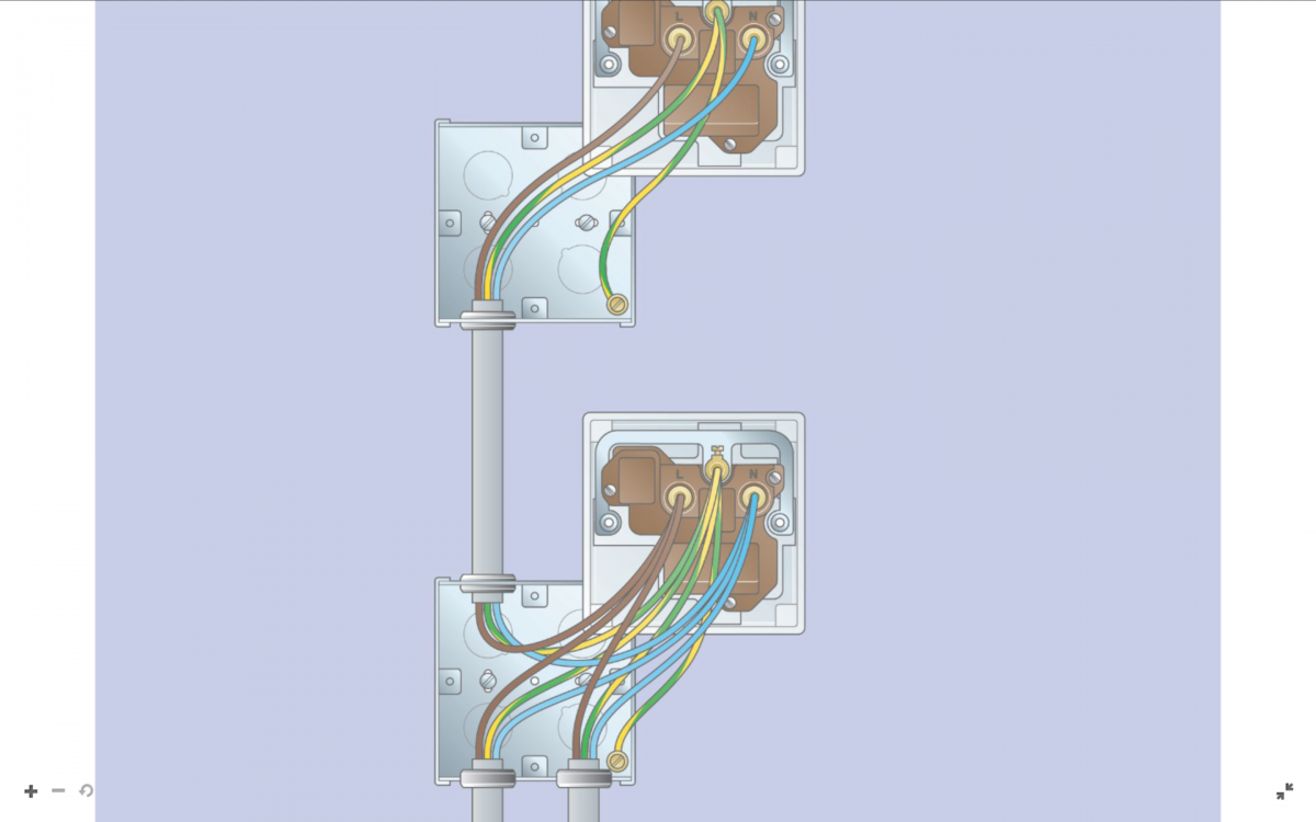

I found the attached image on B&Q. Its exactly my scenario.

If there has ever been an electrical inspection, the paperwork will say what sort of circuits you have.
Otherwise post a photo of the consumer unit. It's easy to tell from looking inside the CU, but we might be able to make a good guess from the outside.
Ring is most likely.

If the socket is protected by a 15/16 or 20 amp fuse or breaker then spur off in 2.5 mm2 cable.
If the socket is protected by a 30/32 amp fuse or breaker it may be a ring. The picture isn't clear enough to tell us the cable size, but 2.5 mm2 or imperial equivalent is likely.
In this case, turn off the power. Check the socket circuit is definitely turned off. Best turn off at the main position. Having established it's dead, remove socket and untwist wires. Then, with a continuity tester, see if there is continuity between L and L, N and N, and E and E. This will give a reasonable indication if the circuit is a ring, and if so, use 2.5 mm2 to spur off this socket.
Use eart sleeving on all bare wires. Avoid twisting wires together.

Its quite a bit before 2004, similar to what sparkright said below.... very eary 1970s or just before.
Its pre metrication. Thats imperial sized cable. So no later than 71/72 ish. The conductors are also not tinned which means its not much before this. The tinning was to stop chemical attack from the insulation from when it was VIR. It carried on a bit after the introduction of PVC in the 1960s, but then was phased out.
No earth sleeving either, the requirement came in the 60s, but sometimes the changes took a while to filter down to those wiring houses.
The box also has two fixing tabs along the top and two at the bottom, to suit some earlier designs of 13A sockets which were around in the 60s
