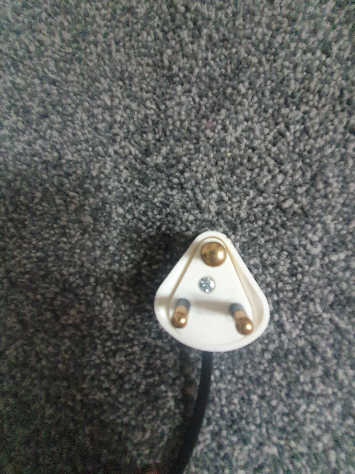

I bought a lamp online, when it arrived it had a three prong circular plug. Possibly an Indian plug? I bought a UK plug and when I went to swap it over there is no green earth wire. Could I use an Indian/UK adapter? The lamp is mostly metal and I have children so I'm concerned about possible shocks from the lamp. I'm not sure an electrician would be able to access the wiring to add an earth cable. Before I buy an new lamp I thought I'd ask, thanks.

Regardless of the rules many items are sold online without BS1363 plugs. Don't know what a "three prong circular plug" is but India uses the old BS546 plugs. Regardless it can easily be changed (don't use an adapter, they are often dangerous). The light may not require an earth if it is double insulated. A double insulated symbol is 2 squares inside each other, does it have this?
Pictures of the plug and lamp would be useful.

Thanks for all the replys. Please see attached a picture of the lamp and a picture of the plug. I bought the lamp from ebay. I already have one which is from IKEA with the correct plug on it. Ikea stopped making them and I wanted another one for the living room so bought it on ebay and it arrived with this plug. Thanks.

That is a BS 546 plug, still OK in the UK, and often fitted for use on special sockets with several wired to one switch/dimmer. Just change the plug. As it is a Ikea light I guess it is double insulated and OK.
I’d change the plug.
Look for the double isolated symbol - a small square within a square.
Obviously this isn’t a guarantee that it is actually safe.

It is common to use BS 546 for lighting so the socket is switched with the light switch and one can't in error plug in a BS 1363 plug, there is nothing to stop you swapping to BS 1363 the main point in UK is the line and neutral must not be able to be reversed as we only have a fuse in the line, and the MCB in the CU (consumer unit) is much larger than in the EU so German sockets which can be reversed are not permitted.
But that plug is of British design so no real problem. The Electrical Equipment (Safety) Regulations 2016 have been altered and come into force in full next year, in the main it is because no longer in the EU, so UKCA marking now required, but the result of it means hard to be sure if BS 546 is still allowed, as so much seems to be hinged around new markings.

Since you have the same model of light which came from Ikea with a BS 1363 plug, I suggest that you check whether that lamp does (or does not) have an Earth wire connected to the Earth pin from the (metal) body of the lamp.
If it does have such an Earth connection, you should provide the same level of protection, by rewiring the lamp with a flexible cable containing an Earth wire to a BS 1363 plug.
