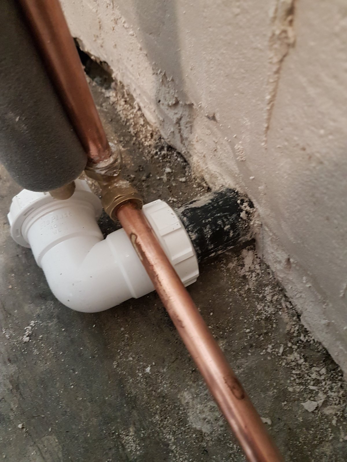

This 40mm Floplast pipe is for compression fittings, but am I able to use it with solvent fittings too?

I was using compression fittings, but where the pipe fits to the outlet through the wall it's very tight and im not convinced a compression fittings will hold, so want to use solvent fitting on this bit.

I can use the 40mm weld pipe with compression fittings tgiuft, i.e .bath trap etc? Will all be same brand (Floplast).
Failing that, any suggestions about using compression fittings on this outlet and achieving a tight seal?
Compression fittings will work with any type of material, including the various types of plastic. Solvent welding will only work with ABS and PVC plastics. Compression waste pipe may well be polypropylene, a different type of plastic that will not solvent weld. You need to ascertain what type of plastic that pipe is coming through the wall, or alternatively, replace it with new pipe that can be glued.

If that outlet pipe is not solvent friendly and I can't get a decent deal with a compression fitting, whats my best option? Liberal use of ptfe tape and plumbers mate?

Not required. Compression is fine.
Just about every house in the UK has at least two waste compression joints, on the outlets of the sink and basin traps.
Solvent weld pipe and push fit pipe are slightly different diameters. If a solvent weld fitting is a nice snug fit onto your pipe, it will be fine to solvent weld. If its a loose wobbly fit, then you have polypropylene pipe designed for push fit fittings. Compression fittings will do both types of pipe.
If you can't see the pipe type written on the pipe just try cutting a little off the end...pvc and abs will let you cut off clean shavings...PP will feel waxy and won't give a clean cut.
