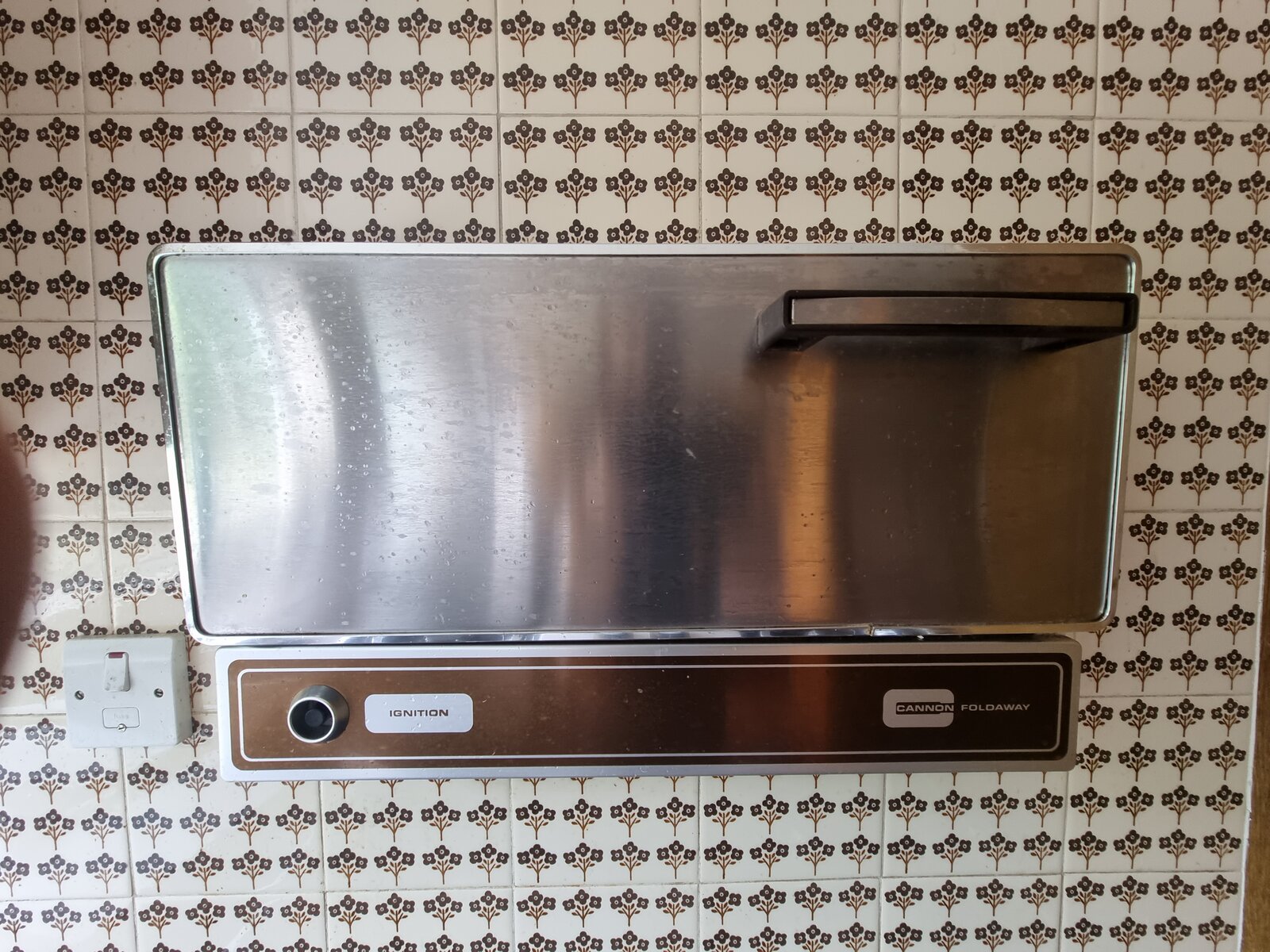

Hi all, I recently became a new proud owner of a Cannon Foldaway grill. it is in good working condition but on my second use of the grill, I have problem trying to shut or 'fold' it away, the top grill bit wouldn't fold down. I would be devastated if I have broken it! I would be most grateful if someone can point out to me which is the mechanism that pushes the grill down so that I can attempt to fix it. thank you in advance
Hi, Malvern,
To close the grill, move the gas lever to the off position and push and hold it to the right.
Lift the handle of the lower part (front) and the fret (top part) should drop under it's own weight. Hey presto- closed!
Regards, Robin
P.S does anyone have a plate rack for the top as mine never came with one?
Thank you Robin! You are a lifesaver.
Sorry I haven't got a plate rack either. If I come across any i will post a link here. Have a lovely day xxx

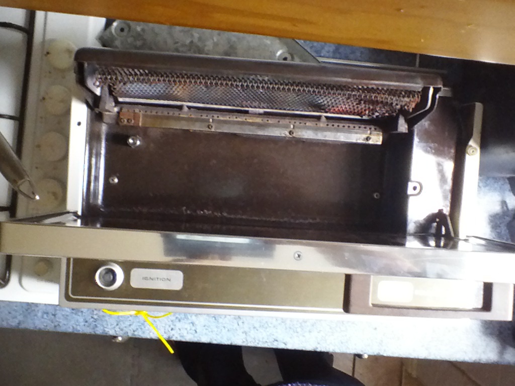

Hi everyone, I've just removed a Cannon WG3 as the grill mesh is damaged and burning unevenly, and I can't find a replacement for the grill mesh. Does anyone want it for spares or repair ? No spit or grill pan with it and collect if possible from Liverpool.this is a wall mounted folding grill,it was working before it's removal.
Not the best pictures but I'm no photography expert.​

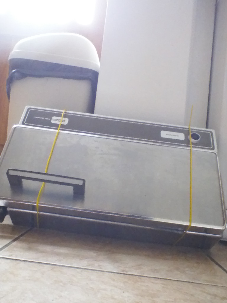

Just took this one out of a job along with a cannon sp2 hob if anyone's building a retro kitchen, there's no grill pan with the
