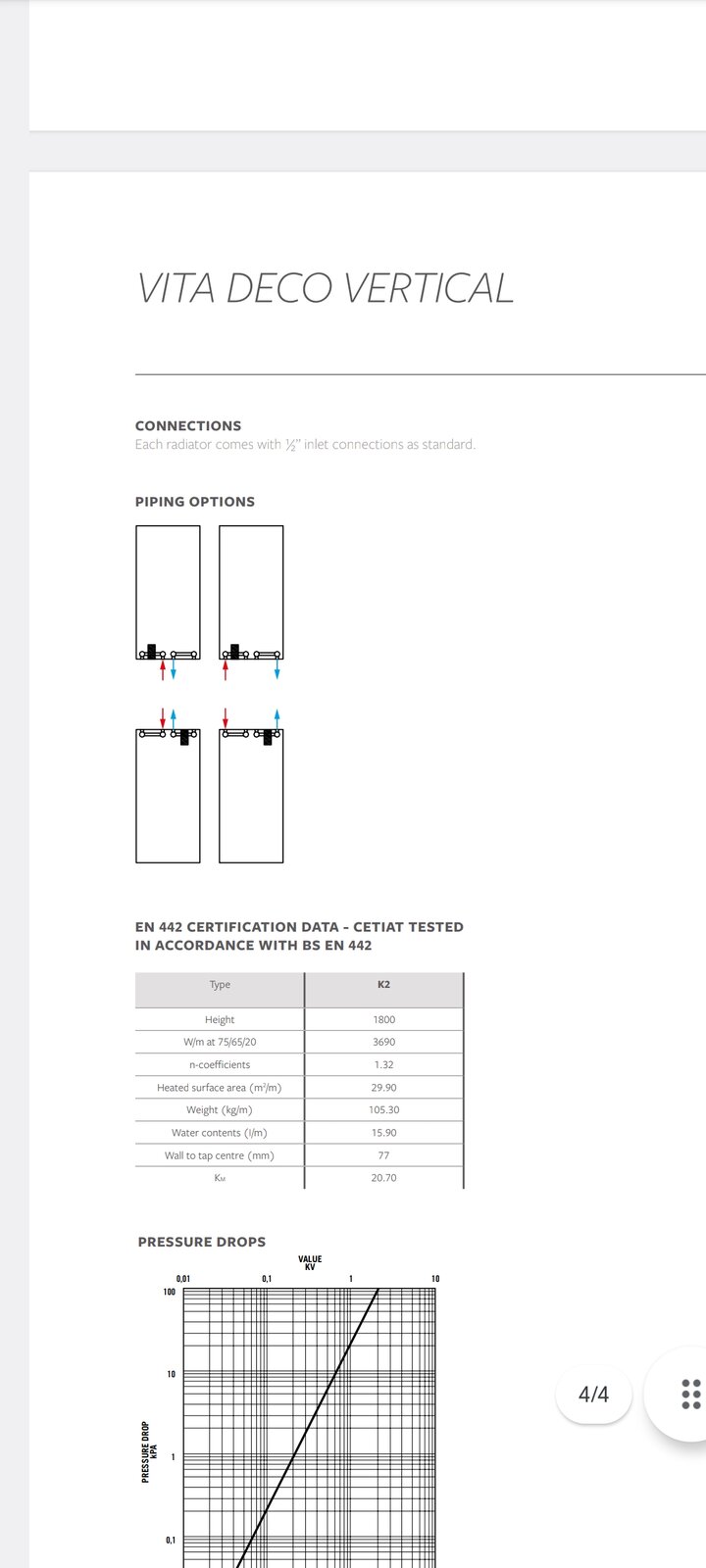

STELRAD Vita Deco and a fair few others allow top entry.
Care needs to be taken to ensure both pipes can be vented

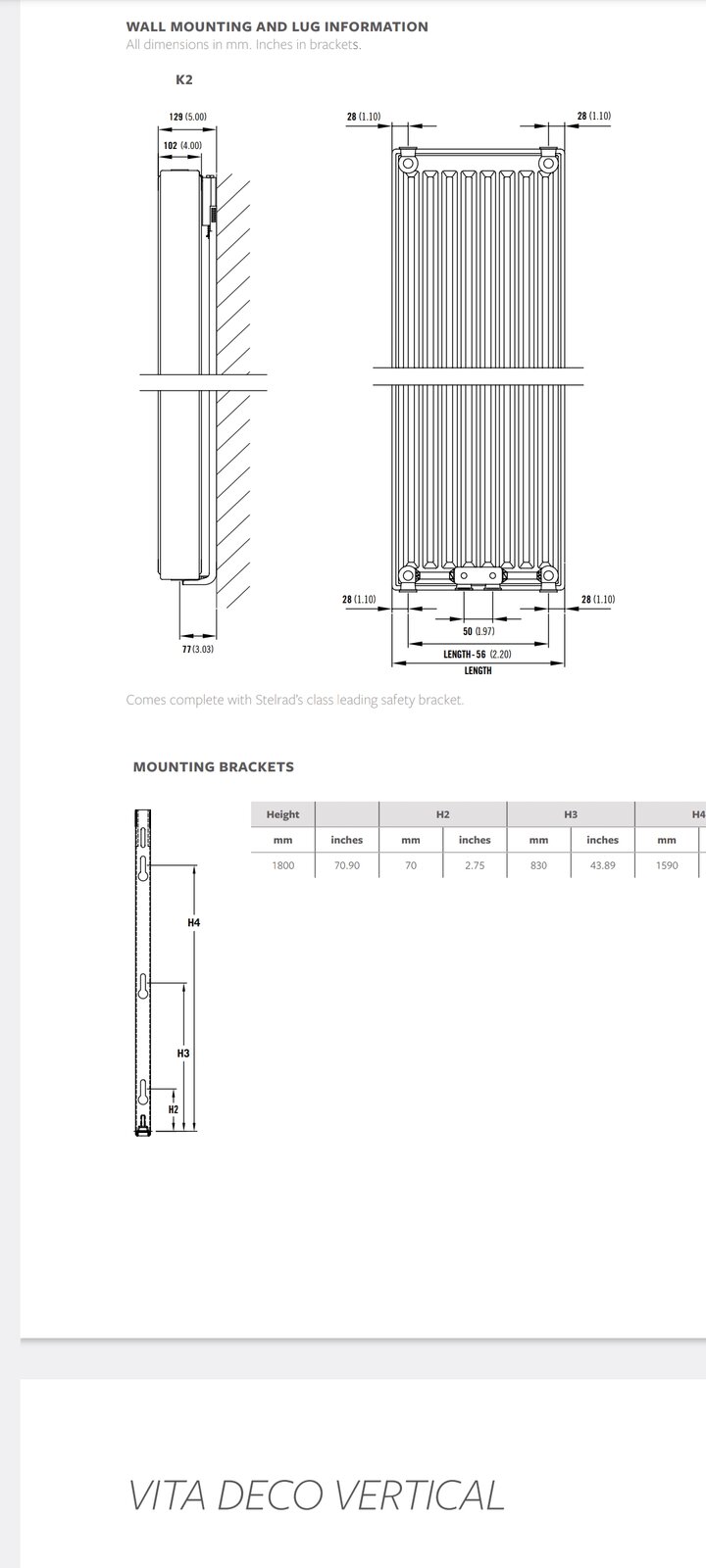

I asked them about the option of top connections. I don't know whether the water is actually routed to the bottom internally, I suspect not. Also I pointed out that a TRV mounted at the top would get warm and cut off almost immediately due to the rising heat from the rad. They didn't argue, and didn't seem to offer any explanation of how it's supposed to work. Unless I'm missing something I don't get how this would work.
I'm planning to use their radiators, but using the centre connections at the bottom with the pipes behind the rad.

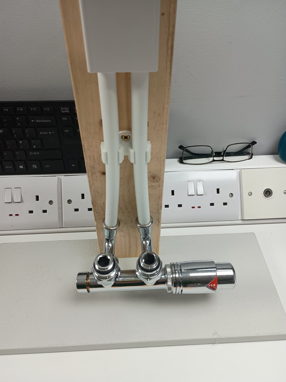

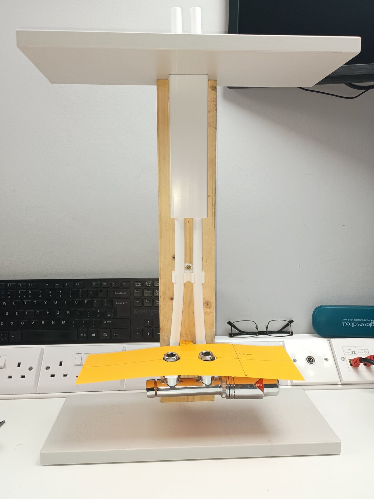

My mockup of my plans. I'm waiting to find a plumber who says whether this can or can't be done!...
I've just used plastic pipes for my mockup, in reality it would be copper. The elbows are press-fit, as they are the only ones I could find that give sufficient reach, and they look neater than compression.
The clips and trunking aren't the standard Talon stuff you get at every supplier, they're too tall to fit behind a Stelrad radiator. They're some other brand that's really hard to find. I'll try to remember whose they are. The trunking clips onto the brackets, it won't fit behind the rad so it would need a trimmed length a short distance from the top of the rad to the ceiling.
I can't see why this wouldn't work, and it would be vastly neater than the standard way of having pipes banged along the top of the skirting boards and up the corner of the room.

Not sure what your yellow sheet is @Ivor Windybottom? You can't cover the TRV of course.
The orange sheet is the thickness of a Stelrad tall double radiator. The jutting out extra bit is the spacing from the wall. The TRV is under the rad. Not ideal, but vastly preferable to it being above, even if off to one side.
Also, as I've already stated, the TRV will just shut off if it's fitted above, as it will be about 30 degrees as soon as the rad gets warm.
To use top entry you flip the rad and effectively fir upside down, the internal flow pipe injects the water to the bottom as it would to the top in a normal install.
If I was installing with top entry I would use remote sensing TRV's or left and right tapings with the head turned out from the rad.
If you are using Vita Decos, what the point of the trunking, its all behind the radiator. Just clip 15mm copper to the wall and use corner entry rad valves ignore the centre valves, especially if you have lots to do ££££
The trunking is just for the short section between the top of the rad and the ceiling. Otherwise just the clips that the trunking normally clips onto. Exactly as shown by my model in fact! Obviously it's not as tall as an actual room, but illustrates the top and bottom minus the featureless middle.
Please explain how you think you'd pipe to the side valves. You'd need pipes spewing out from underneath somehow, and going upwards into the valves. I can't imagine a way it wouldn't look a right mess. The centre valve connects pretty much directly to the pair of pipes running down the centre. Although not ideal, the air should be drawn in from the room before rising up within/behind the rad, so the TRV should be mostly sensing the room temperature rather than the red temperature.
