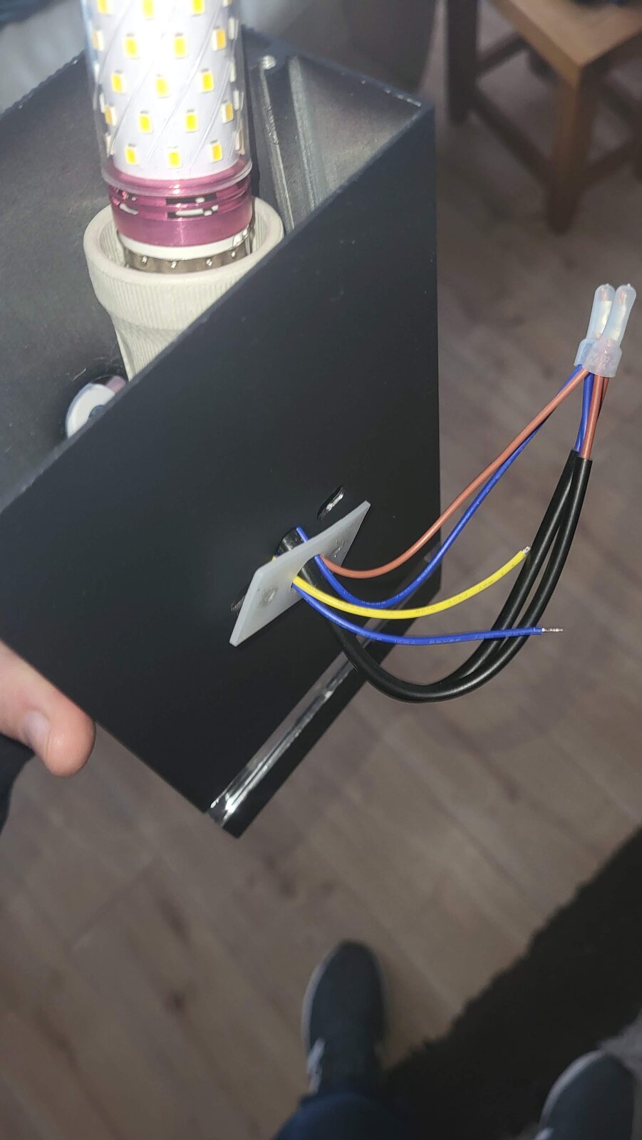

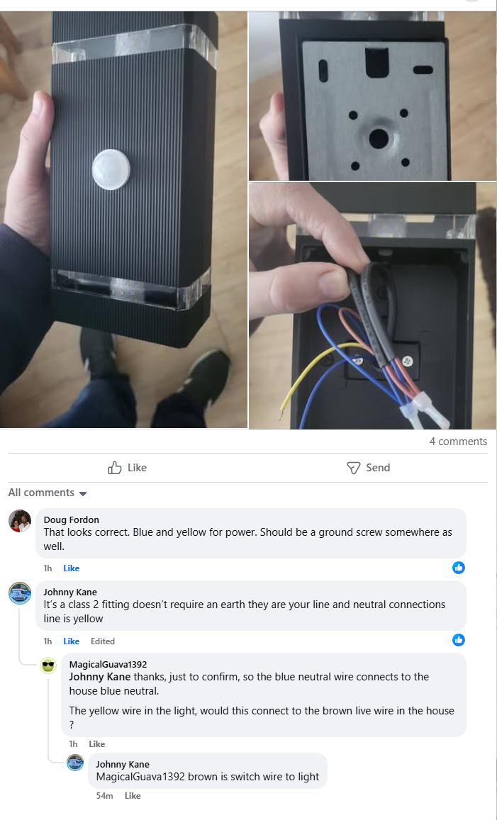

Can someone give me advise how to wire this outdoor sensor light up?
11 Jan 2026
7
Can someone give me advise how to wire this outdoor sensor light up?​
The yellow and blue wire is only free.
The other brown and blue wires are crimped together, does the house brown wire need to be connected to this brown lot?
I don't have the instruction leaflet with the light, was got of ebay uk, new last year.
The seller is saying the blue and yellow wire are both live, but im not confident about this.
See images
Questions:
The blue neutral wire on the light, does this connects to the blue wire in the house ?
The yellow wire, does this connect to the brown live wire in the house ?
The current earth wire in the house, does this need to be used or just wago it ?
Thanks in advance !

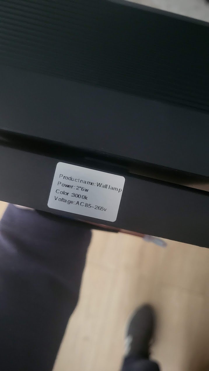

on the side it shows AC 85-265v
On a facebook group i posted, they said its a class 2 fitting.

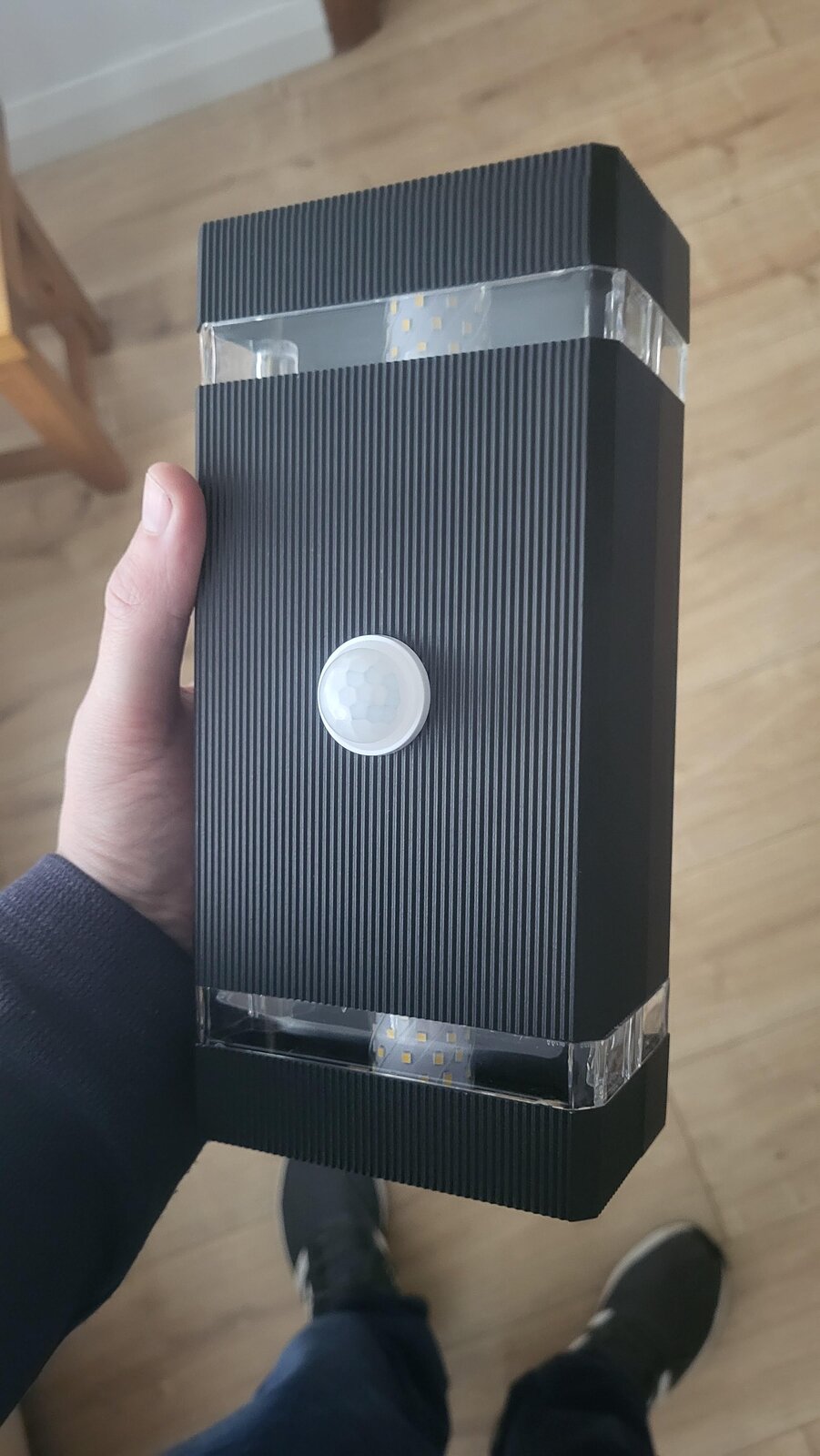

The third photo shows an Earth symbol to the left of the screws, who said it was Class 2?

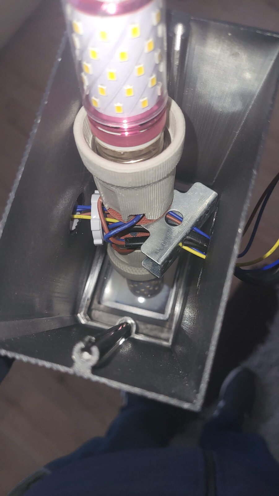

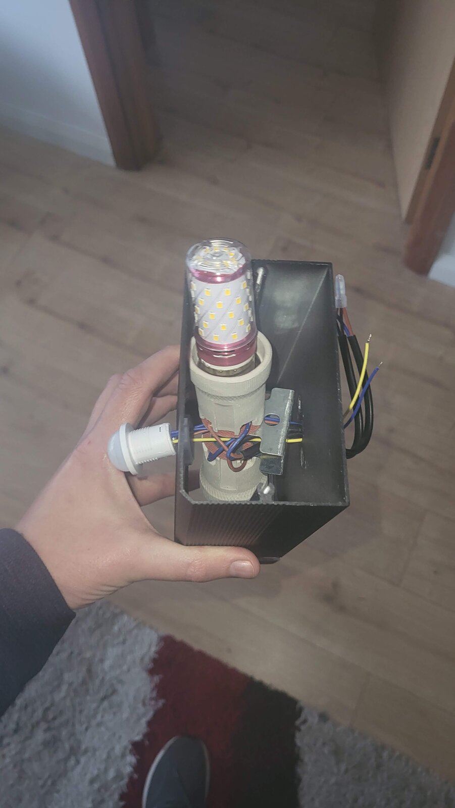

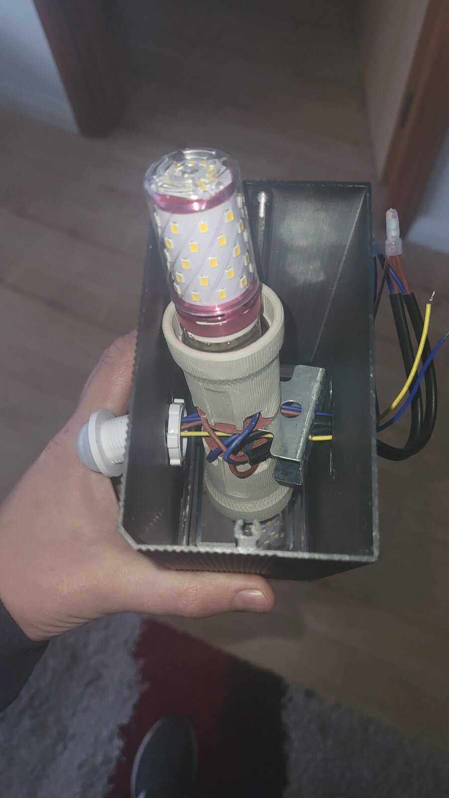

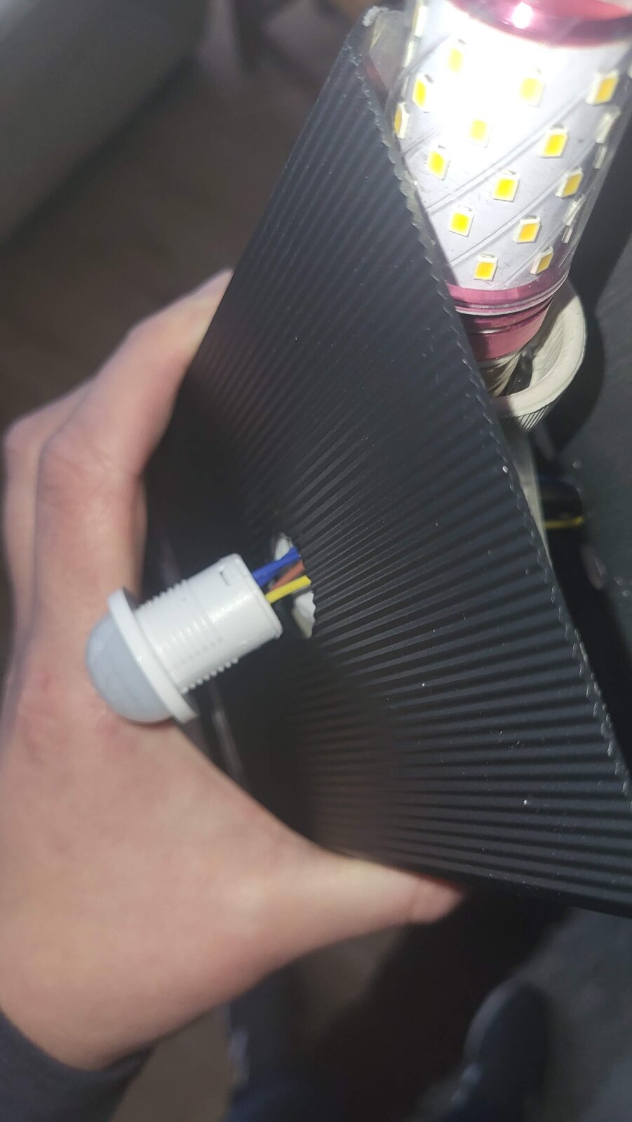

I took a fair bit of it apart, the blue and yellow wires go to the sensor at the front. (2 bulbs either end, the main fitting in the middle.
The outer casing is all metal.
see pictures
It looks like the yellow is the live but...
I don't like the way the single insulated wires are going through the metal, if you wanted to use it youd have to earth all the metal parts.

just outa interested, i wired the yellow wire to a brown live wire on a normal 13a plug, blue to blue, didn't work when it was in the casing.
However, i ended up taking it out of the outer casing unit completely, and connected all up the same way and works fine, so something must of have been shortening on the case itself.
will try putting it all back in the case and see if it works then.
