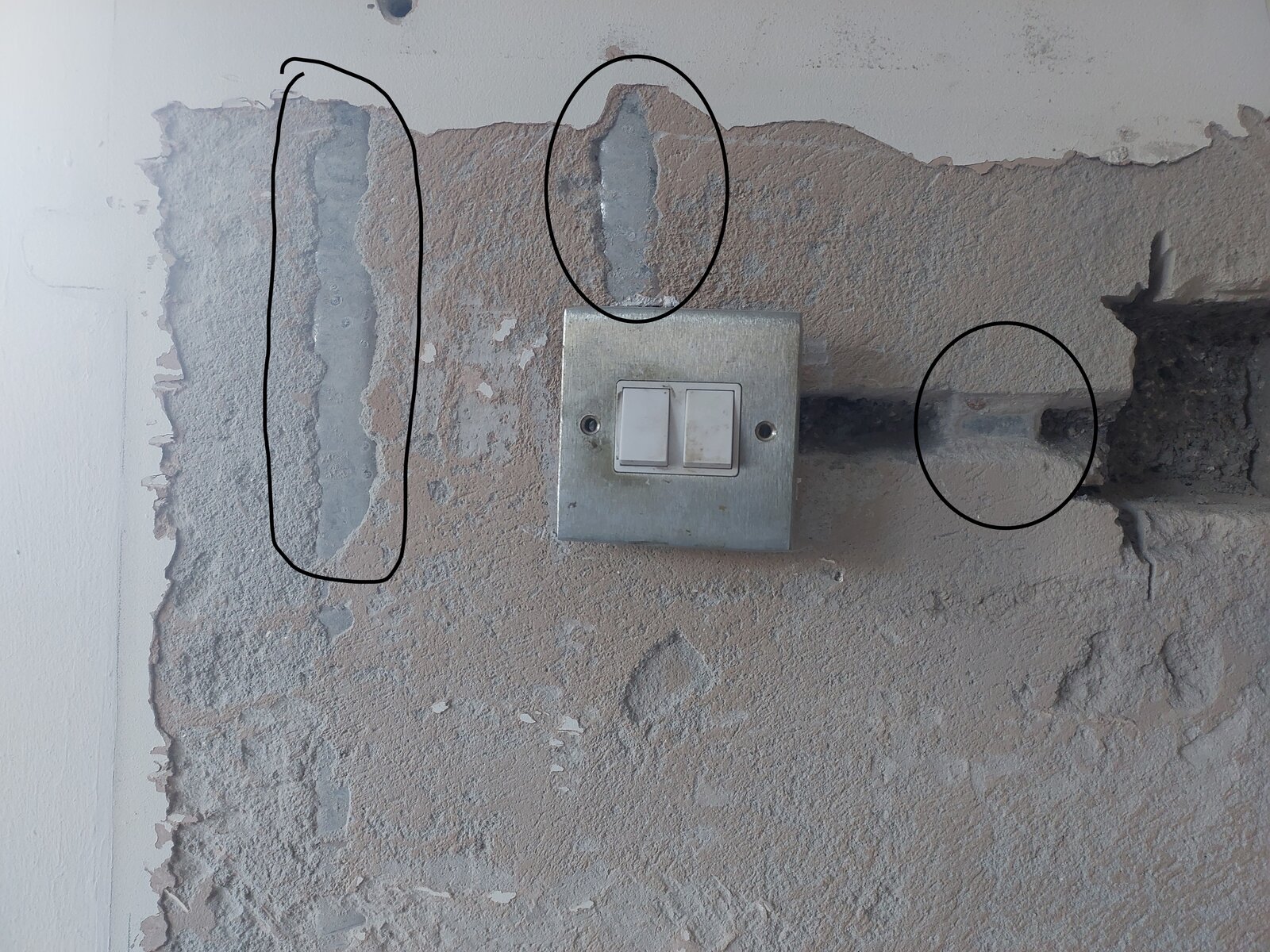

Can someone please advise what are these in the wall? (GALV. CAPPING?)
11 Jul 2018
48
Hi,
I am moving switch (as shown in the picture) from left to right. As I was chasing the wall I have found these metal plates which looks like capping. But not 100% what it is. The middle one does looks like metail cap for cabels but the one in the left and one in the right doesnt have any sockets, switch or lights around it. So not sure what it is. Just to notice that on the right metail thing, its also got what looks like a screw. So not sure what its for.
The wall is an external one.
The problem is that I need to install new switch in the right but I am now facing dilema with how to run the cable with that metail thing in the middle.
Any help is much appricated.

You can’t move that switch to the right as the existing cable from the ceiling will no longer be in a safe zone.

It's not impossible to move the switch to the right. We would need a bit more info. For instance, would a blanking plate be acceptable where the old switch is? Or can the whole cable drop be re-routed so it goes along to the right within 150mm from the ceiling, then directly down to the new switch position.

Out of interest, is this a kitchen?
They do look like galv cappings - if you chip a bit more out to the sides you should see where the metal edges fold over against the blockwork - to show the 'top hat' profile that capping has.
Where you can't see any electrical accessories, it's possible capping has been used for some other reason. It's not out of the question that capping has been used for some other reason, such as protection for micro-bore central heating pipes, or something out of the ordinary like that.
If this is a kitchen, could there have been sockets lower down somewhere?
In answer to the other question, to run a cable past these galvanised cappings, you would simply notch into the blockwork behind them, and run the cable behind.
