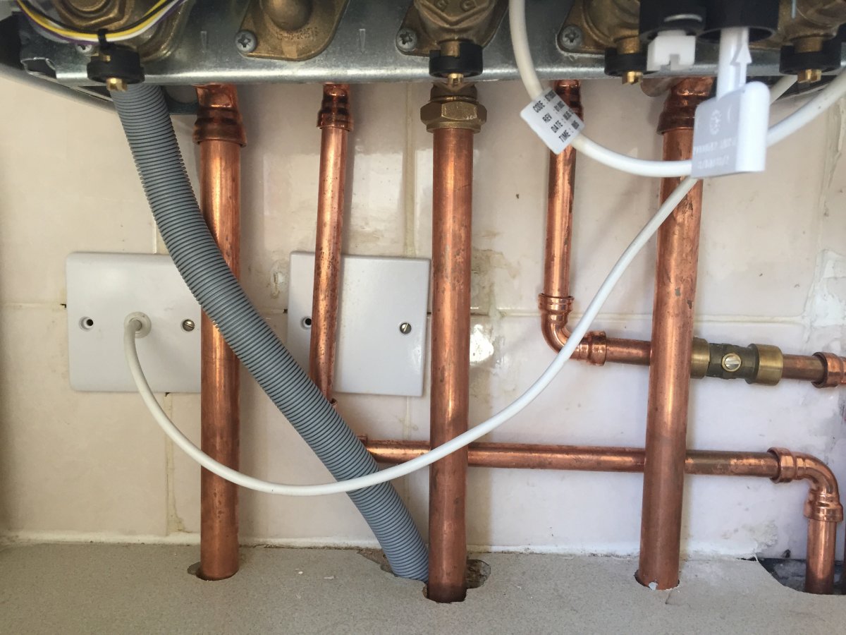

Can these pipes be moved back?
No idea where that grey pipe goes tbh
You should probably try to find out. It ought to be connected to your drains, and maybe it is. If it just disappears behind the units or into the wall cavity, that needs fixing.
I'm also curious about where the pressure relief valve vents to. I'm not familiar with this boiler; is it the white plastic thing I can see in some of your photos, towards the right of the bottom of the boiler? Does it go through the wall?
The white plastic thing doesn't go anywhere- it's a key which allows you to control the pressure from what I gather. Is that what you are talking about? Sorry if not, couldn't really see what else you meant
On your outside wall, we've seen photos of the flue and of where the gas pipe goes through the wall, a few feet below. Between the two, level with the bottom of the boiler, is there another pipe that vents through the wall?
That grey flexible pipe that you can see- that goes into the wall. Doesn't seem to come out anywhere though... Just goes into the cavity of the wall
And now I look at it the clown has only used 1 screw on each side of the electrical boxes...

Sorry to make this my first post, I usually just read, however this install needs a response, which is Wow just Wow!! Where is the pressure relief?
Am actually bit freaked out- the pressure has dropped to 0 in the boiler. So I turned the lever on boiler to get pressure back up. Is this normal?
Am going to go get a carbon monoxide alarm as well. Missus is pregnant so can't be taking any risks.
Maybe someone who is actually familiar with this model of boiler can comment, but....
I think that the pressure relief outlet is just to the left of the right-most copper pipe coming out of the bottom of the boiler. In the photo I can see something metal that points backwards towards the tiles. Does that actually go through a hole in the tiles and appear outside? Or is it just left pointing at the tiles?
It is pointing at the tiles...
